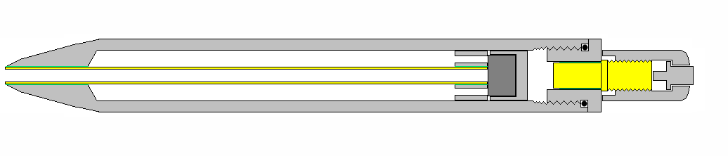

I suggest this design for a lot of fun ;-)
It is breach loading, so convenient for reloading and maintenance
You can use a cheap taper tap as previously discussed to thread the hole.
You should use a brass plain rod of the proper size and just drill it (keeping enough meat for the thread in the wall thickness). You'll learn how to deep drill and keep a smooth surface. Brass is the easiest material I know to machine. Aluminum is a female doggy in comparison. Also, you don't need fluid cutting with brass, less mess...
There's only simple operations on the lathe, a mill is not needed.

That's a lot of reading I have to do :D
LeMaudit, much better than my design! I especially like the 2 part cap.
Would it be easy to make a thread to match the schrader? Or am I better off buying an alloy tyre cap and machining it down?

I believe schraders have 7.7 mm metric threads, and that's not a common tap size. I would go for a machined cap epoxied in place.

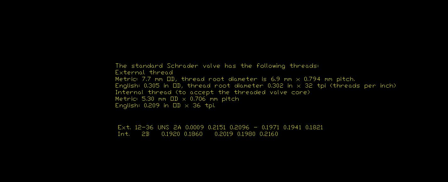

Yes, 7.7mm is uncommon, it is in fact SAE 32 NF thread.
I checked with my thread gauge, and it's referenced here:
http://en.wikipedia.org/wiki/Schrader_valve
32 NF is common, but not really in 0.305" 0D.
In this diameter, it would be difficult to make a inside thread, as you would barely have the place to insert a thread cutter. Maybe you could by grinding a miniature one out of a HSS square bar.
The best way yes would be to reuse the thread from an existing brass cap, cut it's top (on the lathe!) and glue it inside a niceeeeeee shiny custom made cap.
[edit] after a quick look on the web it seems this schrader thread is really an oddball. People have difficulties finding taps for them, the best I could find is custom order here : http://www.e-taps.com/products.htm
Definitely a good idea to reuse the thread from a valve cap :-D
