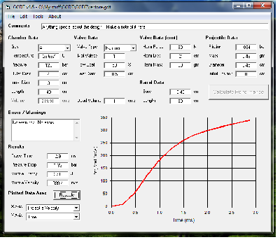

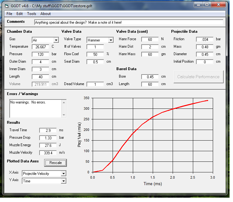

I´m designing my pcp(4.5mm), and I have almost everything decided, but I don´t know that to put in the valve flow coefficient
GGDT/HGDT Request Thread
- wyz2285
- First Sergeant 2
- Posts: 2390
- Location: Porto, Portugal
- Has thanked: 1 time
- Been thanked: 4 times
Hi, didn´t read all the posts, so if my is wrong please remove it.
I read about it and I understand what it means, but how can I figure out that´s my valves flow coefficient?
