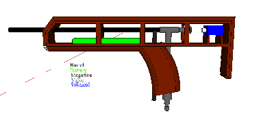

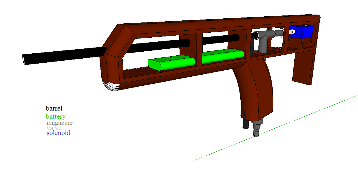

Here is also a quick sketch (google sketchup
, and the hammer size is wrong btw) of the basic gun design just for testing, a better stock will be used later.
this one then, I bought it there.
