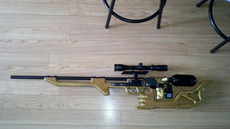

I installed a diaphragm spring and that cured my valve issue. So, all is good.
The last minor bug to cure is the battery power. At 24 volts, the valve will not open above 550 psi. So, I will go to a 36 volt lithium pack. That should give it the power to open at 800 psi.
Anyway, this thing is quite shocking even at 500 psi. It is freaking LOUD and really packs a punch.
I am thrilled with how it turned out.

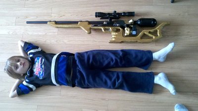

Here is a picture of the gun next to my 8 year old son for scale. It is a touch over 50 inches long and weighs a hair under 14 pounds.

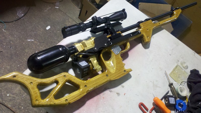

The tank is MIG welded steel. The front and rear hemispheres are .120" thick as is the DOM (drawn over mandrel) tubing for the center of the tank. The front hemisphere was spun on the lathe to open up the front hole. Then the short steel pipe was chucked into the lathe and machined to literally snap onto the hemisphere. Once snapped together, the output pipe and hemisphere were welded from the inside, then the outside. Then the inside weld was ground to give a smotth transition for the air to exit the tank. The next step was to weld the entire tank together. Once welded together, the tank was pressurized and submerged to look for leaks (there is always one or two leaks in every tank I have ever welded). The leaks are found and drilled out. I have found it is FAR better to drill out a pinhole leak and weld the hole shut, than to surface weld the tank. After welding, the tank is repressurized to assure no leaks. Lastly, the tank was powder-coated flat black.
I still need to hydro test it. But, I have hydro tested tanks far larger than this with the same wall thickness to well over 600 psi without a problem. So, I am fine with this tank. However, once I get to the point of putting 800 psi into it, I want to make sure I test the tank and the valve to at least 1,200 psi to make sure everything will hold together.
It is wild working with HPA. Things that you take for granted with low pressure guns become an issue. For instance, the quick disconnects are more difficult to release up at 500+ psi that would normally release very easily at 100 psi........

I contemplated breach loading for obvious reasons. But, when all is said and done, I wanted to eliminate the complexity and possible air leaks from breach loading. I also wanted to maximize barrel length and minimize dead space (as you mentioned). Beyond all that, this was supposed to be a quick build. I had a target date to finish it. This limited my options for loading and for the trigger, hense the simple button trigger. Actually, the trigger feels very natural and correct. The grip to trigger distance feels spot-on.
Lastly, there is a certain element of "Theater" involved with muzzle loading. You set the gun on the rack, grab a steel ball, wrap it in some fabric wadding, stick it in the barrel, ram it all the way down...... Then there is the airing up; I attach the line and hit the compressor, I begin calling out "100 psi, 200 psi, 300, 400, 500, 600........). After that, I shut off a ball valve near the disconnect to reduce the line pressure blast. I pop the line off the gun and it is ready to fire. There are many steps involved. However, these steps actually go pretty quickly. I can refire this thing faster than my buddy can refire his muzzle loading hunting rifle. That being said, there is an anticipation involved in the reloading process of one of these guns. That is part of the fun, if you ask me. That is one reason I wanted to buld my own compressor from scratch as well. I was able to setup everything up exactly the way I want it.
