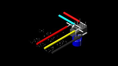

Use the 3 Volt relay and it will be much easier to incorporate and have less components involved.
I will redo the schematic for you with that relay.

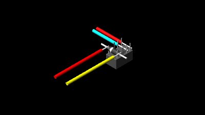

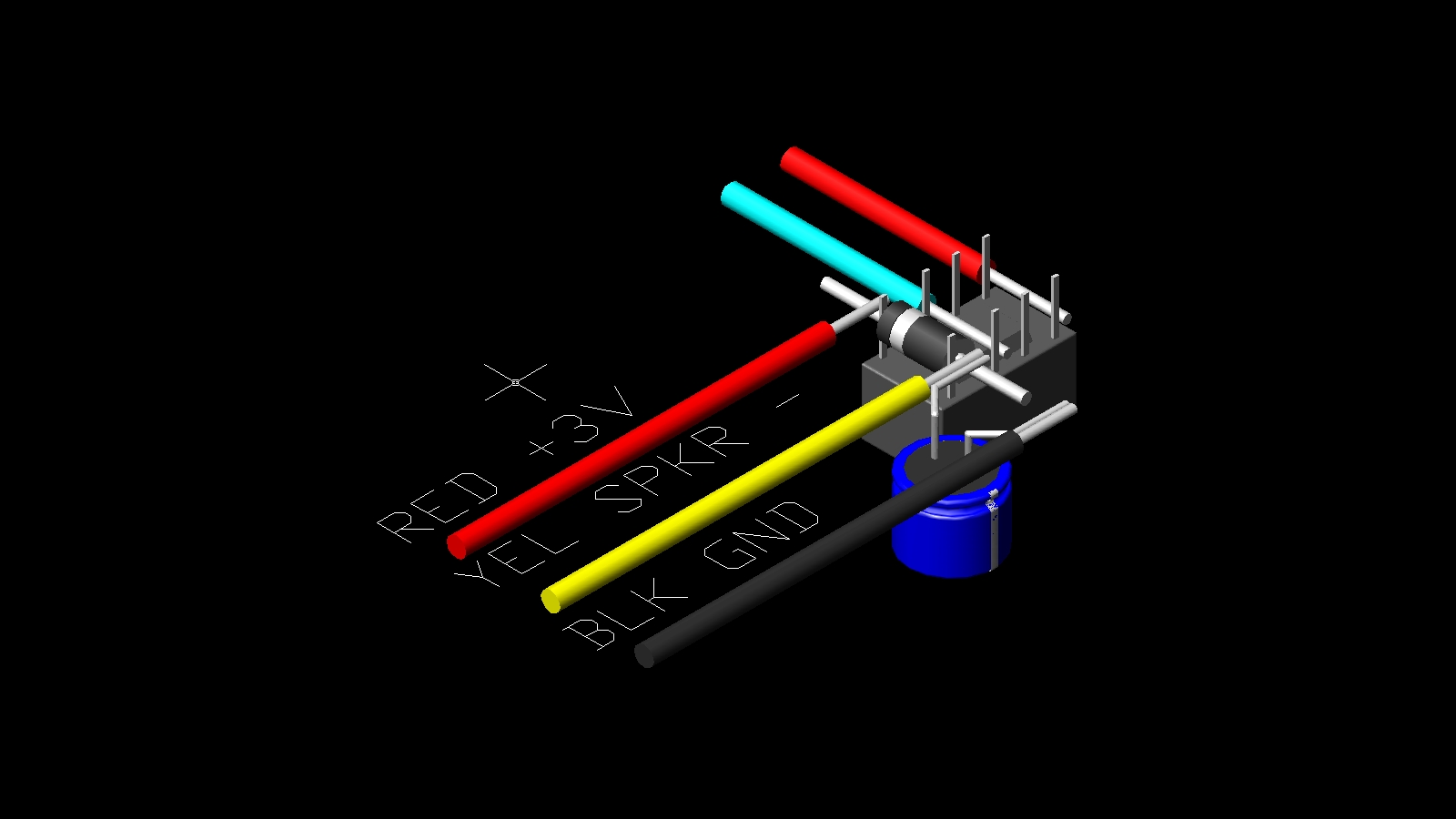

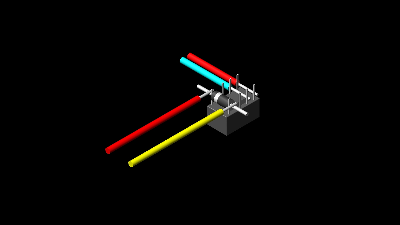

Because the leads on the relay are so fragile I will also post an image of how to wire so there is less possibility of damage.
You could use double sided foam tape to mount the relay inside the box.
Once everything is working you can use hot glue on the leads and relay pins to the relay body to prevent the relay pins from breaking.

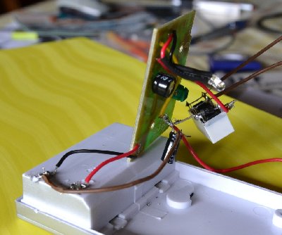

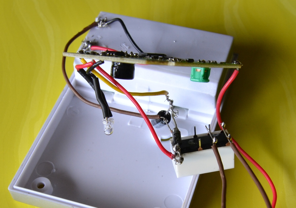

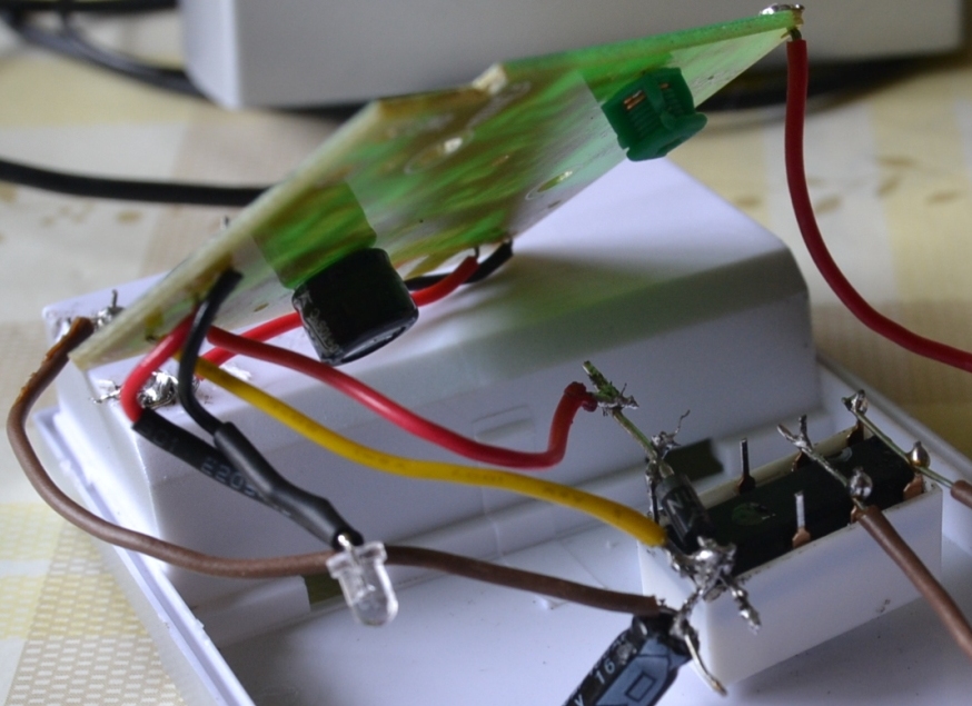

One question: what´s the wire connected to the negative of the capacitor? Battery negative?
Also I was planing fill the box with foam, is it a good idea?
You have it wired wrong! Recheck it versus schematic and pictorial I did.

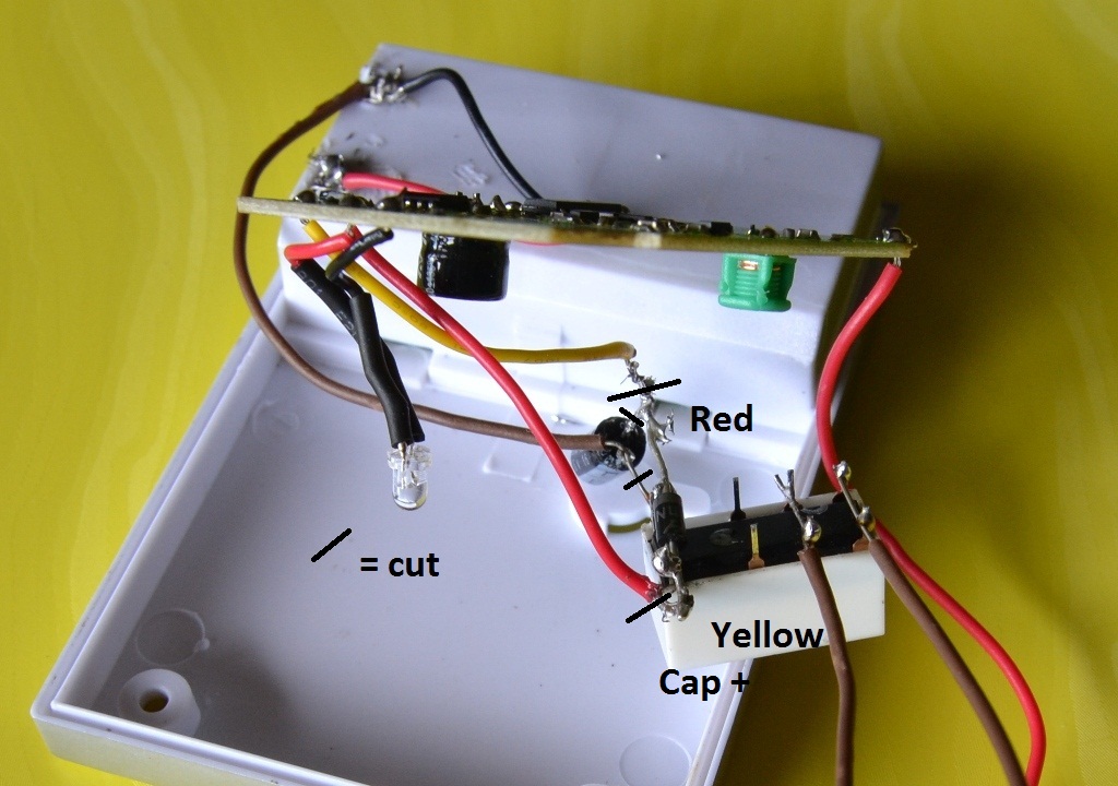

Actually you have several errors. Give me a little time to edit one of your pictures to show how to correct.
Cut the Red and Yellow wire as shown. Cut the capacitor minus lead going to diode and capacitor +. The capacitor minus should only be going to the Black lead which is ground. The capacitor + lead should go to the Yellow lead connection.
Wire the Red lead to the diode white band and the Yellow lead to the other side of diode.
Edit relay pictorial Blue wire to pins 4 & 13 (wiper) instead of pins 8 & 9 (NO)

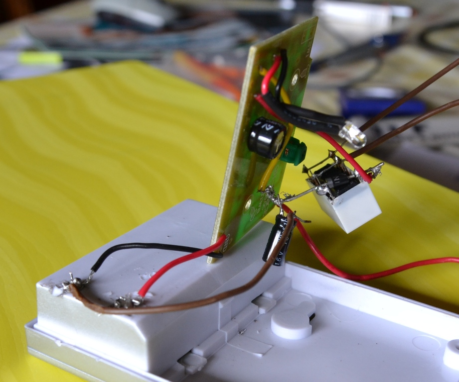

Do you have a voltmeter? I don't have time to double check the wiring for you but if you have a voltmeter you can at least determine where the problem is. Is there sufficient battery power being supplied to the circuit? Is this power then sent through the 'speaker' wires when the doorbell is activated? Does this power reach the relay? Does the relay switch at all (you should be able to hear a click)? Are the NC contacts on the relay working properly in the default position (when the doorbell hasn't been activated)?
I had a brief problem where the diagram for a relay was wrong as it has mislabelled the contacts. Terminal 2 and 3 should've been NC with terminals 3 and 4 NO meaning I would wire the stungun through terminal 3 and 4 but instead it turned out I had to wire it through terminal 2 and 4 (which is counter-intuitive).
wyz;
Do not worry about the stun gun working yet.
As MrC stated, you should hear the relay clicking when the remote is actuated.
If not put the speaker back in to check if doorbell circuit still works. (without the relay/cap circuit)
You have been lucky so far that Q5 has not blown, but all these wiring errors may have finally damaged it.
Once you get the relay switching on and off then wire it up to the stungun.

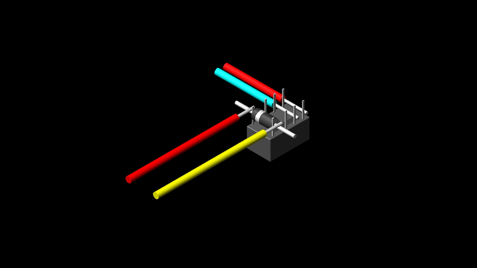

The pictorial I did for MrC was wrong originally. The schematics were correct.
Here is the updated pictorial.
