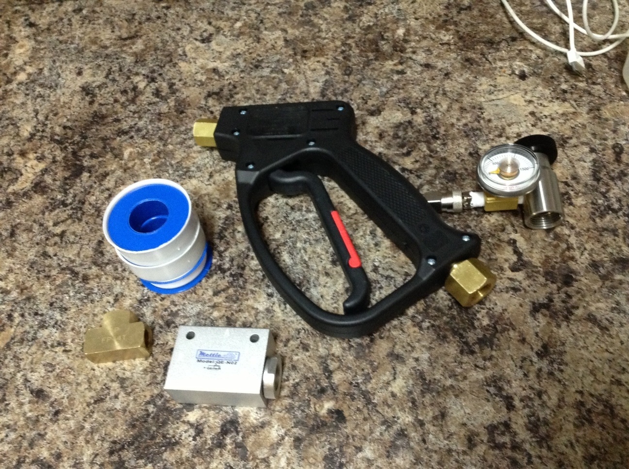

The parts are shiny
Decide on a feeding system yet?

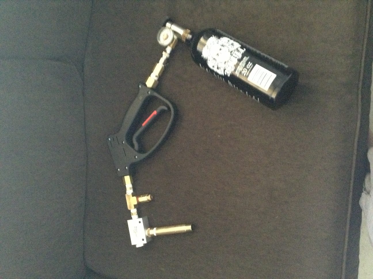

I am very willing! I was already planning on it actually , just not now , i will do a yourube video piece by piece with everybit of information! Here is an update of a few more pieces that came in today although some had issues fiting together ... So far im missing a 1/4 inch 45 degree angle elbow , a 3/8 in end cap , a needle valve , a remote line and a barrel setup i will do later
wish me luck guys this is like a 200$ project for me and im only 14
