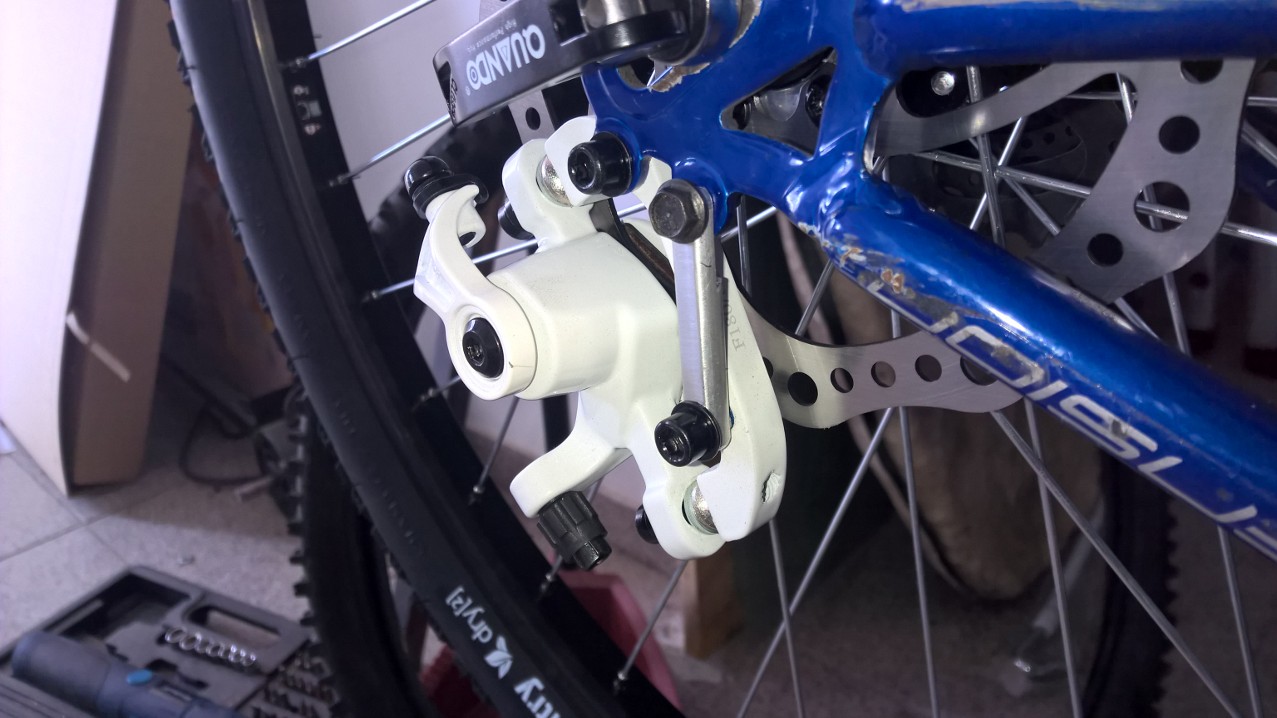

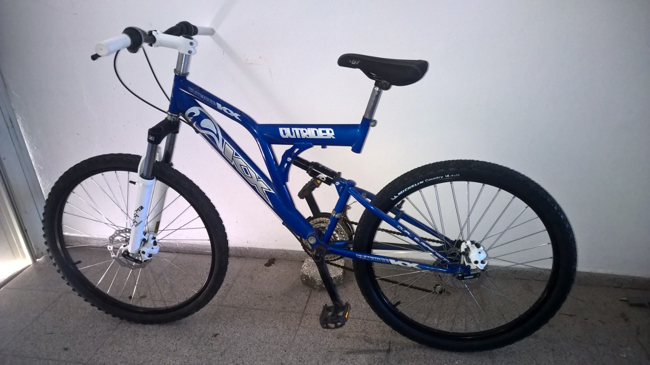

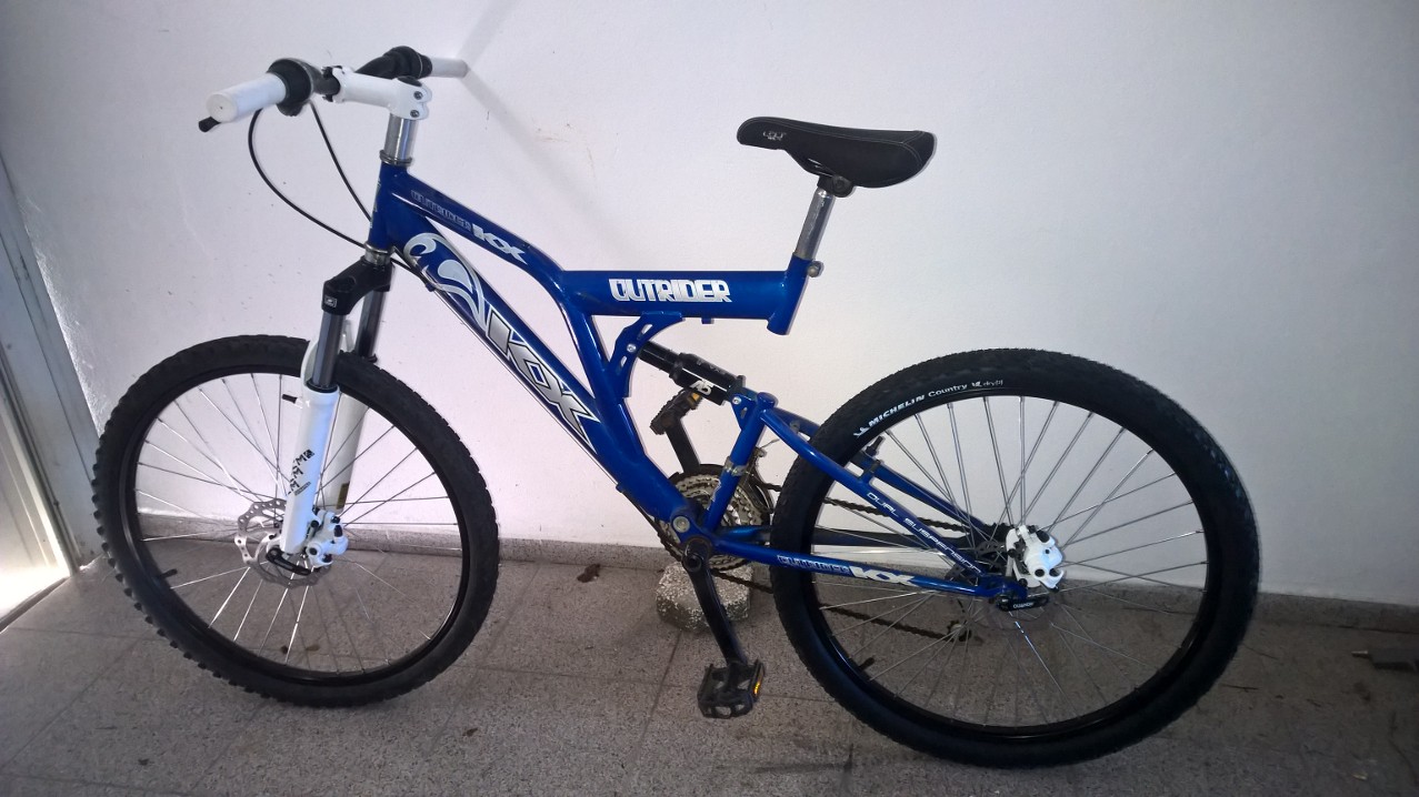

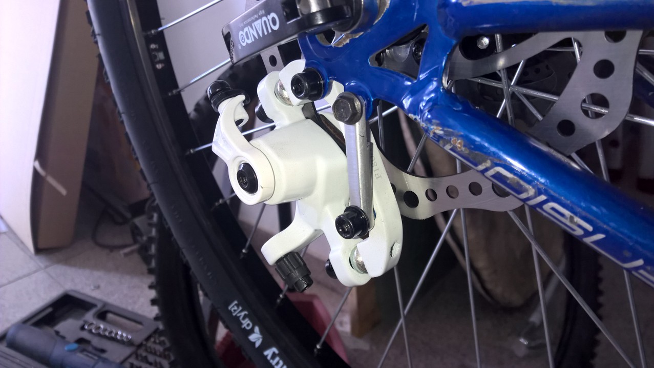

Spent the last few days restoring my first bicycle my parents bought me. Almost done and rest of the parts I need will be delivered tomorrow. All the upgrades are a bit overkill for a steel frame but the initial idea was to keep the bike running for sentimental values.
Had to machine some spacers to install the front suspension and rear disc brake because the original frame does not accept standard mountain bike suspension and disc brakes.

Got a close up of that rear disc mount? And I'm guessing you had to get a disc compatible rear wheel (hub)?
I always wanted to build a cool steel framed city beater bike - they're pretty common now but weren't always haha.

Got a new pair of wheels, the old ones are bent and since I need disc compatible wheels I just got them all together.
Got lucky with the rear, I thought I would need machine a entire structure but instead I only needed to machine a bar.
The steel frame is a bit heavy for long rides or climbing but a side from that nothing wrong with it.
