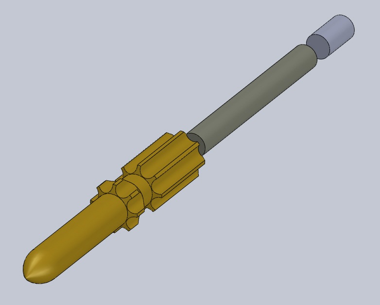

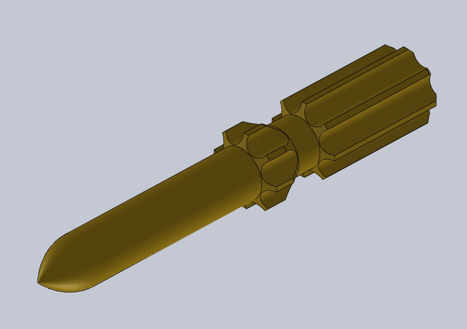

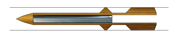

Here's what I have in mind for the dart, 8mm body diameter and six fins.
Petitlu
Posts: 807
Joined: Fri Jun 03, 2011 4:52 am
very nice!
complex to do ... the fins are made ​​separately and glued?
No, all from one solid piece of brass.
Not that complex to do.
Petitlu
Posts: 807
ok brass, delrin I thought ...
fins are not high ...

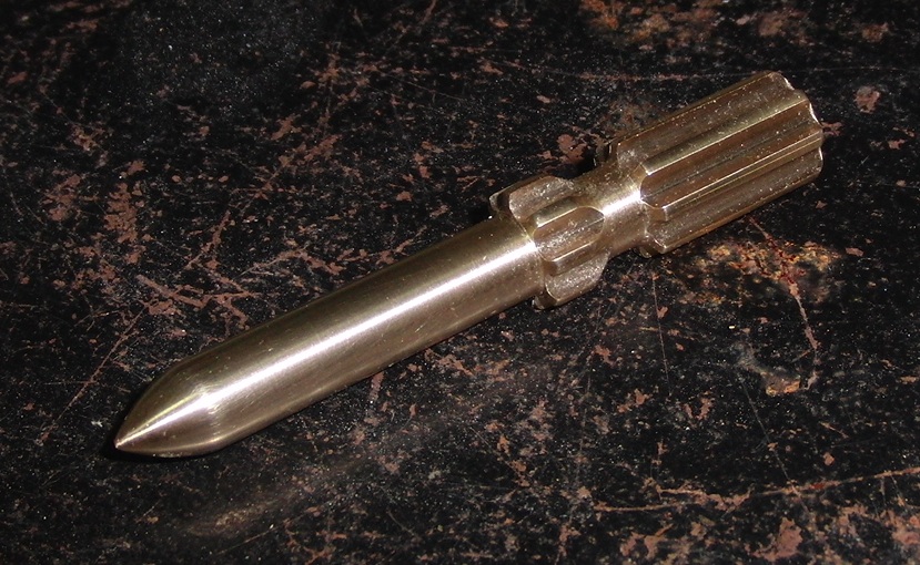

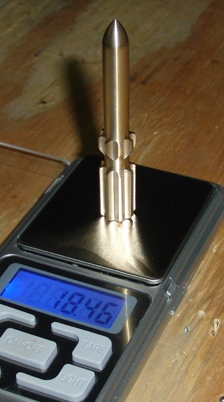

Ah, that was therapeutic :)

How many time to do it?
Petitlu wrote:Wow! :shock:
Wonderful and beautiful!
Cheers :)
Enough not to make mass production feasible ;)

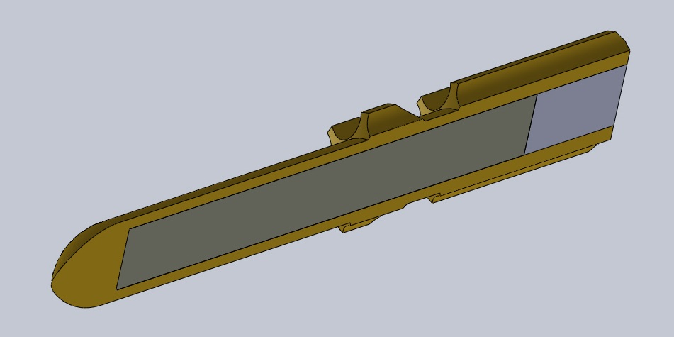

I also need to make a delrin plug to stop the tungsten's inertia making it fall out...

And if is glued the tungsten? a little hot glue or epoxy ...
The stainless steel point was glued with hot glue on the aluminum body
Definitely will need some epoxy, but it's better to have something physical between the pusher plate and the tungsten.

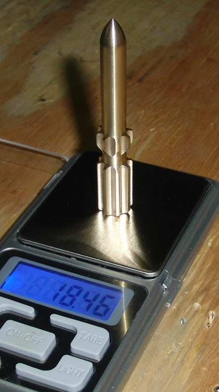

Your missile weighs how much?

Won't the brass nose just get crushed?
Gun Freak wrote:Won't the brass nose just get crushed?
Yep,read up ;)
But the tail should not be heavy ...
Tungsten: 19.25 g/cm<sup>3</sup>
Delrin: 1.42 g/cm<sup>3</sup>
I think balance will be fine ;)
Here you go:

it is beautiful! it shines!
With tungsten carbide it will weigh 38.46g, practically 40g with delrin! :shock:
EDIT :

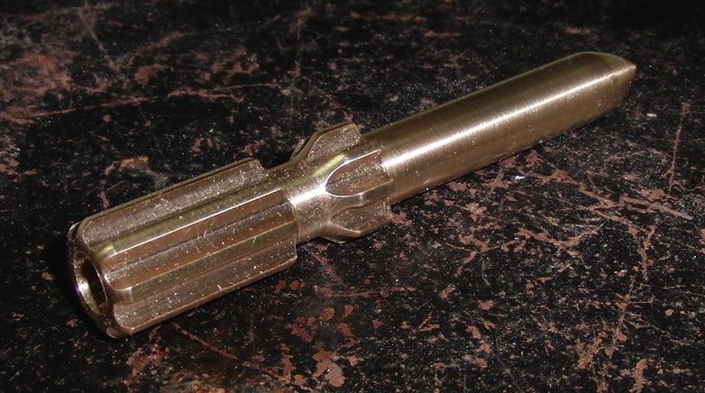

you'll put the delrin like that?
Petitlu wrote:With tungsten carbide it will weigh 38.46g, practically 40g with delrin!
More muzzle energy but lower velocity, so less chance of the tungsten core shattering. I want this thing to go through both flanges of the beam :D
Like this:
