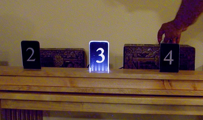

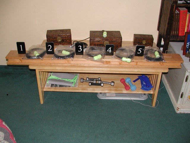

My main hobby is electronics. I had a request to build a jeopardy style buzzer board for a non profit organization. I delivered it today. The contestant buttons are doorbell buttons in 3/4 inch pipe caps on a short piece of 3/4 inch PVC pipe. The main box has sets of LED's that the Plexiglas number plug into in the top cover. This permits the contestants to either sit behind the board with the numbers facing the quiz-master and audience, or the board can be rotated so the cables come out the front so the numbers face the contestants. The plexi numbers are painted with Fusion paint on back of the plastic. The game board itself used a high speed clock to index a counter between the players. This prevents a tie as the first button sampled as pressed stops the clock locking out all other contestants and displaying the winner. A second timer does an auto reset after a couple seconds so the board is ready for the next question automatically.
For the electronics types, the board uses a Crystal clock module running at 64KHZ, a CMOS 4017 Decade counter to scan the buttons, A 555 timer to detect the scanned winner, Optocouplers to prevent errors from contestant button cable capacitance, and a set of 2sc1815 transistors to act as high current drivers to light the display as the CMOS does not have enough driver current to drive the display.
When a button is scanned and pressed, it triggers the 555 which sounds the buzzer and disables the count input on the decade counter which enables the display of the winner.
I stained the PVC with my home made primer to add color that won't rub off the buttons.
This could be easily be adapted with photo transistors to score a pine-wood derby for scouts.
