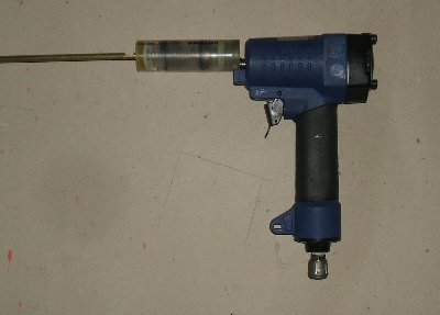

Back to the subject of this thread, I've decided to revisit this project. Given the velocities I got from a blowgun, I always wondered what the power would be like with a more efficient valve. In that regard, I've grafted the breech to my nailgun with the hammer piston blocked off and air channeling through a 6mm tube into the breech. Expect some results tomorrow.
edit: It's done, but I'll allow the epoxy to harden fully so testing's due when I come back from work
