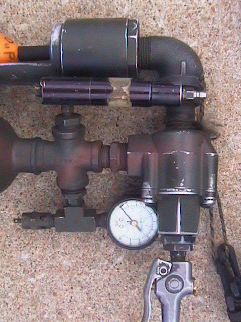

notice there is no air supply connected to the inlet port,
This valve is MODIFIED internally but nothing to impair its structural integrity. Added a return spring between the Shop Air Trigger and the piston and a nick in the edge of that piston skirt with about 1/32" dia area to LEAK air and allow pressure to equalize on both side as the air chamber refils. Otherwise the main valve won't close.

honestly my knowledge of qev's is limited as the cannon i am currently building is my first time using a qev. the mod was sugested by a fellow paintballer on another forum, and i have done it to my qev and it works great. i did quick throw together chamber to test it and am very happy with it . i did find out in doing research on the qev that the one in the picture wich is the one i have will do 600 cycles per minute, i would asume however that this rate can only be acheived with some electronic assistance. as far as a three way valve i don't anything about them so i can't say wether one will give you a better rate of fire or not.

Grumpy, could I get a link to that "other forum"? And thanks for the ROF info, that is just what I needed. 10 bps should be more than enough for semi-auto. I think I will do something very similar to the pic you posted, as it has the least possible pilot volume, and the chamber area is metal. I will probably use PVC for everything in front of the QEV, though, as I can't machine metal to make o-ring grooves for the bolt. If I used 330 psi- rated pvc, 300 - 500 psi rated metal pipe (aluminum, copper, or steel?) , and a 125 psi rated QEV, could i run the gun at 350 psi?
And, excuse my ignorance, but what is the purple-and-clear thing above the 4-way pipe?

don't think you will need 350 psi, remember you will be playing paintball, and i don't know about the paintball fields where you live but the fields here in fla. do not allow you to shoot over 280 fps, and even just playing in the woods with friends keep it under 300 fps. you can realy hurt someone if your fps is to hi, i have the scars to prove it to. not to mention most fields if they catch you will through you out, and you will most likely be met in the parking lot by someone you shot. now if you are just plicking at targets thats ok kick it up see what damage it will do. just play nice with other players that way everyone has fun.
the thing you asked about above the fourway is a regulator, it is how we control the velocity on our cannons, you will need one on your also to be legal may also have to have a safety popoff valve also.

Thanks for the link. THATS the regulator? I knew I needed one, I just did not recognise it in the pic. And yeah, 350 psi is for supersonic paintball target shooting, not splattering peoples guts out.
Also, in the QEV mod you mentioned, can it do semi-auto as well as full-auto? From what I understand, the CO2 would just continue to go through the barrel as long as the trigger is held down, unless a strong spring was used.

think of a spinkler valve and the little hole in the diaphram that lets the pressure to the pilot valve and chamber equal out and keeps the diaphram closed. it is basicly the same thing, the qev in this form would only give you semi auto, to get both semi auto and full auto you would have to go electronic. it may be easier to use paintball marker parts to build what you want. this is a home made paintball gun that used an airsoft guns shell and the internals of a paintball marker.
