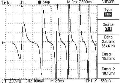

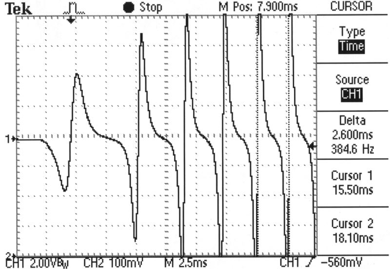

I have graphs of in barrel projectile position vs time. .1 seconds is way too long. I'll find one and post an actual trace later. 0.02 is much closer to reality.
EDIT
T shirt cannon performance data provided below. Entire full 10 division trace is 0.025 seconds.
EDIT
