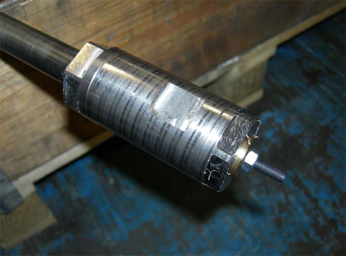

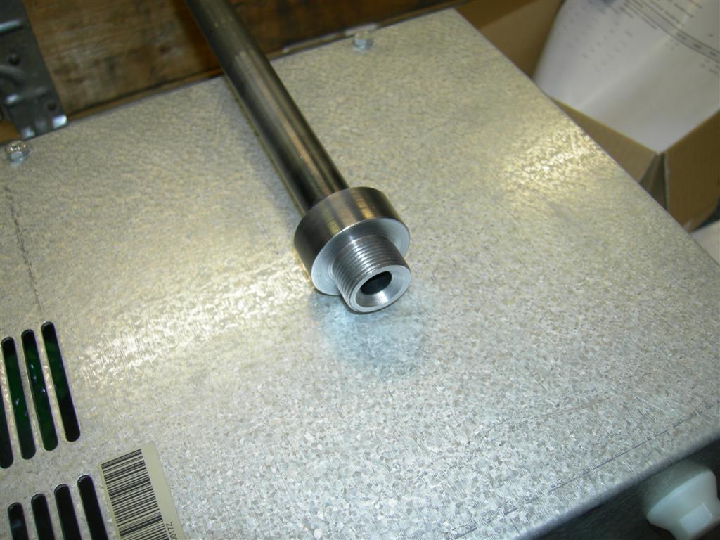

Copperboy wrote:Satan i Gatan!!
How did you machine your "chamber"? Nice work! :)
Copperboy:Sweden?

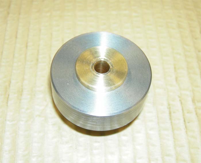

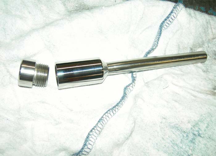

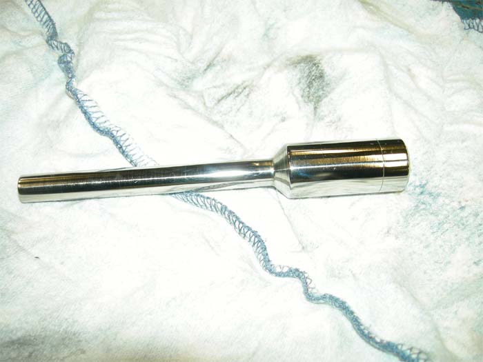

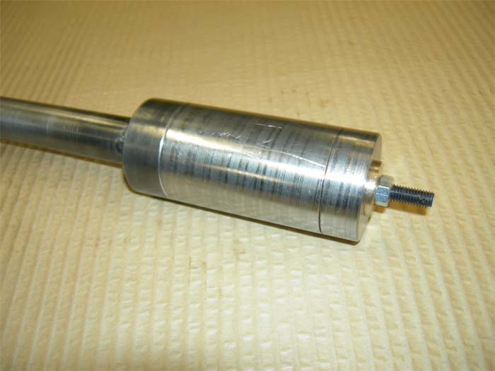

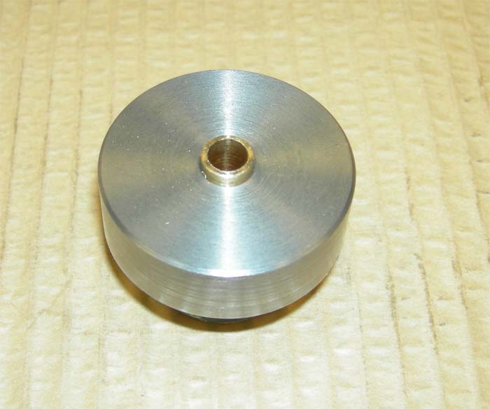

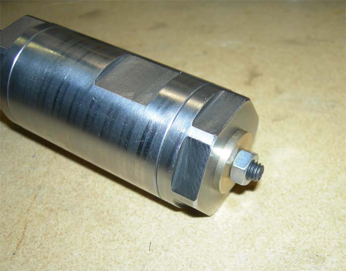

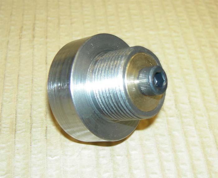

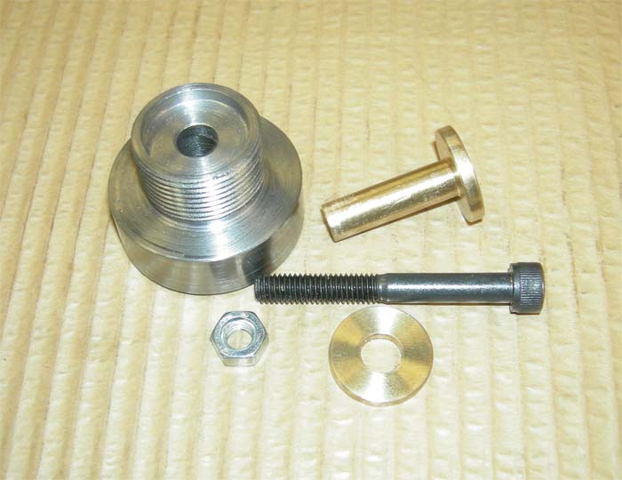

Some Pict's of the chamber.
The chamber is made of Cr-Mo- steel.
The brass parts is later made of Teflon.
And a short video of me milling hex on the en-caps.
http://www.vimeo.com/773647

Thats amazing, just keep updating us by pictures :D

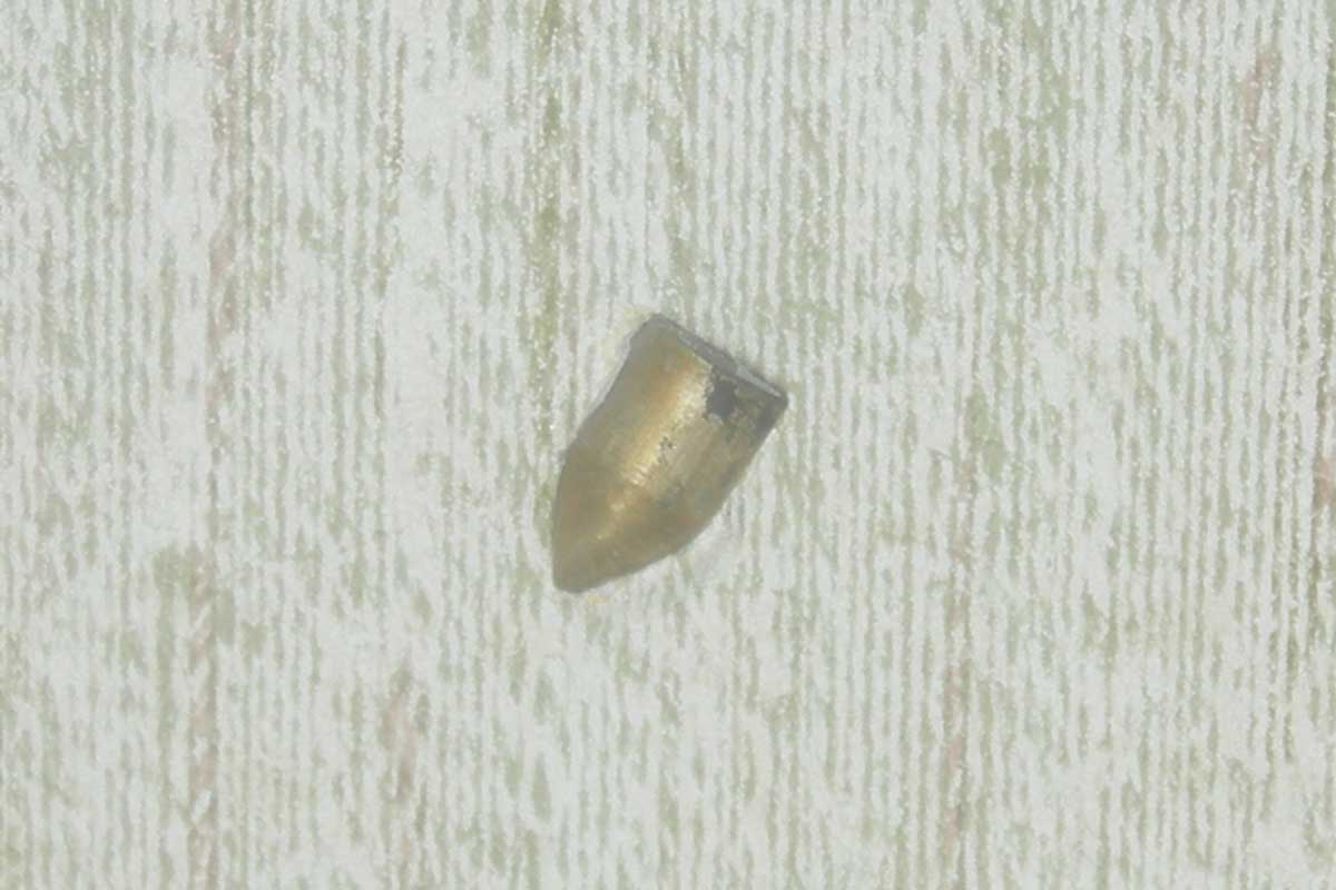

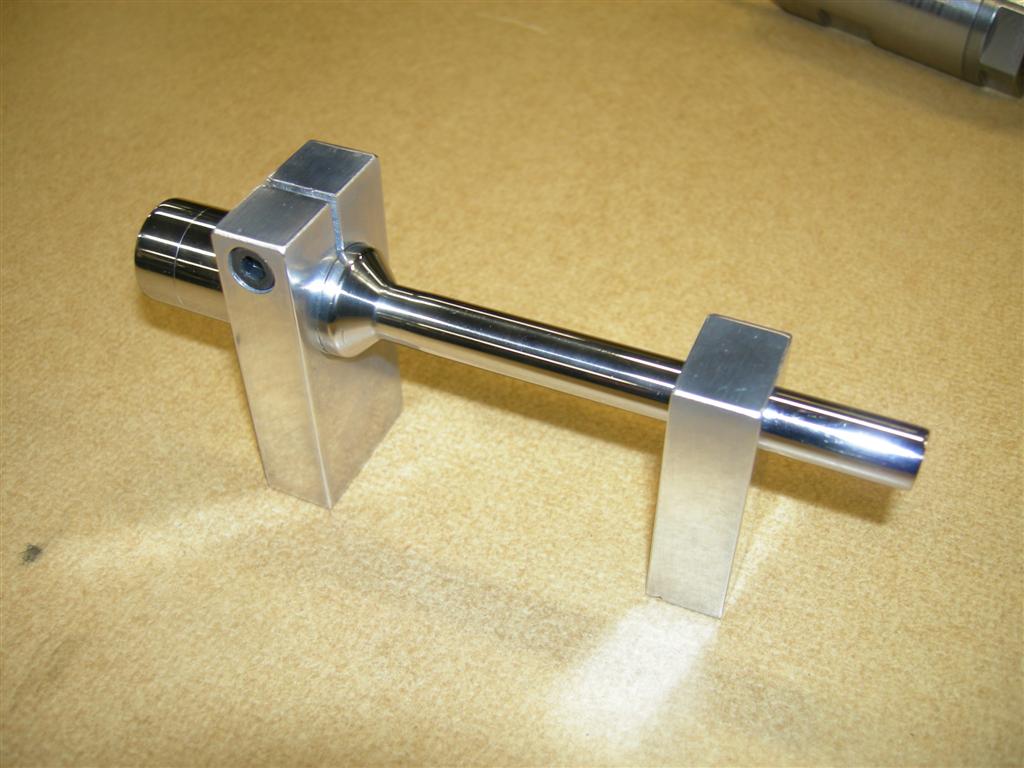

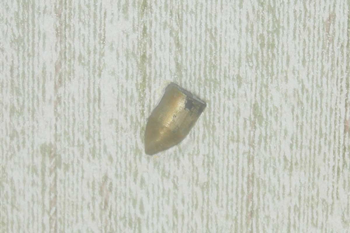

Actually i have already built a smaller caliber ETG.
Its the first prototype i built and its made out of stainless-steel, the barrel is 7mm and the gun is about 135mm long.
I only tried it with a smaller capacitor bank the results was so promising so i built the current one.
Two videos of the prototype.
I had some newspapers in the box to stop the projectile but instead of stopping it embedded itself into the wall. :evil:
http://www.vimeo.com/786297
http://www.vimeo.com/786306
And YES that is in my living-room.... :P
