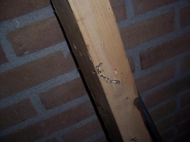

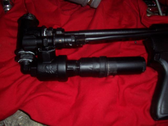

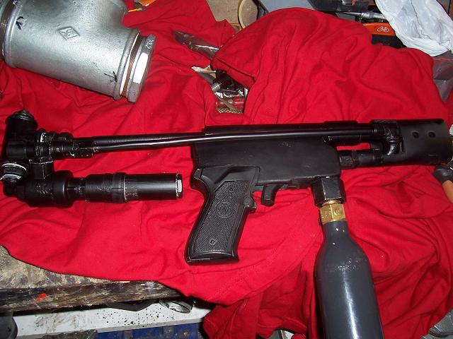

It sure seems to be..ZHere are some pictures of the Deathray Bullpup Assault Rifle..
deathray BAR...Because that;s what it is now.With it's full length rifled airgun barrel hidden in the stock..
Hard to see but gas enters from the right, though a 90 degree adjustable valve, enters the QEV, wehre the snapvalve sets it off.Air travels up and enters the bb reservoir, located at the very back of the stock.Entry hole is 4 mm.

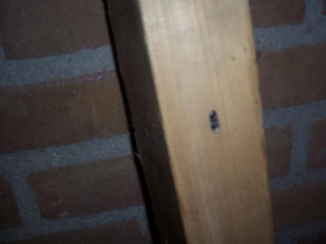

Can't get them out..one is stacked on another and the top one is flattened..
Damage to wood
Damage to wood

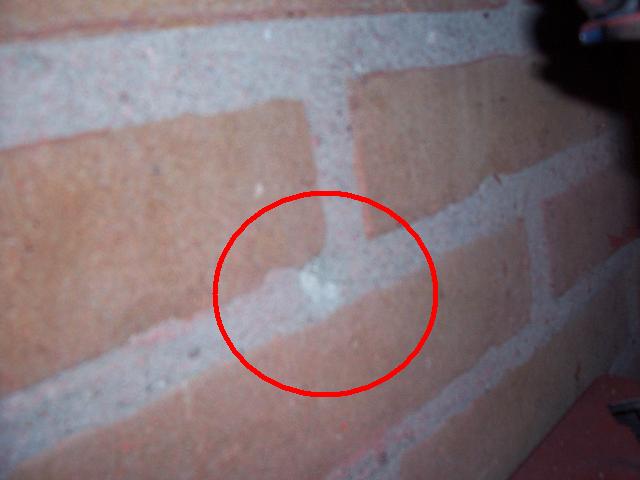

Hard to see but it removed a chunk of brick wall about 1 cm deep

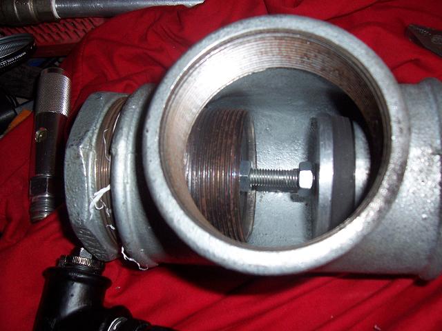

And the two inch porting metal piston valve that has been keeping me busy lately.
Basicly built around the barrel, the gun is as compact as it could be, without sacrificing barrel lenght.<br />The entire gun is about 1 inch longer than the barrel is.

i don't see the pics?
Netherlands
Posts: 3497
ALIHISGREAT wrote:i don't see the pics?
I know..I first post..then edit so it's easier to insert pics...how bout now??
ALIHISGREAT
Posts: 1778
Location: UK
yeah... very cool indeed! but i there any chance of a full length pic?
Netherlands
Posts: 3497
That is a full length pic.
okay..you can;t see the edge of the T in the back, but I asure you that's all there is..

What pressures are you thinking of with using that 2 incher? Hopefully using that fridge compressor of yours? Or did yours break some time? I knew someones did.

I think that was frankredes mauler valve I think I think.

great job, that is just insane. I can't wait for the 35bar chamber addition. Just fill up all of the empty space around the gun with piping...

Sexy! in its own way :D
I particularly liked this damage shot, but you can't give us these teasers without a video!
