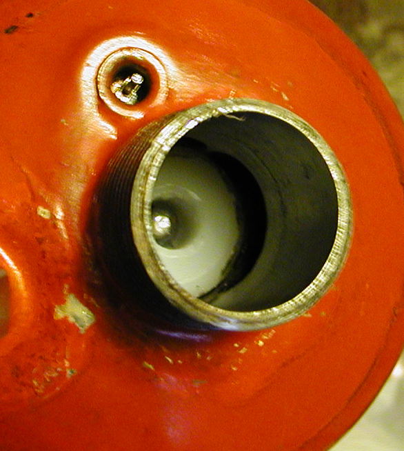

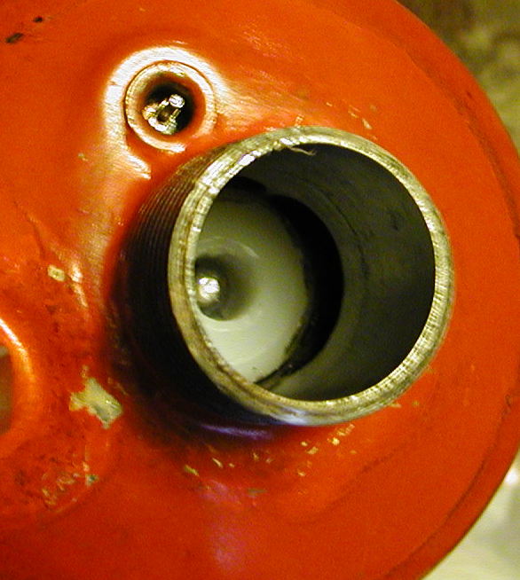

Very nice. I like it. Would it take much to change a very small item and angle the pressure relief valve so it is perpendicular to the curve of the end instead of parallel to the tank centerline? No need to bother if it is difficult to rotate the part slightly. It is a minor detail.
dewey-1
Posts: 1298
Location: NE Wisconsin USA
The angle is 5 degrees for relief on this drawing.
It will not be all that noticeable. For your drawings it will have the angle.
Here is original for comparison.
Annoyingly detailed as always, good stuff :)
jackssmirkingrevenge wrote:Annoyingly detailed as always, good stuff :)
I never noticed the shoulder under the relief valve. I took a look at my launcher and can see that there is indeed a flattened area for the relief valve. I never noticed it and assumed the valve was flush with the curve of the tank. It just looks bigger in the rendering. Nice job on the tank. Looks great.
Relief valve on a disposable propane bottle
