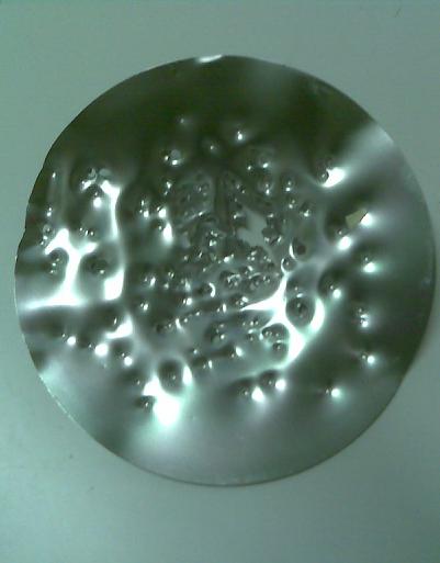

Unfortunately with the smaller calibre power is down from what it had been with pellets, here's what happened with the 0.5mm aluminium plate, most rounds failed to penetrate it - no video though, too many BBs flying back at my face :roll: but with 450-850 psi on tap eventually it should be a blast, literally :D

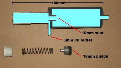

What I'd like to know is any internal dimensions you can give me on your valve; seat diam, piston diam, est. dead space, chamber volume, and also does your piston cover the "out" port initially, and only vent once it has moved a little?
I think you somehow hit a sweet spot with the dimensions you used that doesn't necessarily work with similar designs, so I'd like to have a shot at "cracking the code" so to speak.
It is important the that piston doesn't obstruct the outlet when it's closed, otherwise when returning from the first cycle it will encounter pressure and "hang" - In my design (the second one is essentially the same aside from the substitution of the air spring with a coil spring) I avoided this.
In terms of dimensions I had already mentioned two critical factors earlier in the thread:
1) The piston seat must be significantly bigger than the outlet to the barrel, to ensure that the piston chamber fills with pressure faster than it can empty and the piston has time to actually pop
2) The piston must be significantly wider than the piston seat, in order for there to be enough area for the pressure to act on and overcome the spring strength.
I attached a diagram of the sprung design with the relevant dimensions to give you an idea.
The other two relevant factors are spring strength and rate of flow into the chamber. The spring setup I'm currently using will pop at around 80 psi, and my compressor starts out at 110 psi. Flow into the chamber is also important to establish reliable functioning and rate of fire. I adjust this using the flow control knob on my compressor, in this case it is a question of finding the "sweet spot" for a given pressure and spring strength.

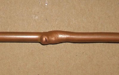

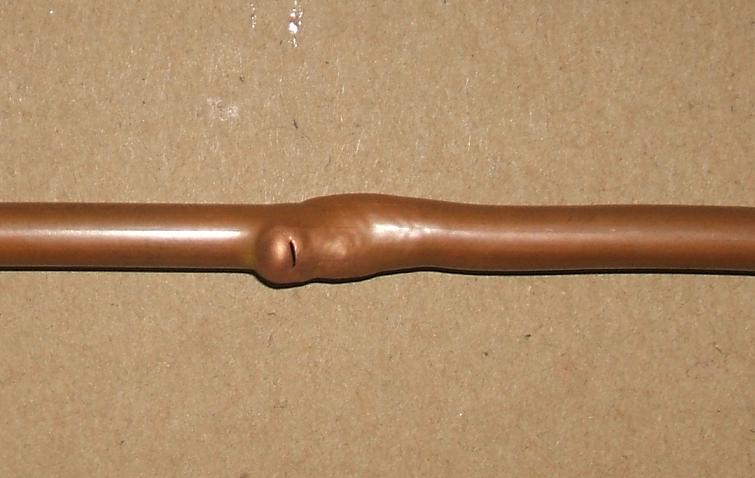

Can't quite describe it :) I was in a hurry when I did it though and didn't realise what had happened to the barrel, see attached pic! No idea why or how, I'm thinking barrel jam or loose rolling BB struck by another projectile.
