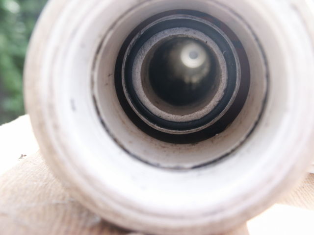

I put this here for those who want to make their own larger QEV valves. The dimensions on this valve make it a QEV.
Here are a couple photos showing the replacement of a cracked 1 inch PVC pipe cap used as a piston in a 1 inch coaxial. This cannon is now retired as it was dropped once too many times. The other end of the chamber cracked the coupler and 2 inch to 1 inch reducer. :( This is now retired. I know :!: FAIL :!:

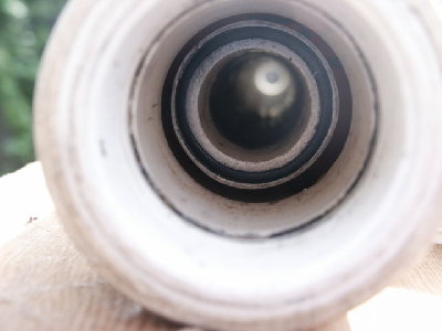

Valve cylinder and seat seal.  The large seat makes this a QEV as the piston diameter to seat diameter is a low ratio.

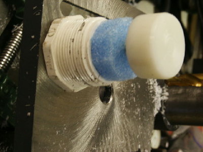

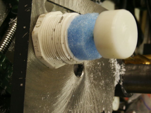

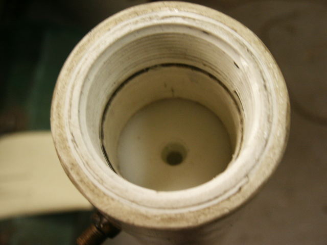

Piston in place in the new home.  Cylinder is 1.5 inch pipe inside a female 1.5 threaded adapter.  Assembly is swedged in the end of 2 inch pipe.  It's ready for the bumper and plug with the trigger.
Ready to assemble
Ready to assemble

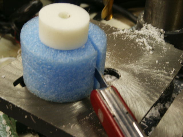

Swim noodle cut for the bumper

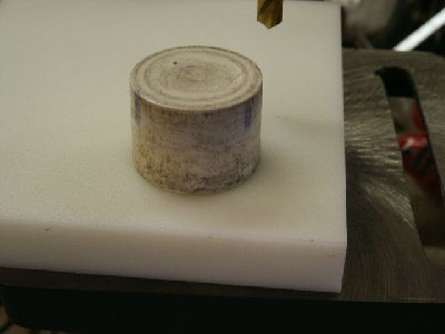

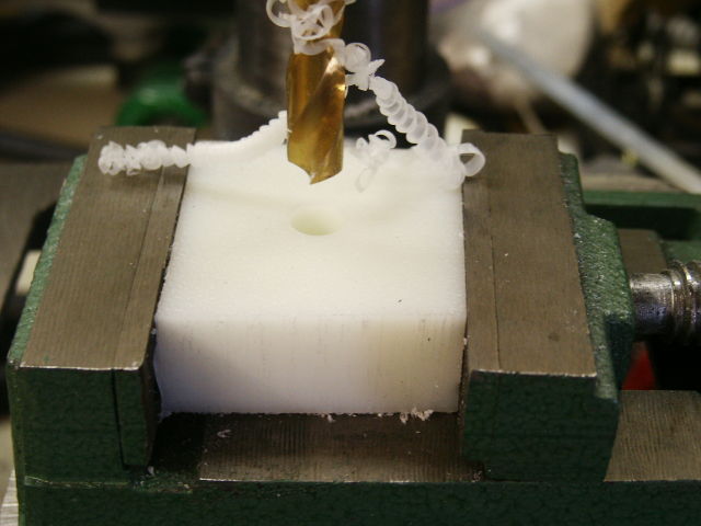

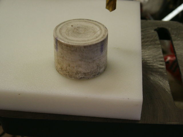

Cutting board wrinkle finish machined off

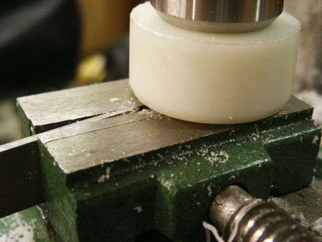

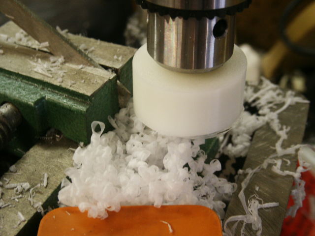

Turned on the drill press to proper diameter
Drilled for drill press arbor (bolt)
Block cut
Block cut

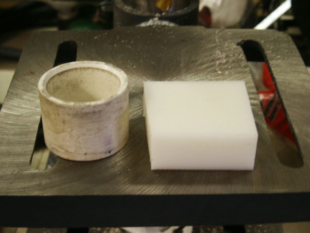

Old piston on a sheet of HDPE.  It is easy to see the diameter of the valve seat in relation to the OD of the piston.

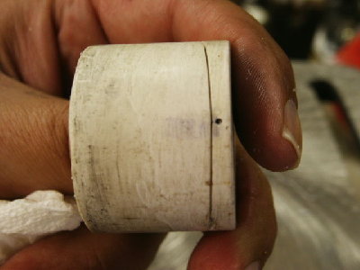

Original PVC crazed and cracked in an unexpected place.  Repeated stress, not impact killed this piston.  This is the 3rd failed piston in this cannon.  The other 2 failed by ejecting a chip out of the center of the face, an area not in contact with anything. I need something better.
