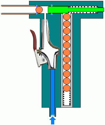

I like your basic layout of the autoloader. Under close examination, it will need a change in the trigger/air source.
With just a blow gun, when the shot is fired, and the plunger pushes back, if the air is still on, the pressure will lower the collum of rounds preventing feeding.
A small chamber with a high flow hammer valve could make it work with a properly massive plunger. The chamber would pop through the hammer valve and discharge the round and then close. The pressure pulse would have imparted KE and momentum to the plunger which continues moving even in the lack of chamber pressure/closed hammer valve. This would leave the pressure away from the magazine so it would spring load the next round and the plunger finishes it's loading cycle for the next shot.

Tech wrote:I like your basic layout of the autoloader. Under close examination, it will need a change in the trigger/air source.
With just a blow gun, when the shot is fired, and the plunger pushes back, if the air is still on, the pressure will lower the column of rounds preventing feeding.
Not necessarily, first of all having the magazine tube say 1/8" wider than the projectiles will prevent this effect because the pressure in the tube will equalise.
Also, if you don't use "just a blowgun", you would be negating the whole advantage of using the valveless/pop-off principle, which is basically getting performance better than a piston valve using only a rudimentary trigger valve.

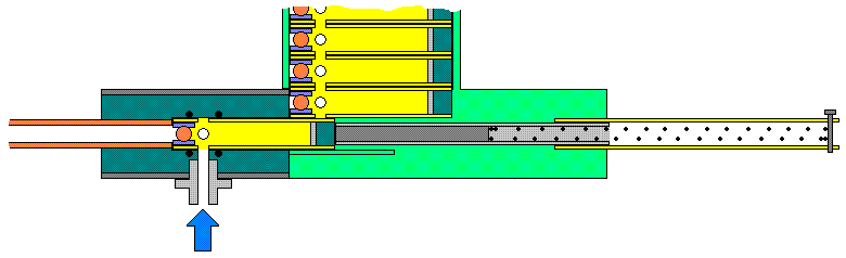

The theory is that you open the blowgun and the pressure builds up, sealing the projectile in the breech against the seal and pusing the bolt back. Bolt spring compression should be set so that the projectile pops around the time the bolt passes over the magazine.
Once the bolt is past the magazine, a new projectile rises into the breech while the bolt continues to travel back by its own momentum. The bolt then stops and reverses, pushing the new projectile into the seal.
The trick is to balance bolt weight/spring compression to allow the above cycle to happen, once that is achieved I see no reason why it shouldn't work as described.

Technician is right - it might be tricky to get it to work right. Some of these problems can be solved simply by turning this into a hybrid. In fact this design is pretty much the thing I designed for the hybrid I am building.
The cool thing about it is that you can easily use it on coaxil guns
As you can see it is possible to build a breech loaded coaxial

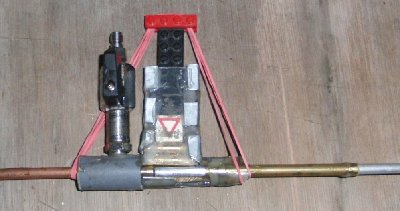

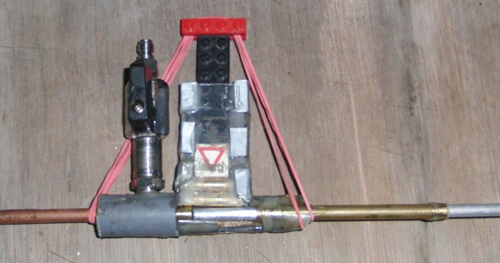

You can say that, but at least in this case the cartridges are actually contributing to the function :) couple of hours of work left and I'll test it as a multishot :D
Edit: Here's a test of the cartridge ejecting with the new breech, with the target - a CD in this case - is visible being struck in the background. Time to make a magazine and some more cartridges :D
Edit 2: I made the magazine a little too tight and it's causing too much friction with cartridges fitted so I'm going to have to redo it, but tested it with a rubberband sprung balsa wood follower and it's looking *very* promising, the follower snapped into place before the bolt came back, if that was a cartridge it would have most likely been fed into the breech :D
Edit 3: Getting there, but not quite...
The potential solution is a heavier bolt, increasing bolt travel and reducing spring pre-compression, giving the bolt a really good run up so it can smack the new cartridge into the breech.

or you could try increasing the slide room for the bolt to allow the next cartridge to settle before the bolt slams into it
The problem isn't that the next cartridge doesn't have time to move into place, but the bolt itself doesn't have enough cojones to push the cartridge into the breech.
My plan therefore as in my previous post is to extend the bolt spring housing, which reduces spring pressure on the bolt while allowing it to slide back further, the idea being that it will build up more momentum and bodily smack the cartridge into the breech when it returns.
