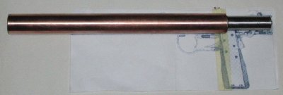

It's not *that* big, 33mm I/D copper, around 37cm long - certainly not the biggest I've ever madeMrCrowley wrote:My word, that is a large suppressor.

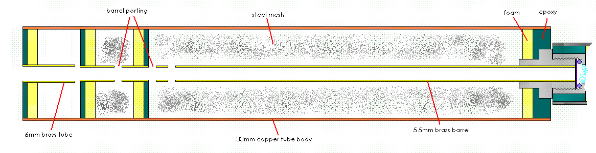

Here's the actual internal construction, currently curing with testing scheduled for tomorrow morning.
- minihybridsuppressor.GIF (28.12 KiB) Viewed 3947 times

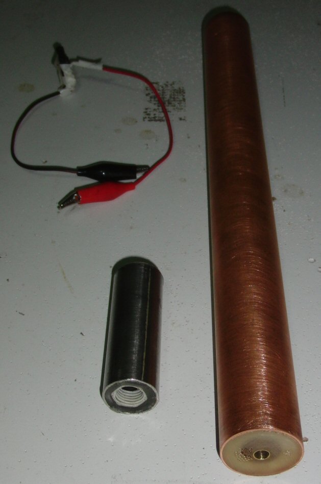

Here's the (roughly sanded) suppressor, chamber and ignitor setup:

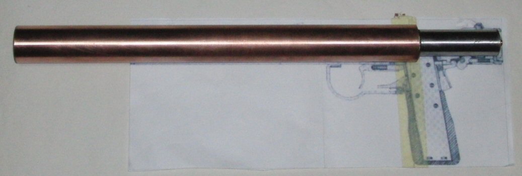

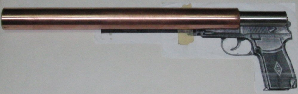

Here it is assembled with what it might look like with a Welrod or Makarov PB style grip, I'll make some videos later in the day to take advantage of the natural light for some decent HS footage.can we get a picture of the whole thing assembled, maybe a video of it firing at something with the suppressor?
