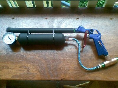

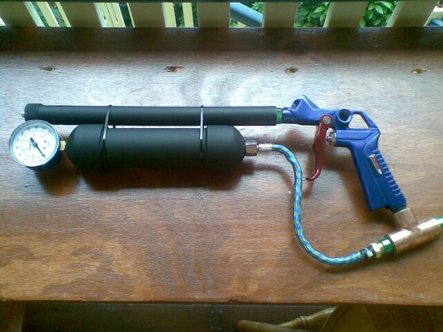

At last I have a couple of teaser photos for you..
There will be more to come but for now its all I had time for..

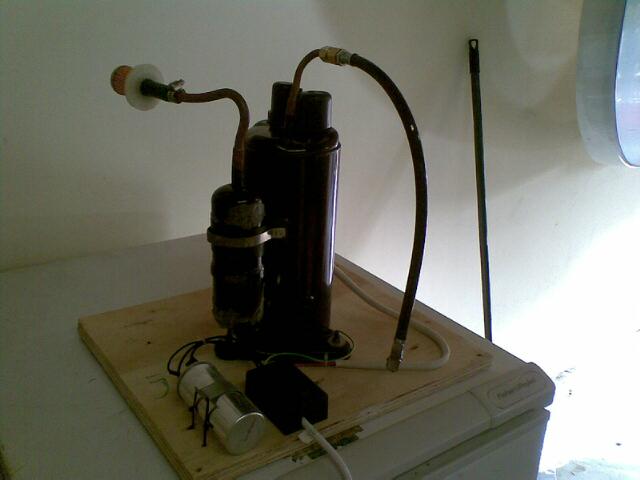

Got a little testing in this afternoon.. initial tests resulted in the connector pipe seen in the pic bursting at 200psi which I expected. I have replaced this now with some high pressure fuel line, but Im working on making the connections on the pipe more air tight, hose clamps just dont cut it..
for testing I just ran the bottle screwed straight into the Tee junction.. at 160 psi with a light trigger finger I could manage 4-6 single shots.. I need to work on the mag feeder though and put a spring in there as I was just reloading after each shot.. the mag screws into the side of the blowgun where there is a hole as you can see below.. Im pretty happy with the power, from across the garage (8 metersish) it went straight through a can and ricocheted all around the garage.. I know a can isnt all that much to get through, but Its enough for me for now.

As for the compressor it goes really well, fills that little tank to 200 in about 15 seconds, the release noise is a bit of a worry though, gonna have to get a valve thingo.. the little black box in the pic is just a project box with a switch in it, just to tidy up the wiring a bit.
It does get a little warm though, is this normal? I put in a fair bit of oil to make sure its oiled... It gets warm, and stays warm for a fair amount of time after use..
Anyways, let me know what you all think of my first build :D
Any constructive criticism is always welcome, thoughts, ideas, and improvement would be great.

Looks good :) and yes, you do need a bleed valve on the air line for safe disconnecting, especially if you're going to up the pressure.
Hope you had some ear protection on...

It wasnt really loud or anything.. just sprung a small hole and the air hissed out..I could see the tube starting to bubble, turned the compressor off, then it popped..
