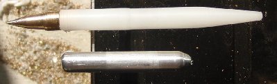

Here the ammunition which I fire with my PAC 3000psi cal 50 (12.7mm) and cal 16mm
The gun in 16mm not being striped I did not do that:
Ammunition very stable, skirt aluminum and point steel
saefroch
Posts: 1679
Location: U.S.A.- See Map

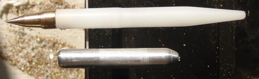

Those look amazing. Are the ones with a longer tail section notably more stable?
And I notice that JSR's version two with the aluminium body/tail has a shorter nose/head than the Delrin version. That may have been what made the biggest difference, especially if the Al has a greater linear mass density than a Delrin cylinder of the same dimensions.

In 16mm:
overall length: 80mm
Length skirt aluminum: 70mm
threaded rod steel: 30mm of which 20mm inside
Weight: 35g

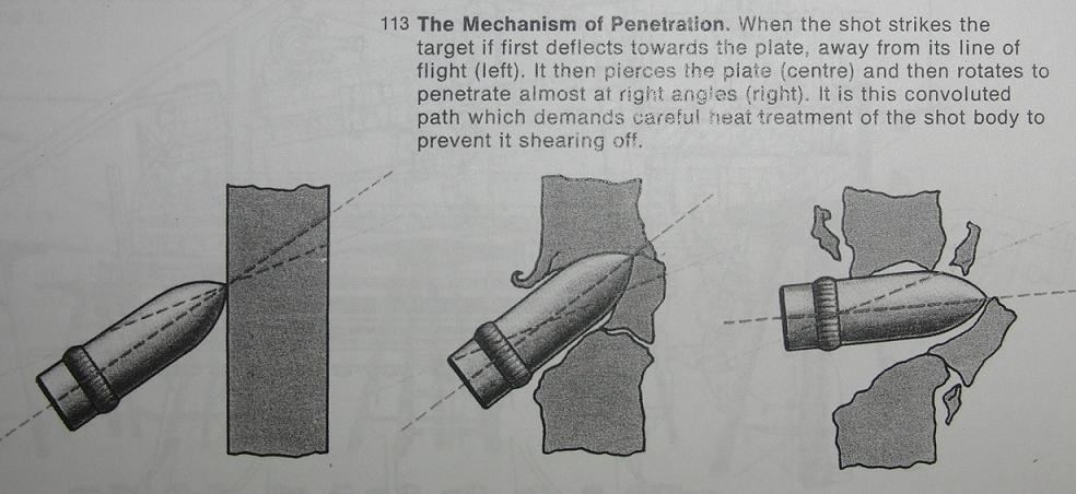

As Brian mentioned, high velocity does mean the projectile has less time to tumble before it hits the target, also worth nothing that plywood is a relatively hard target so other forces come into play, see the attached segment from one of my artillery books.

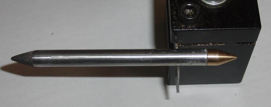

Next time post a picture of both at the same time.
That way we can observe the difference in the CG points.

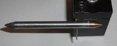

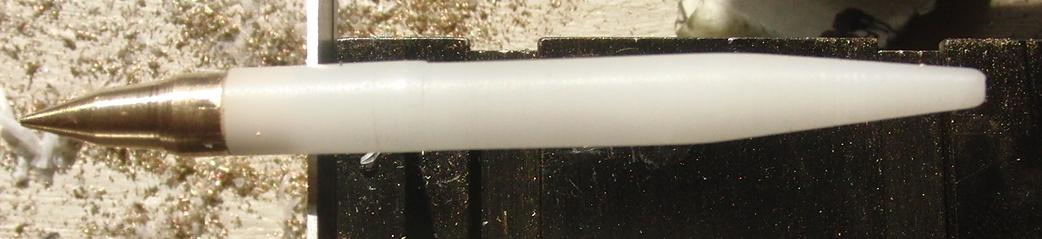

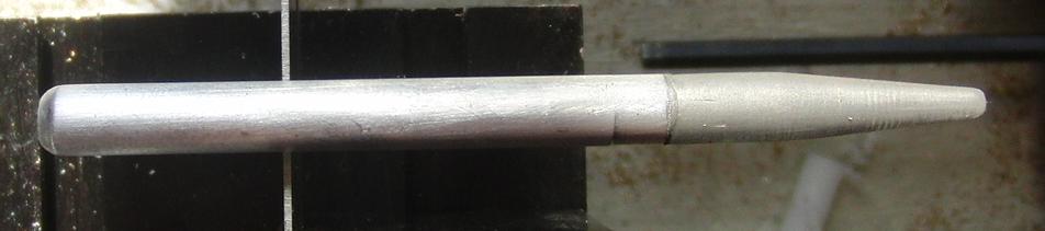

Taking the maximum diameter of all projectiles being 6mm as a reference the dimensions can be worked out from the photos, I tried to take more vertical shots now.
What are the dimensions on that aluminium rod? How does the linear mass density compare to that of UHMWPE or Delrin? I think you'd want to continue trying to use plastics; I'm pretty sure aluminium rods (hollow or not) will get pricey...
6mm OD 5mm ID, I'm just using parts from my scrap box - remember this is just to play with projectile shapes, not meant for production.
Read the article - they state explicitly that it is drag stabilised
I was referring to the Gyrojet ;P
That will reduce base drag (which will shift the CP forward) and add weight to the back (which will shift CG to the back) so it can f### things up
That's pretty much what happened, read on. Duane postulated that the muzzle blast might be deflecting the conical tailed projectiles, I intend to try using a wad and see if it makes a difference.

Well we already know that a tube capped and weighted on one end makes a stable projectile - my contention is it's not very aerodynamic, but what I've found so far is something that maybe should have been obvious from the beginning - reducing drag also reduces the efficiency of drag stabilisation :roll:

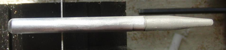

lead weight in the nose, tail packed with balsa wood and filed to a conical section, hit sideways at 10m
original "special" projectile with shorter and hollowed out body, hit sideways at 10m
lead weight in the nose, conical delrin tail, hit sideways at 10m

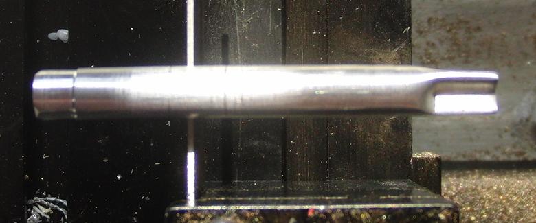

lead weight in the nose and fins created by crimping the end of the tube in a 3 jaw chuck, flew straight
balsa tail fitted, didn't change CG much but the projectile hit sideways at 10m
The mechanism of penetration *chuckle*

COG test:

Seems like the quest is over.
The quest for what though... These projectiles may be stable but probably have reasonably high drag too, not necessarily any good for long range.
The Delrin tail projectiles are probably upset by muzzle blast as they are only kept centred in the barrel near the tip at full bore diameter, also there is a more likely chance off pressure effects from muzzle blast acting orthogonally to the flight path.
Our estimated CPs are slightly optimistic, as the centroid method works for objects extruded straight out from the studied section generally having a higher drag than the real projectile. Although that empirical 1.5 calibers probably takes that into acount.

Petitlu wrote:In 16mm:
Weight: 35g
Very nice ammo.
What is the thread size and pitch?
What is the wall thickness on aluminum tube?
Where is the center of gravity of this ammo?
I am guessing about 15 mm from nose tip.

Some math ahead of time would have been nice for this experiment :P, Could have saved JSR a log of machining.
Linear mass density of the Al rod: .0234g/mm
Linear mass density of the Delrin: .04g/mm
Linear mass density of UHMWPE: .027g/mm
The hollow aluminium rod clearly wins, especially with the crimped fins. I don't see too much use looking into other designs, unless you want to try a hollowed-out UHMWPE or balsa boattail plug in the Al to avoid fins.
