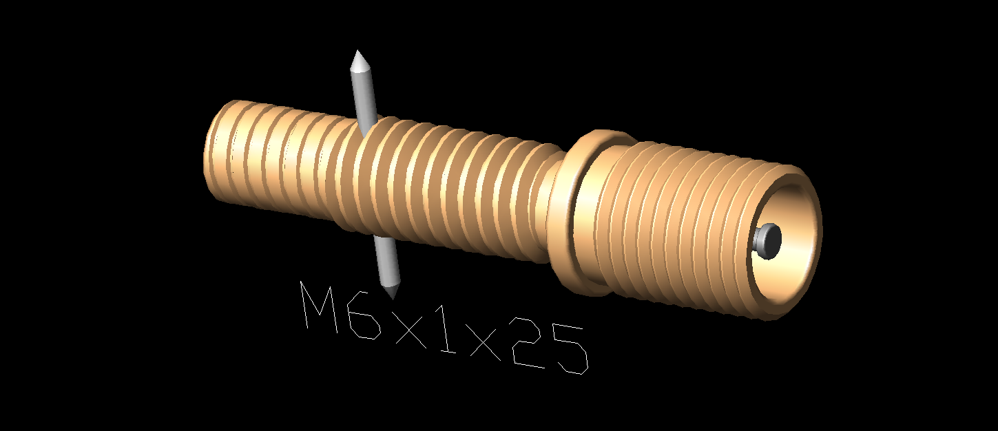

jackssmirkingrevenge wrote:
Also here's a design for a hybrid cartridge using existing pipe instead of a completely machined body, in order to keep lathework to only the essential parts. The machined areas are shown in light grey, and I also intend to use the electrode design dewey-1 had suggested.[/quote]
You could tap the Schrader valve as shown.
This would allow threading for use in pneumatic and also act as a good bondind surface for the epoxy in hybrid cartridge.
A so called "universal" cannon Schrader!

Something like that exist already, TR CH3 tapped both ends. But unfortunately it is also an exotic size.. something like 3/8 NF32 I think.
As for the "outside" barrel that is threaded too, I checked but I can't even find a match of its thread on my gauge :-(

A M6x1 tap and die or a 3/8 NF32 I think?
dewey-1 wrote:You could tap the Schrader valve as shown.
This would allow threading for use in pneumatic and also act as a good bonding surface for the epoxy in hybrid cartridge
One disadvantage in the latter role is that eventually the schrader can come loose, usually if I'm epoxying a threaded surface I want to fix permanently, I make cuts in the thread to prevent rotation.

dewey-1 wrote:The simple question to ask is, which is easier to do and purchase?
just want to add, if you want to cut threads on a Schrader, use a M6x0.75 die to cut the threads, a M6x1 cuts too deep, and this will weaken the valve enough to cause it to break, this happened to me while I was still busy cutting the threads and it is quite difficult to remove bits of broken Schrader from your tools...
