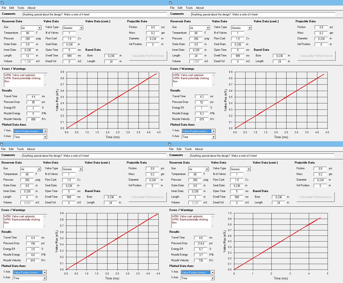

I am making a coaxial sniper, my I get help :D
Gas: Air
Chamber Dimensions: 1/2 inch ID and 1ft long copper pipe
Barrel Length: 24 Inches 6mm ID (Tightbore Barrel) 11 Inches of Barrel Inside the chamber, 13 Sticking Out
Pressure:250 PSI
Trigger: Blow Gun
Piston Diameter: .49 Inches
Piston Weight: ?? Making out of Derlin, so 5 grams?
Pilot Distance- .25 Inches
Projectile: Airsoft BB .2 Grams
What I want to know is how thin(diamter) and or short can I make the chamber and still hit a peak fps with 250 psi and 24 inch barrel
Here you are, modelled at 100%, 200%, 50% and 25% of your specified chamber volume
