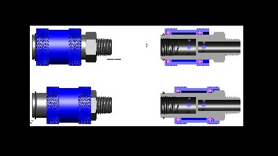

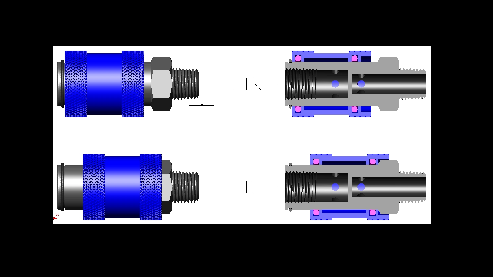

I really suck at this, so excuse me if i didnt read the guide fully, How does it work? I mean how could i setup it up? If you could tell me i would greatly thank it
And where did the air go on the video, to the can or just outside the QEV?
Thanks in advance
Posts: 26220
Been thanked: 352 times
This should clear it up.
dewey-1
Posts: 1298
Location: NE Wisconsin USA
I updated the slide valve to show O-rings.
I had to "guesstimate" the locations and size! :)
Posts: 26220
That's a good guestimate, nice one :)

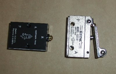

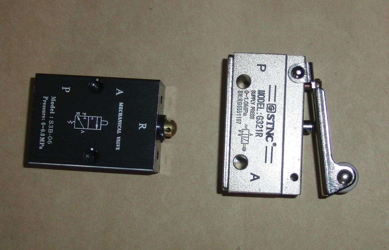

Lookie what the postman brought in :)
For those of you who think slide valves are not "trigger like" enough, I bought a couple of rather smart poppet style three way valves, each for under $10 posted from eBay.
Will give them a whirl and let you all know what they're like :)

Probably leak pass 200 psi, or even less, or not.
MAY contain plastic parts
(my experience).
