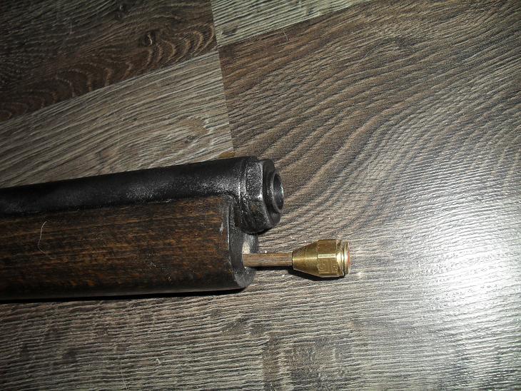

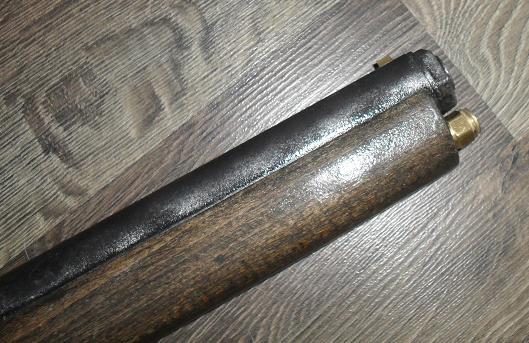

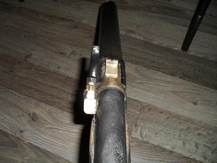

I've made some iron ( brass) sights...made the tunnel for the ramrod, a brass tip for the rod...In the bottom picture it's partially pulled out.
You can barely make out the front sight.It's triangular seen from the front, just a piece of brass..Rear sight is fixed.

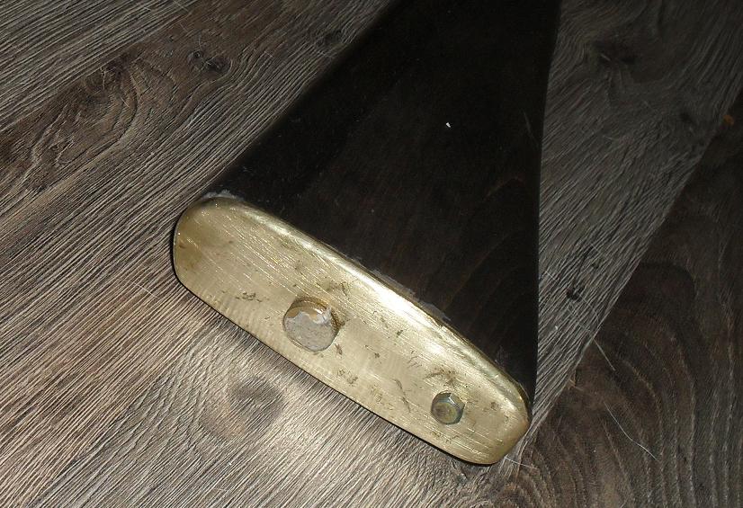

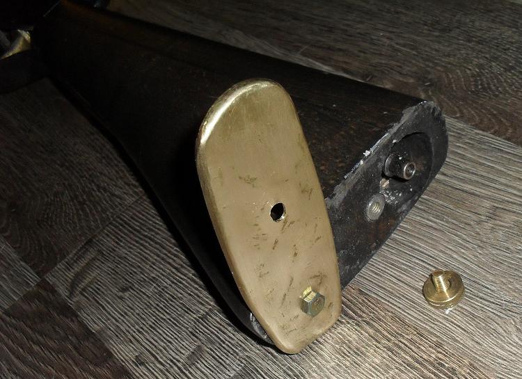

And I made a buttplate out of brass pipe.
I cut it, folded it open,( PITA!!) flattened it and hammered it into shape by hand.
Like panelbeating..?
The edges are now curled.
I really enjoyed the process.
Not a perfect fit and you can clearly see it's been hammered...but I kinda like it..
Only time will tell how well I can clean it up.
I'll fix up the damaged paint later after I completed the fit to the stock.
The buttplate can be rotated after the centre screw is removed by hand.
The other bolt will be replaced by something better suited for the job.
Pictures are in random order...

Superb. Sometimes I also "unfold" tubes to get foils
It's a great idea to have the ramrod incorporated, for a coaxial

It's not the surface I'm worried about, it's the rounded edge not fitting the stock properly and the lack of sufficient thickness.I found heating it up then clamp it in a vise left a better surface than hammering. Repeat the process until you get a large enough foil
A 100% fit would give it enough support against the stock but without it, the 1mm thickness means it's wobbly.
I'll get it right, just not sure when.

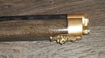

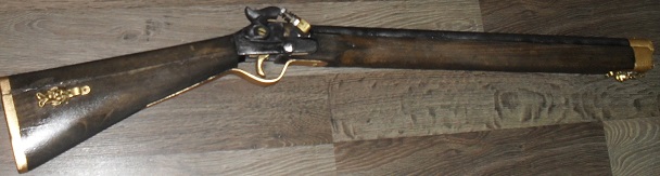

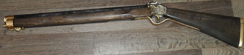

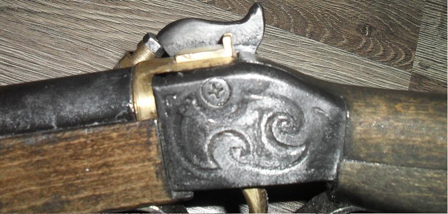

Added some gold/brass paint and some ( actual) brass lionhead sling attachment thingies...

Seems like I'll have to do a little touch-up anyway..
I had to take her apart.
The piston got reduced to shreds...I used several layers of thin rubber and washers as the main body.I glued an O-ring to the front, slightly larger than the required diameter so it would hug the walls.
Logically, the superglue dissolved because of lubricants..
Anyway.
I sharpened a scrap section of the outer reservoir tube and cut a new piston out of solid 1/4"rubber.I backed it with a metal washer.
As I had opened her up anyway...I decided to insert a second tube into the barrel, reducing caliber to 8mm....perfect for some rubber toy bullits I have a lot of.
The double layered barrel should be able to withstand a lot more pressure safely too.
I also extended the barrel a little as I realised I had way more piston movement than was nessecary...thus reducing pilot volume to the absolute minimum making it very responsive to the hammer.
I could probably ( an educated guess) pilot it at 30 bar easily.
Maybe more.
I just fired it at 18 bar and this thing is a beast.
Did 6 very powerful shots and it doesn't seem to be losing much power yet.
Dented a steel toolbox..took the paint right off.
I'm wondering how much damage I would get with lead projectiles....
