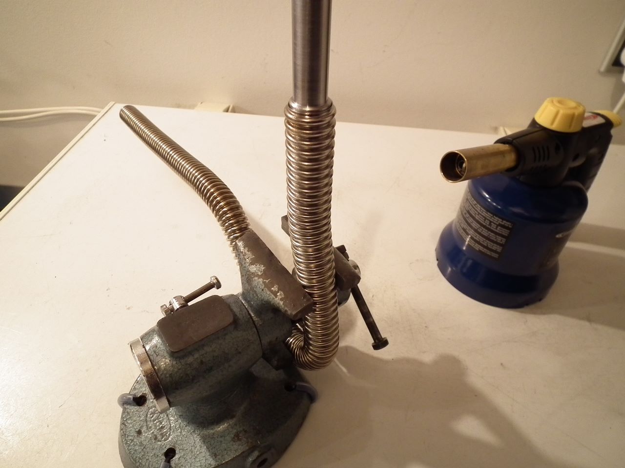

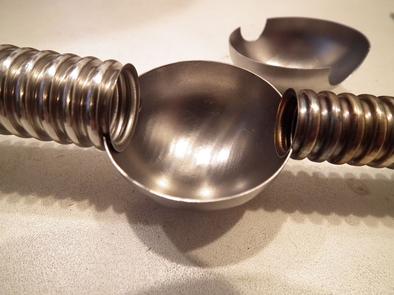

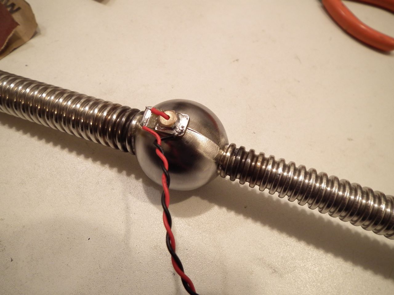

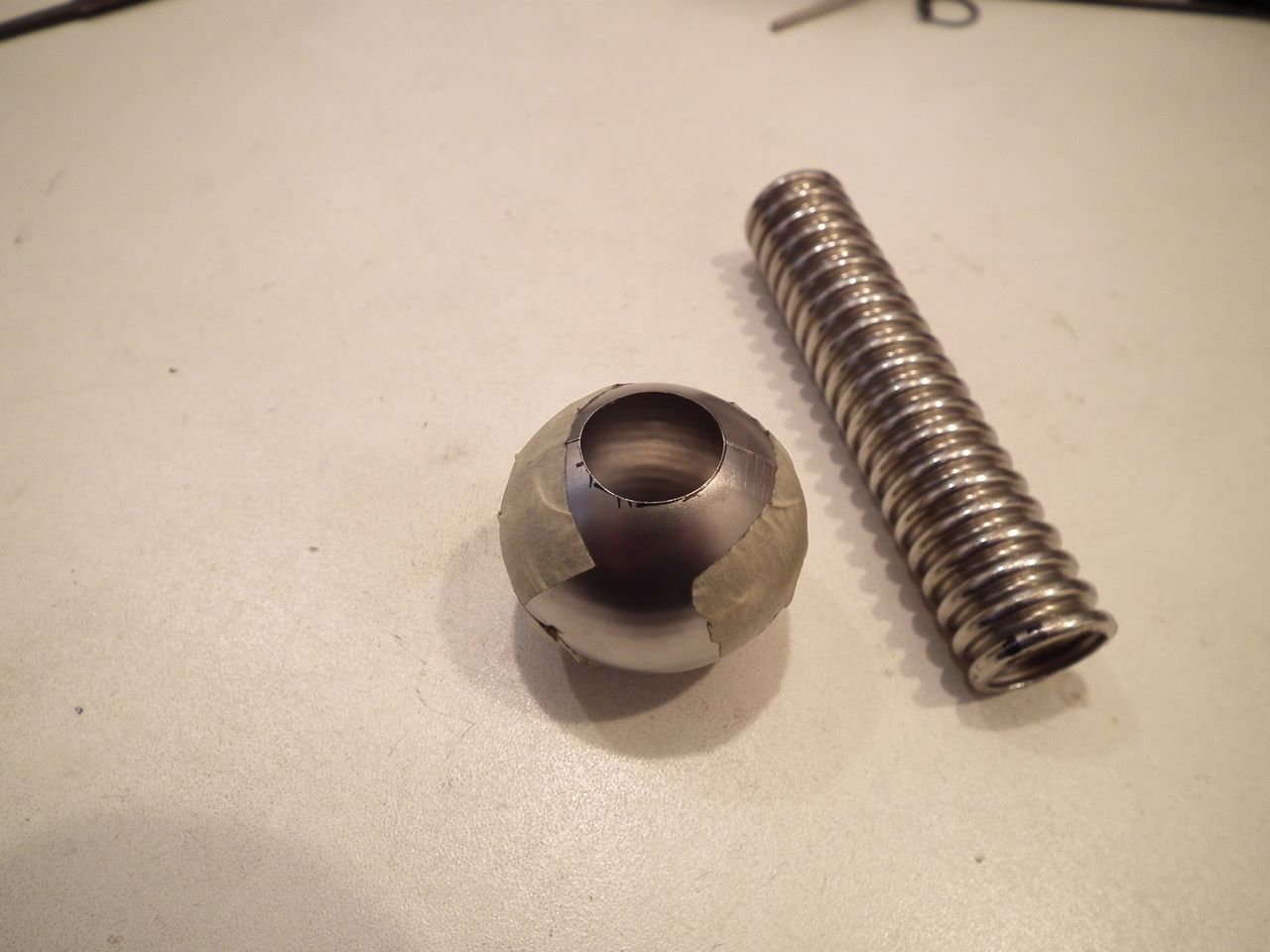

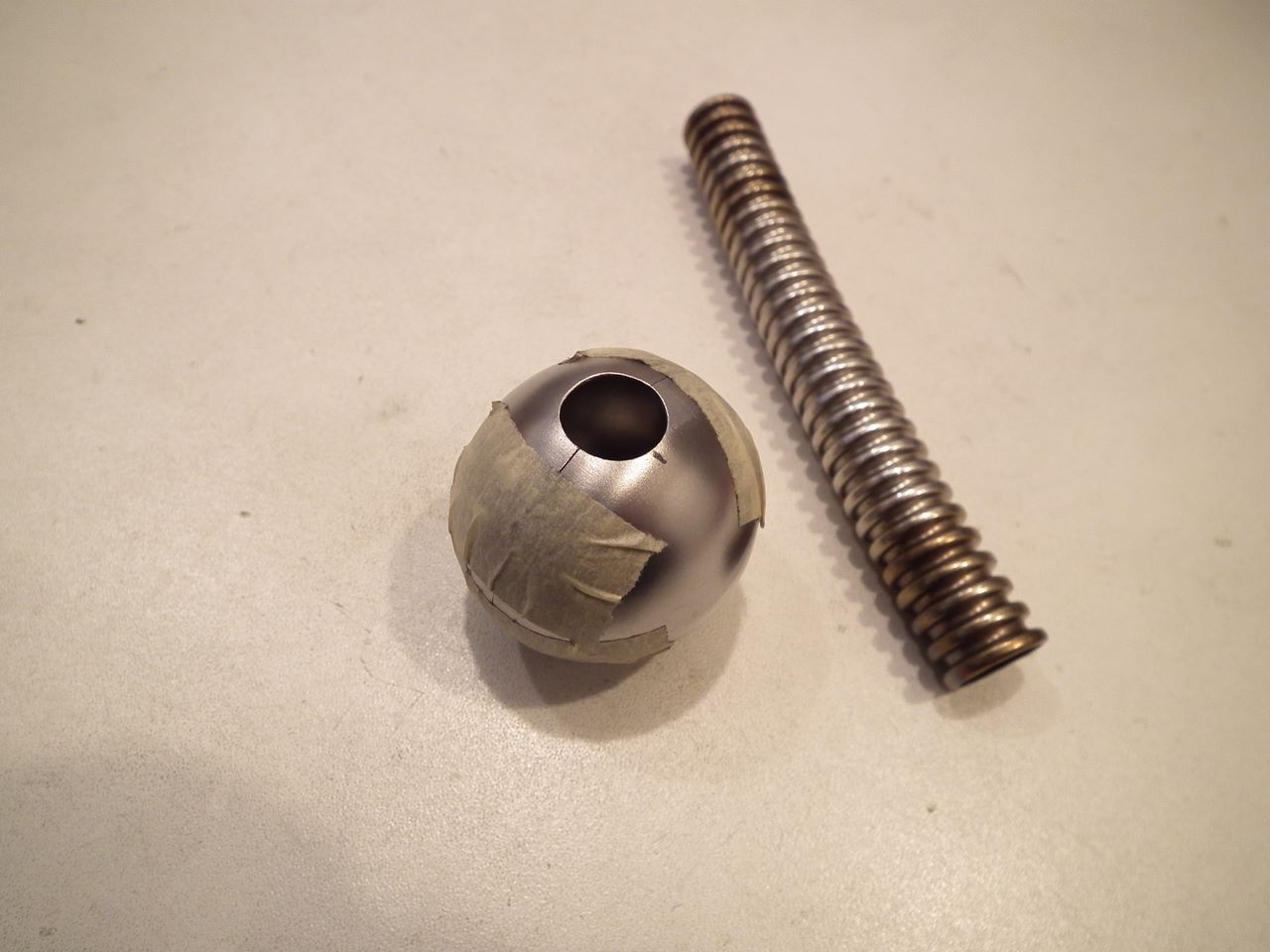

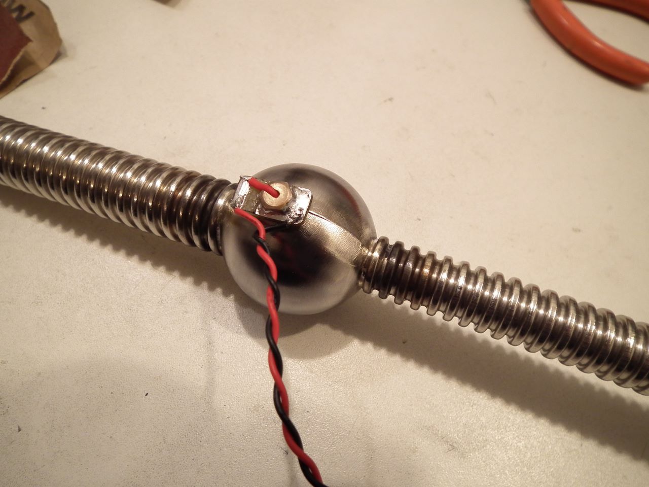

Steel initiator chamber is ready for testing! 8)

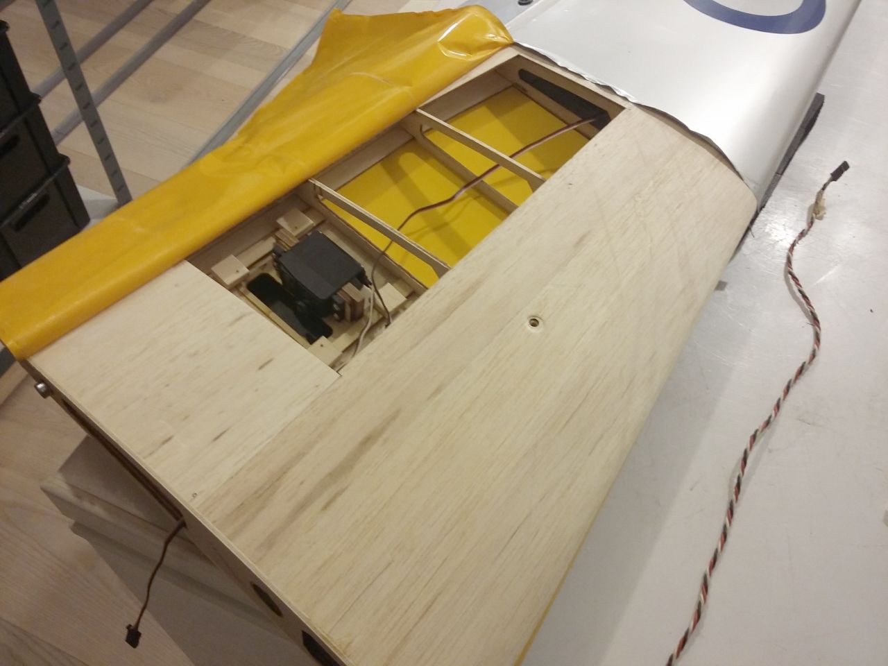

I have also started to prepare the left wing of the RC plane for sound cannon installation. A buddy of mine suggested that the main tube should be split into parts so it would be easier to install, and I see he has a point, because due to the bending of the tube, it would be impossible to install without major wing surgery, which I need to avoid. I don't wanna leave the wing weaker than before cannon install. I have some silicone tubing that I can use for the joint/joints.

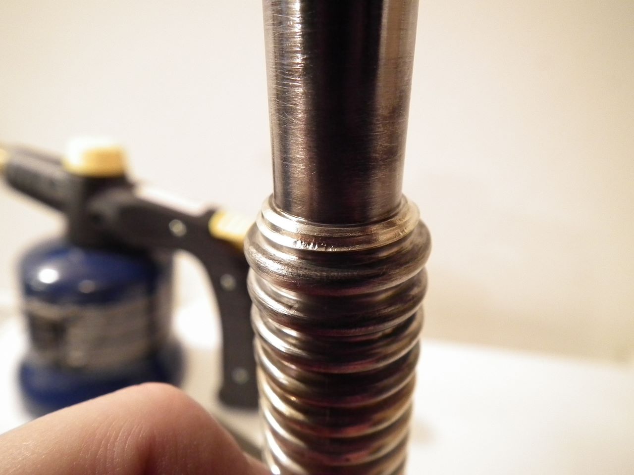

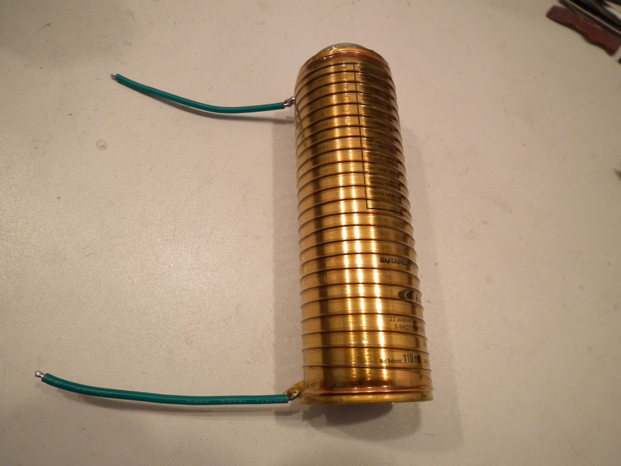

Silver soldering the parts together went OK, but I can see I need a bit more practice before it reaches my standards, but this will be fine for testing.

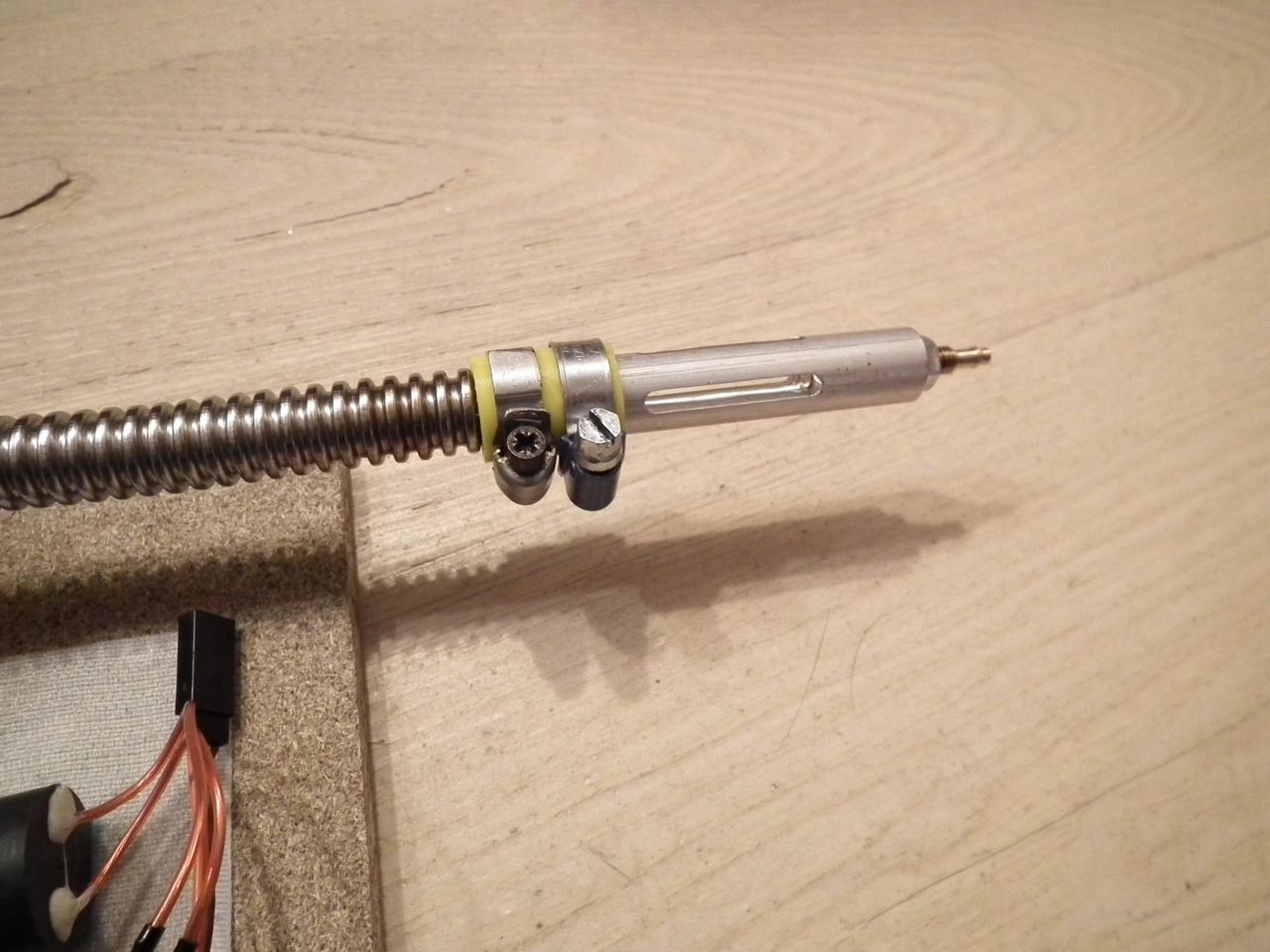

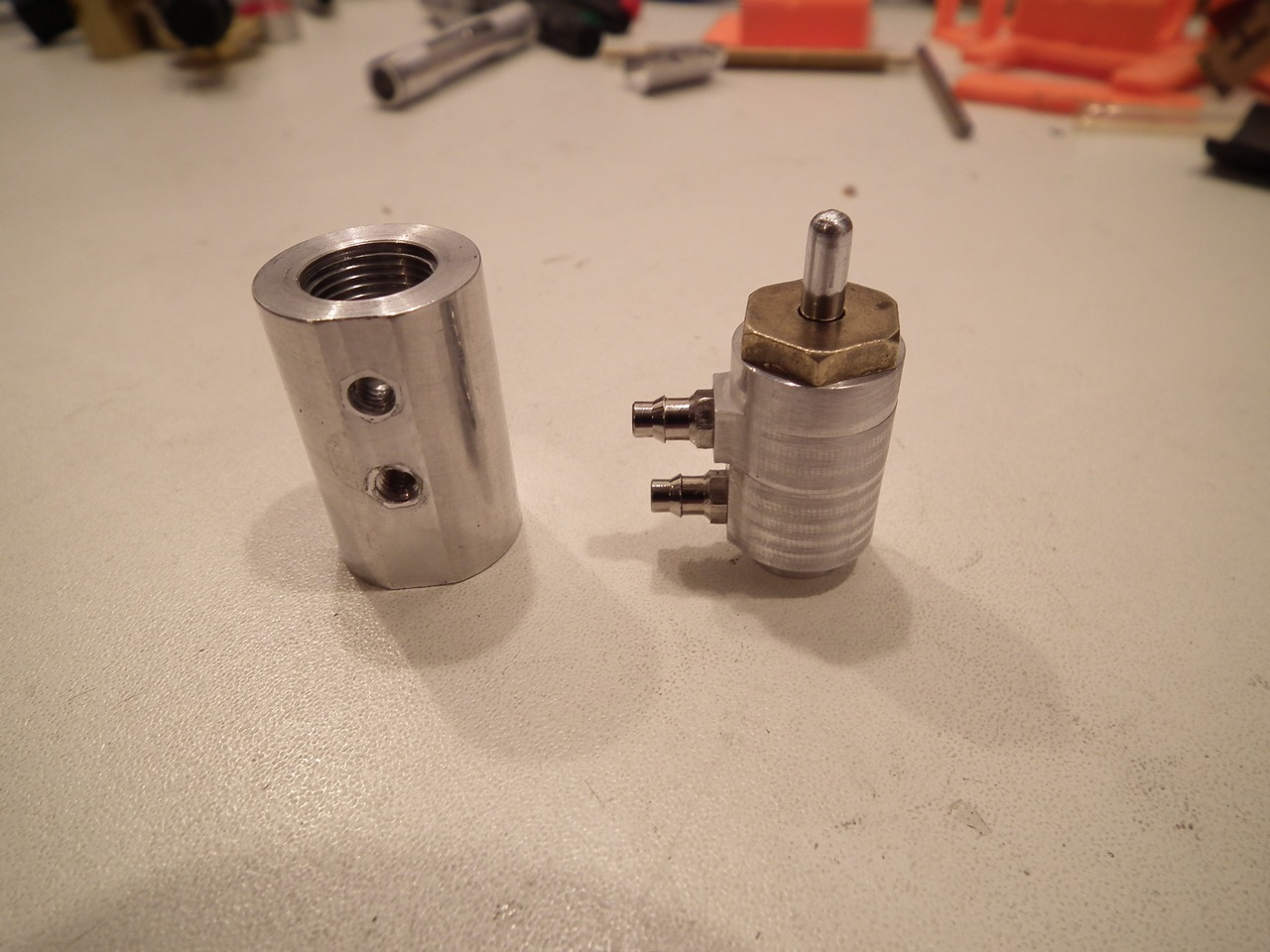

I tested the new initiator chamber a few days ago, but with 10cm extra main tube, that did not work out very well, and the 3D printed mixer keeps melting.

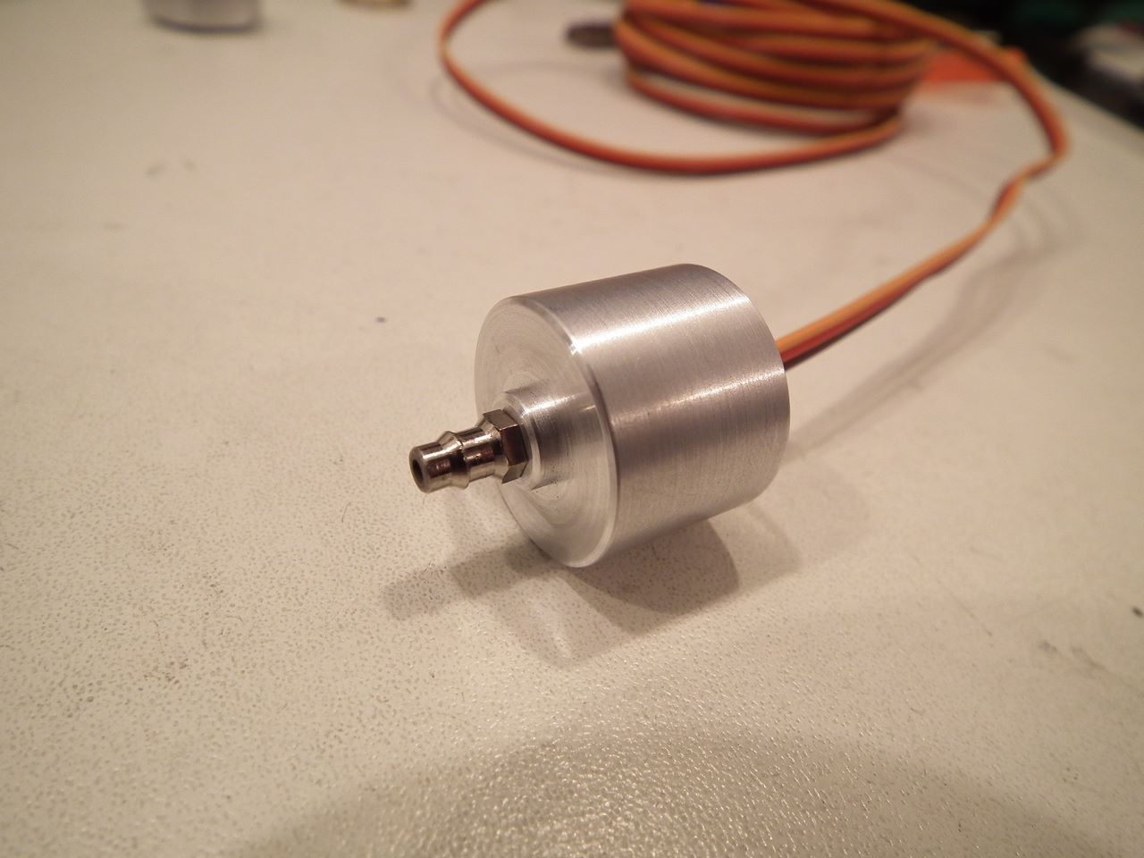

So I made a mixer from aluminium with a new brass nozzle (M6 brass rod, 0.3mm hole), and attached it to the mixer tube with a 3D printed coupling, this is temporary as I have plans on either use a piece of silicone tubing for connecting the two parts, or make external threads in the aluminium mixer and make a steel adapter with internal threads which can then be silver soldered to the mixer tube.
I also took out the extra 10cm of main tube and went testing tonight in the dark.
What a great experience!
It worked so well! And for so long too! The only part that gave up was the 3D printed barrel, this is the next part I need to make from steel and I know exactly how I want to do it.
The darkness makes it possible to see the blue flames coming out of both the intake and barrel which is really cool. The sound level was amazing and the obtainable rate of fire is good, the last testing was made at 330 shots per minute still with good consistent sound, I think this is a record! It's going to sound really cool with 2 cannons shooting at this speed 8)

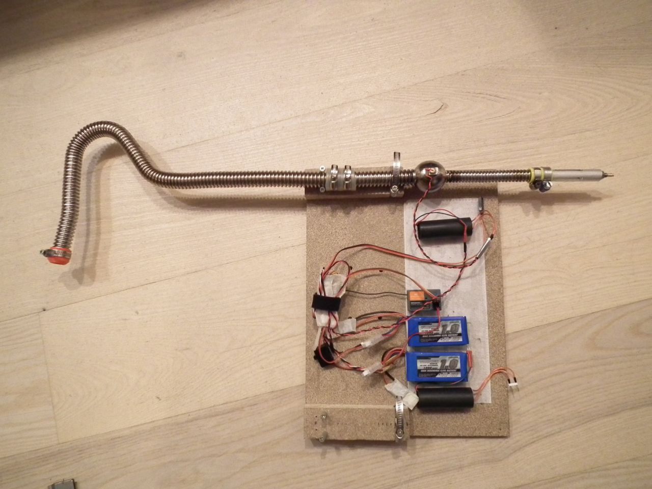

Pictures of current setup:

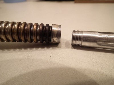

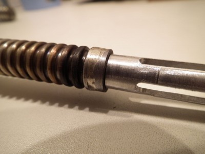

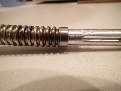

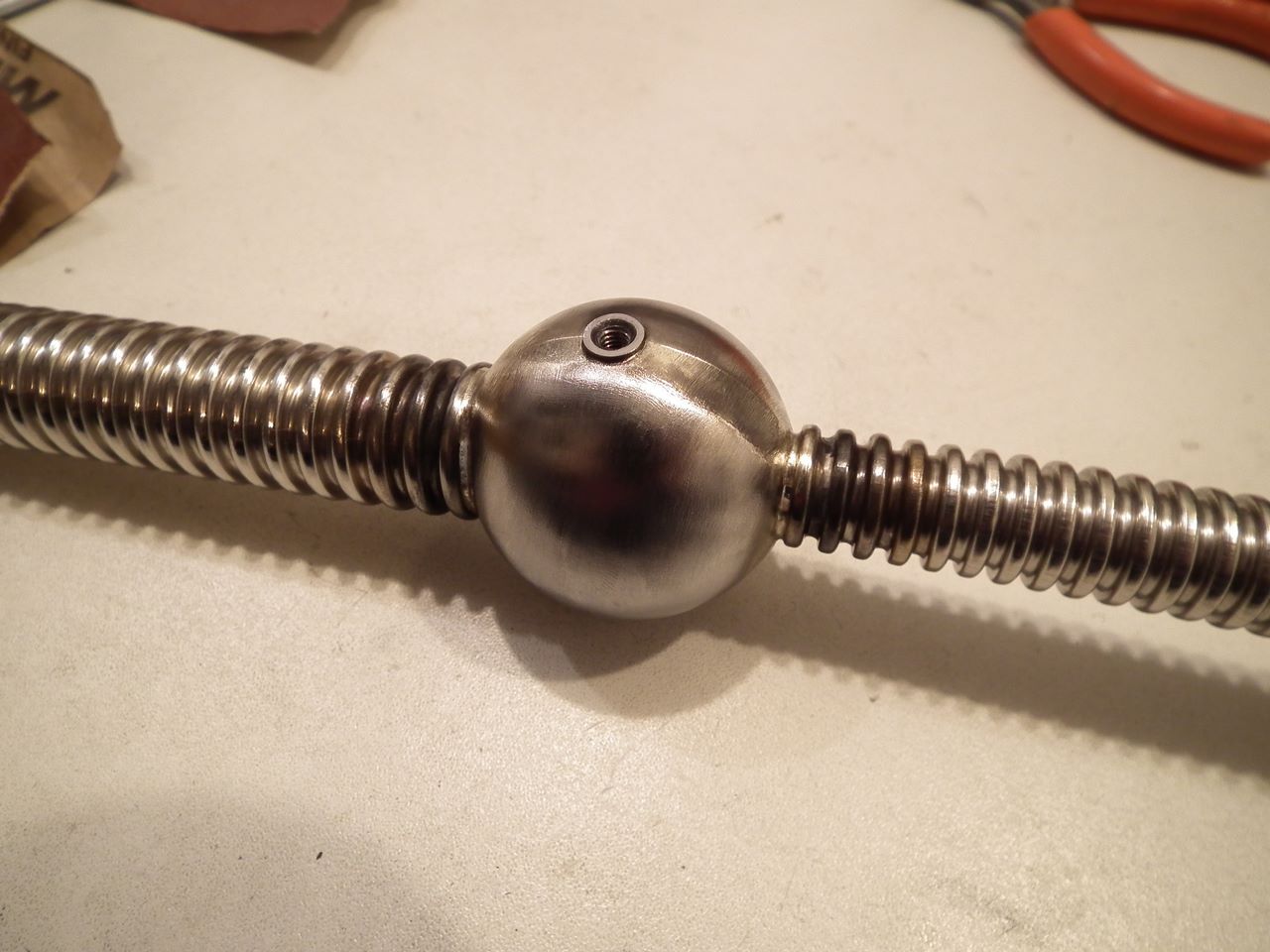

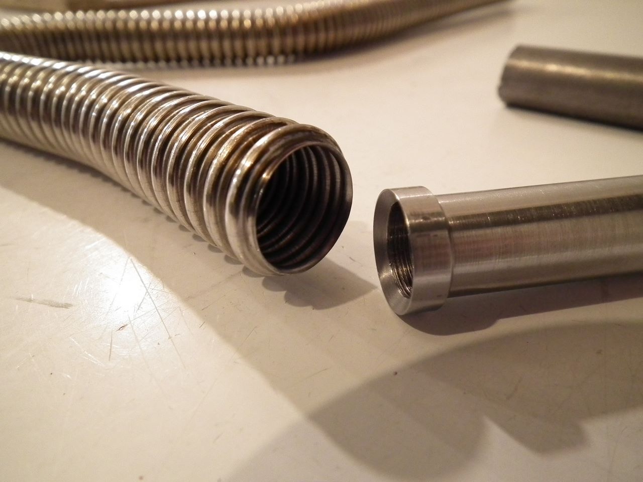

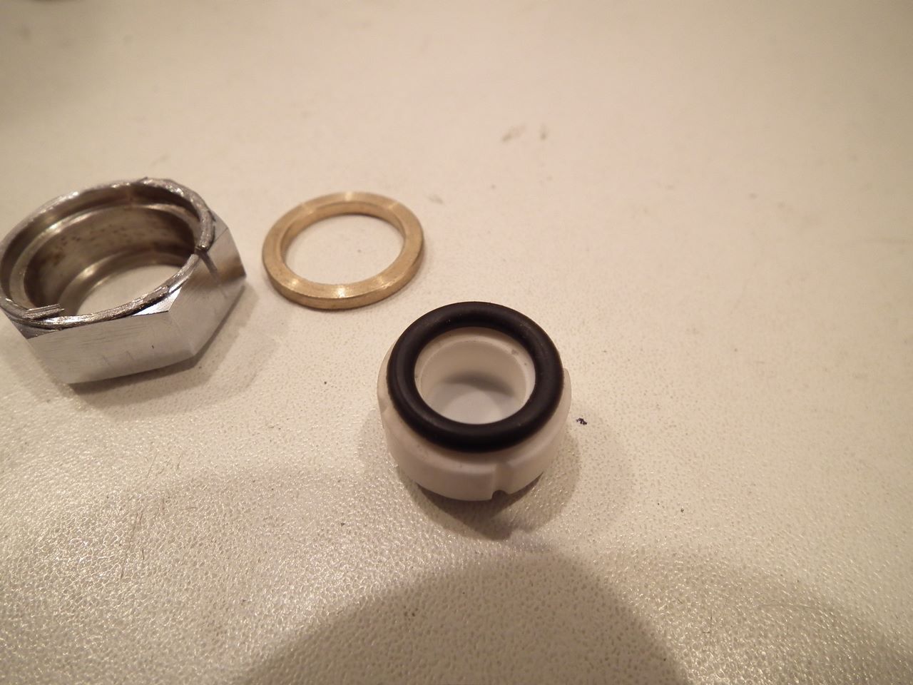

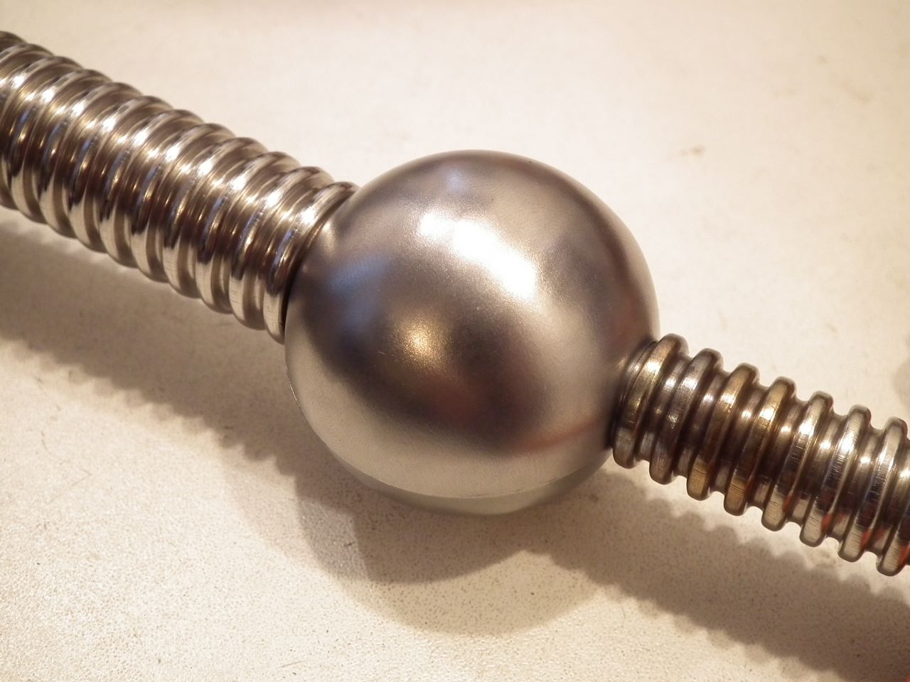

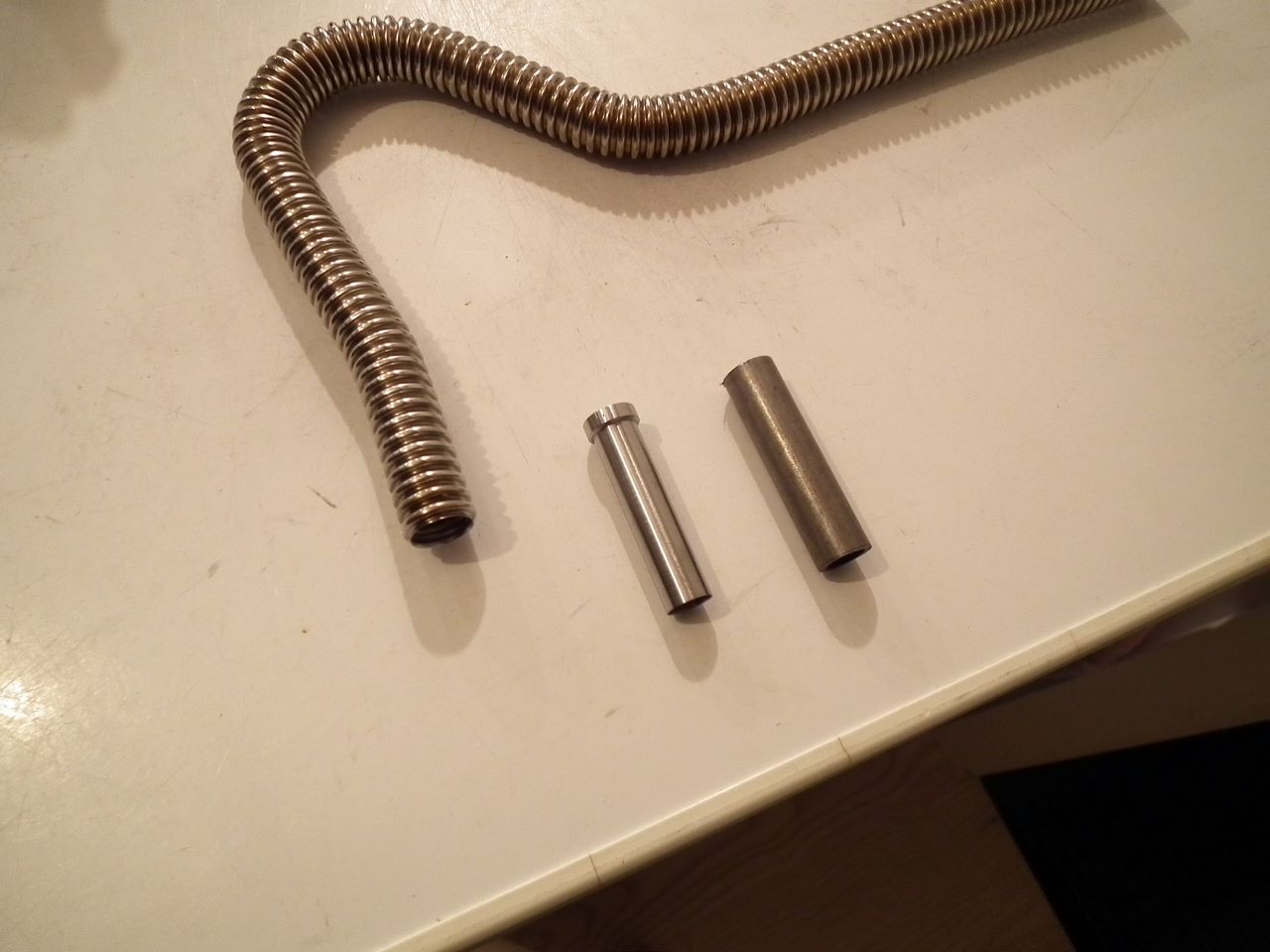

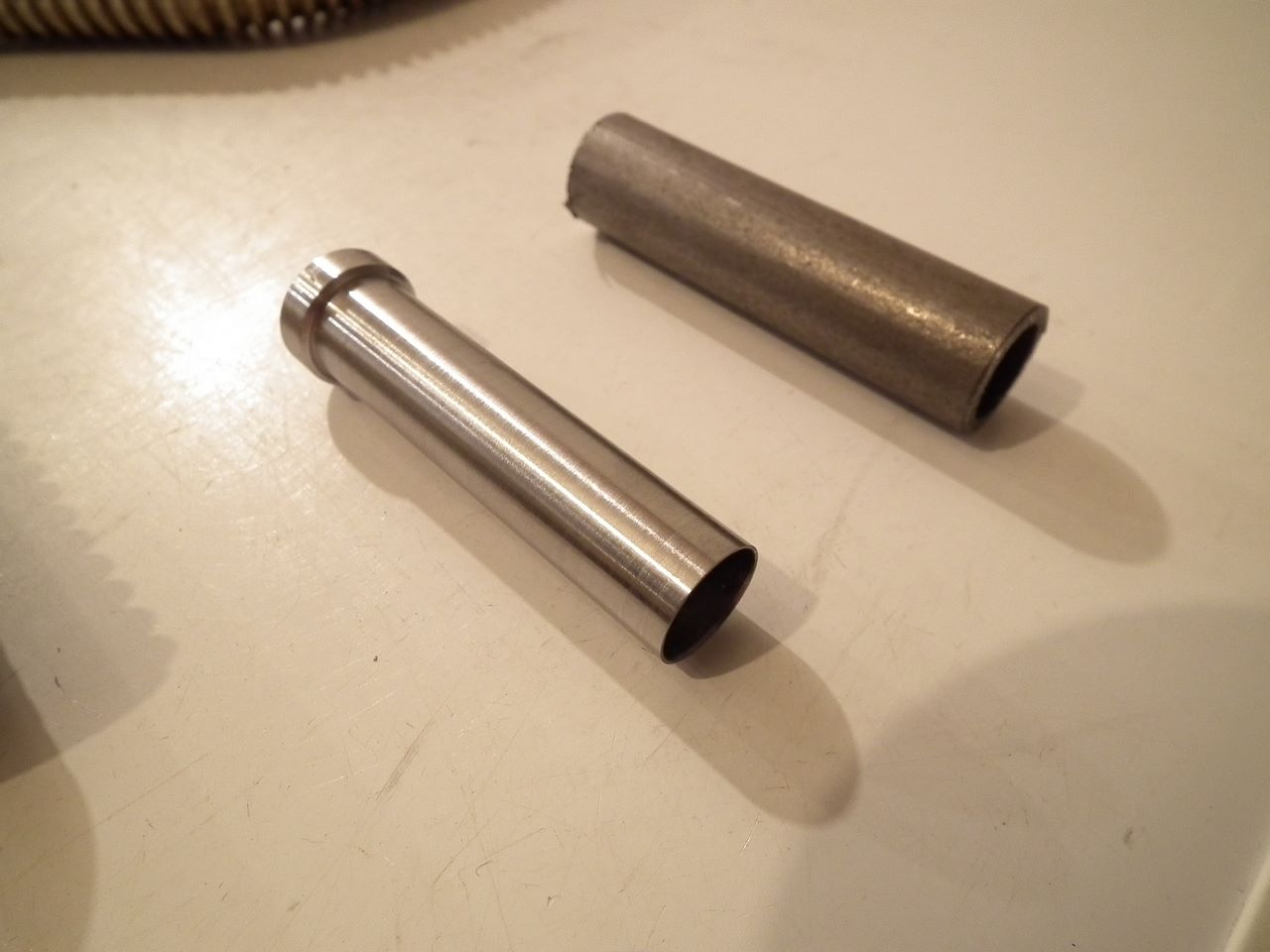

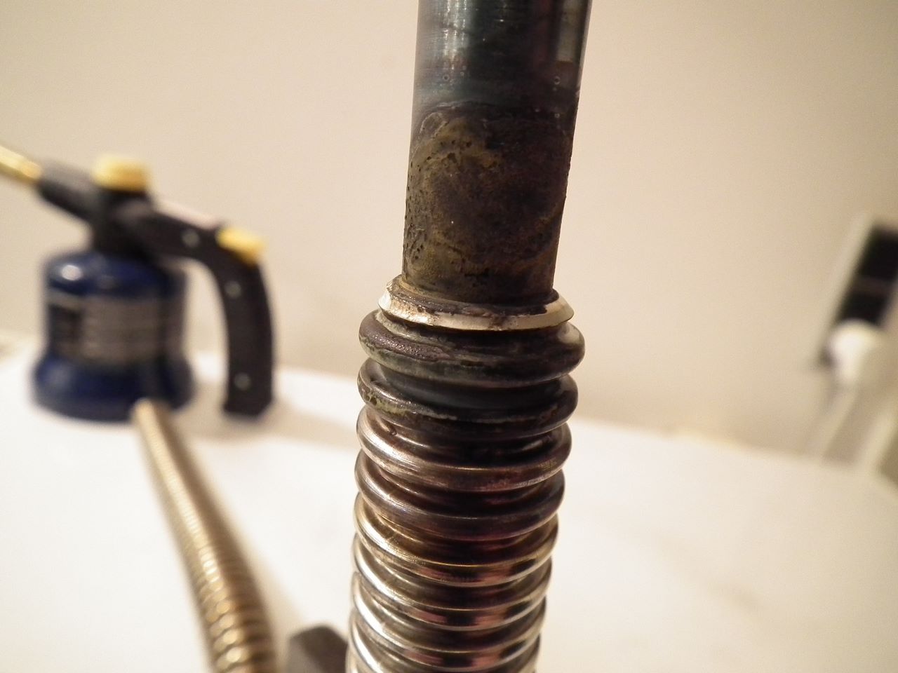

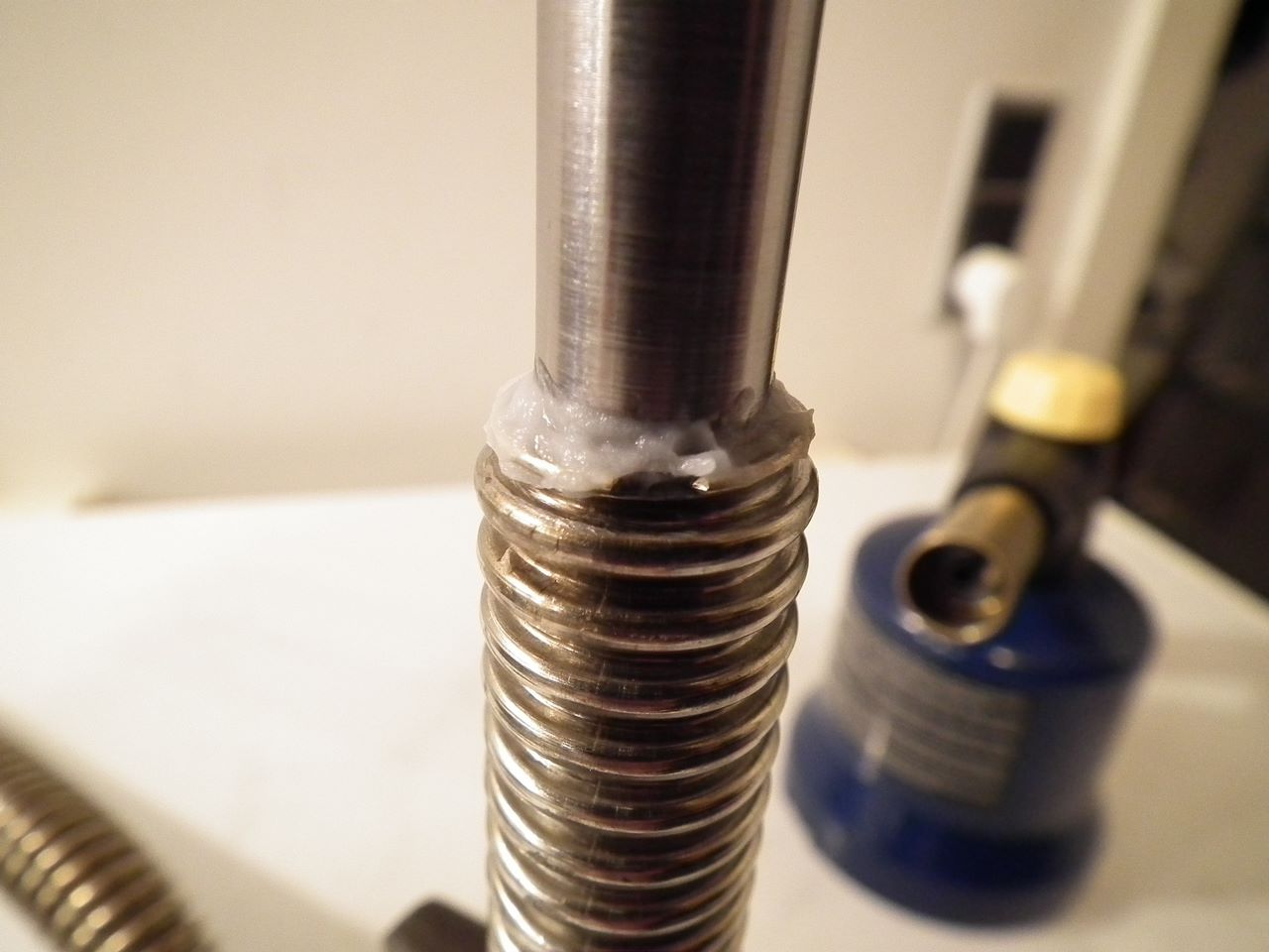

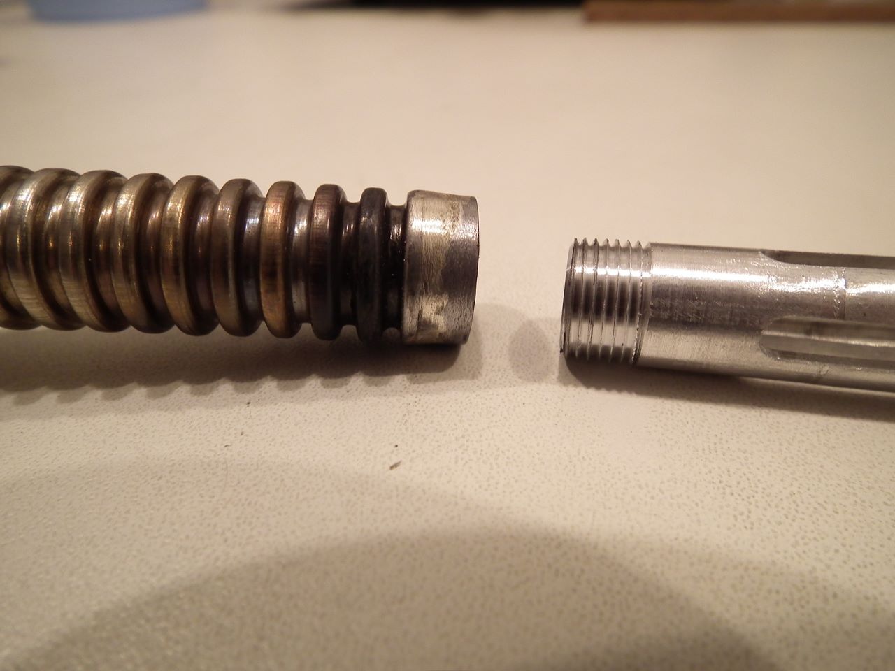

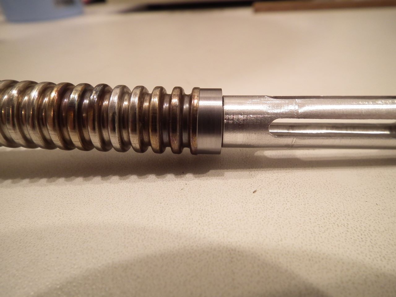

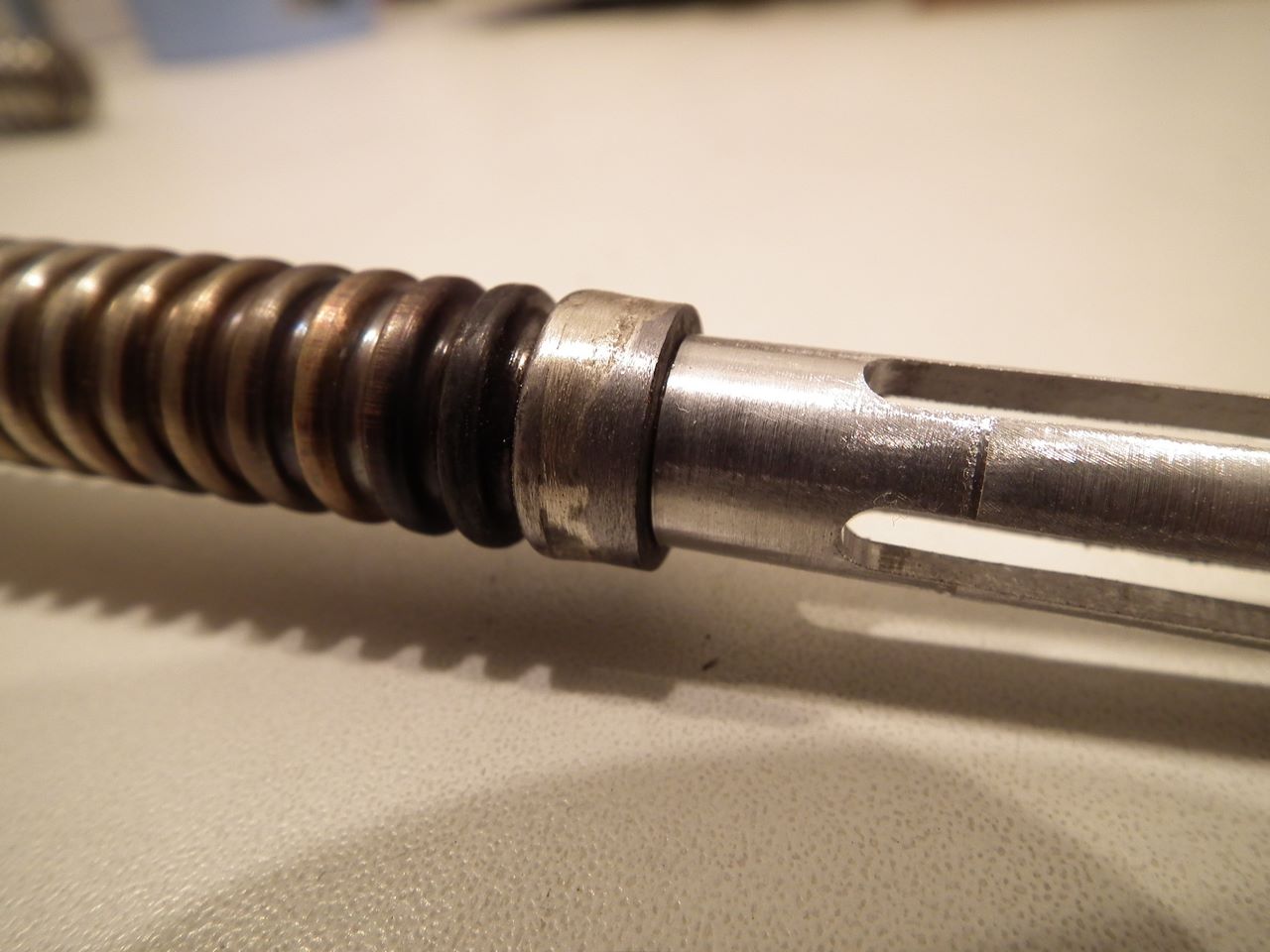

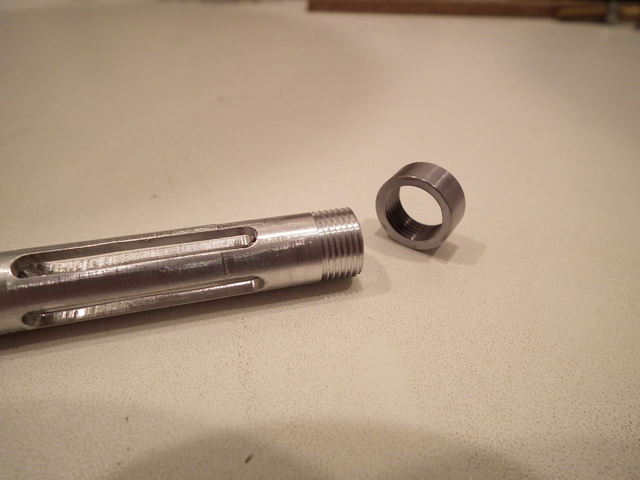

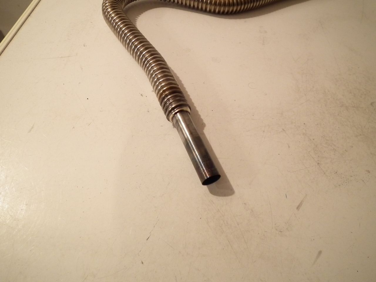

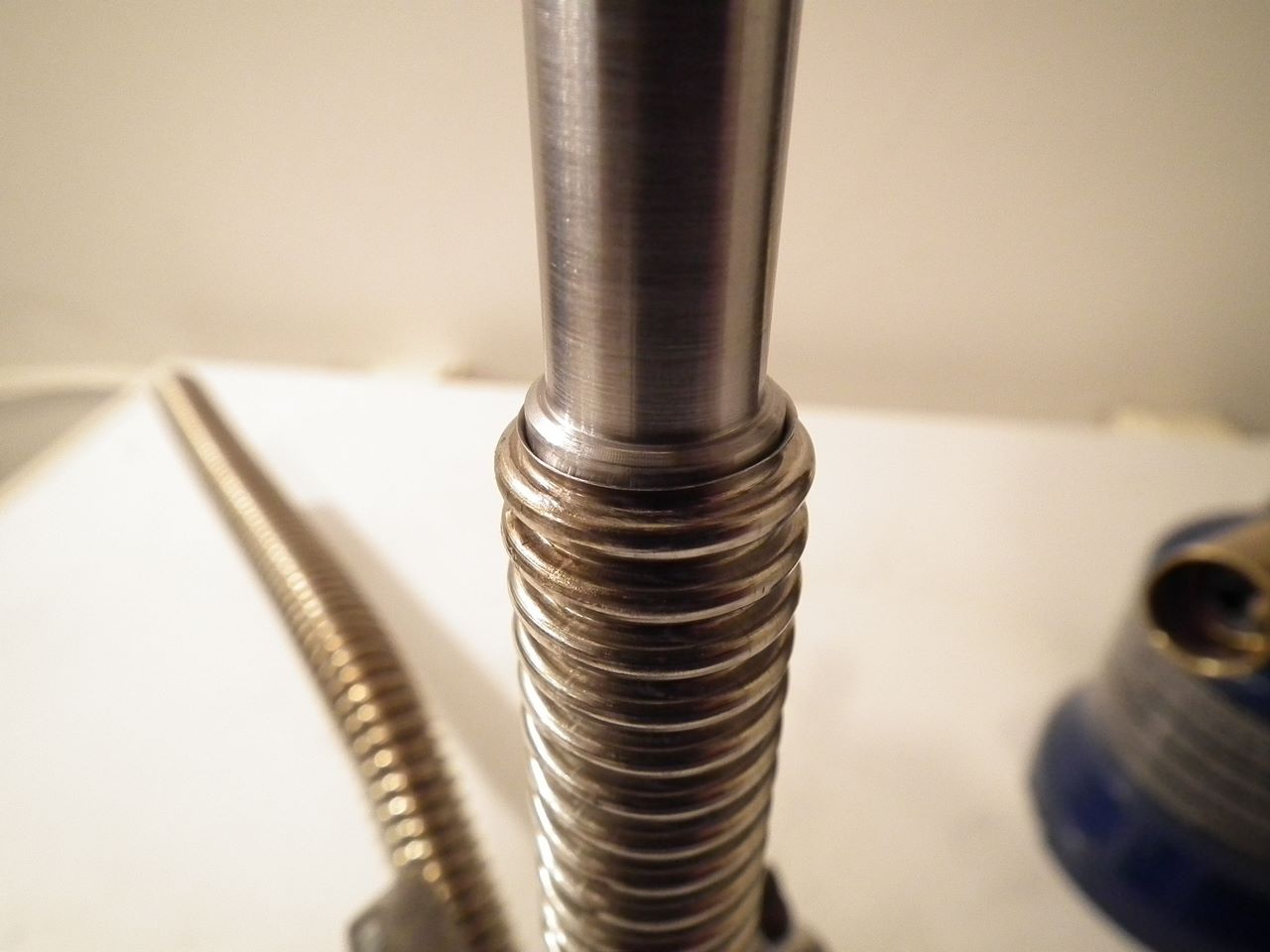

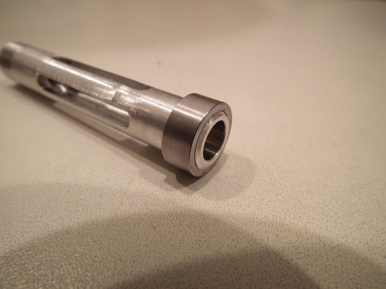

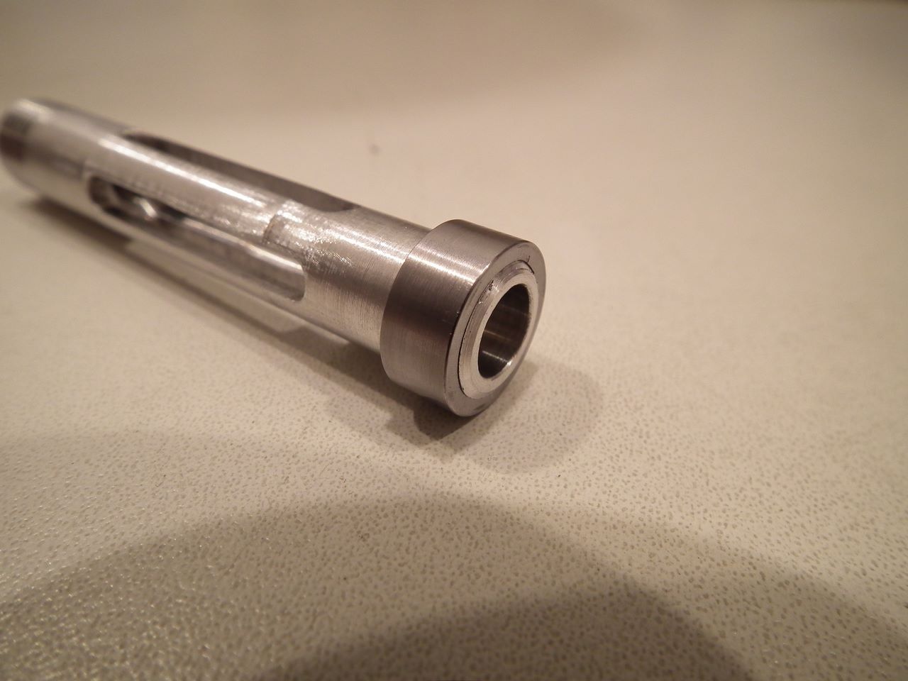

Steel cannon barrel is ready.
I tried to use the tubing from the weed burner, but its OD was 1mm too small to fit tightly inside the main tubing, so I tried to expand the end of the tube, but didn't have much success. So I went to the local plumbing store and got a piece of 3/8" steel pipe, this had the perfect OD for fitting in the main tube but needed boring to get to an ID of 13mm along with a little work on the lathe to get the OD down on the barrel itself. Final weight of the barrel piece was 11.7g.
I managed to make a pretty nice barrel with ID 13mm, OD 14mm and length 60mm. The thicker end fits tightly into the main tube so it was easy to silver solder it in place.
I'm very pleased with the result 8)
I tested the new steel barrel today, and it works flawless even though it is 50% longer than the red 3D printed plastic one I have been using up until now.
On the video I'm shooting at 318 shots per minute. I'm far enough away for not wearing ear protection, but the sound is still too loud for my phone camera mic. How can I record this with better sound, any suggestions?
Sorry, video deleted during cleanup

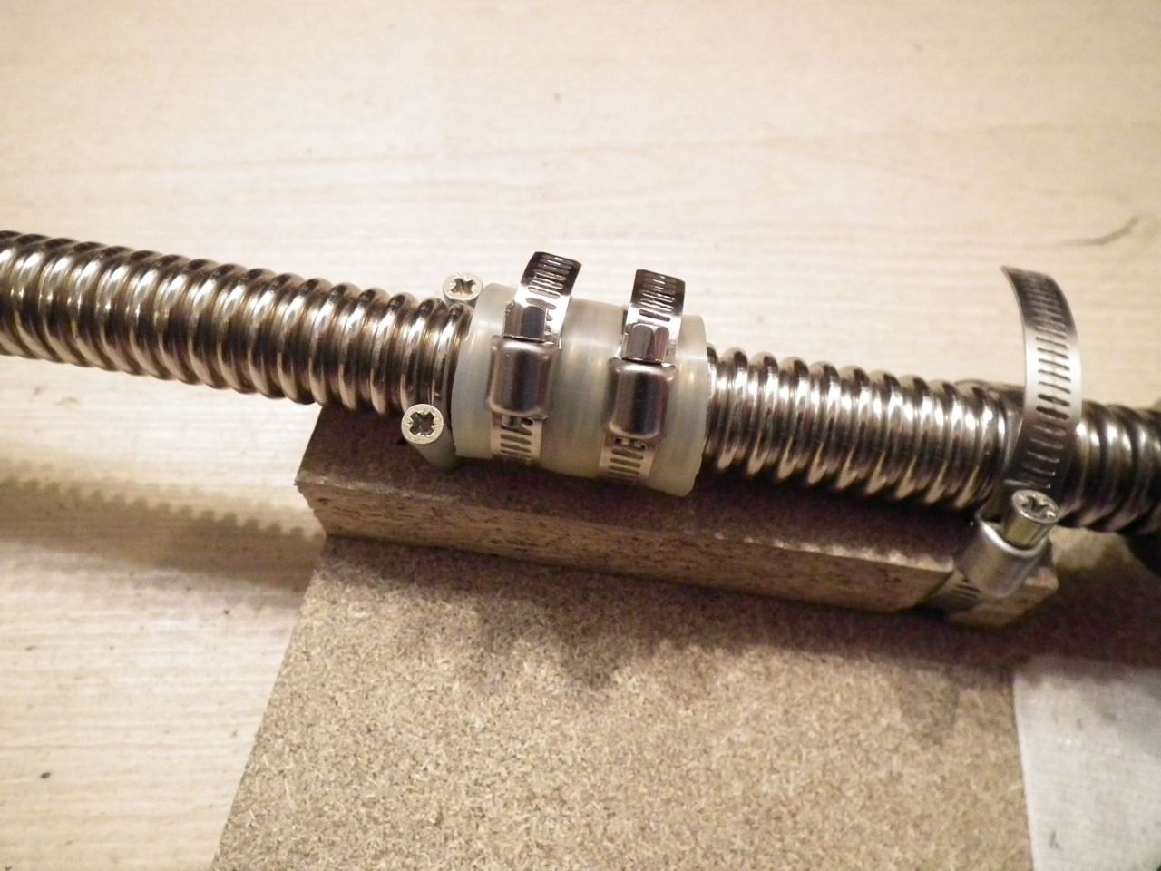

But I do have some update though. I have long been thinking of the best way to attach the aluminium air/gas mixer to the corrugated mixer tube, and had a few ideas but now I tried one out. The test mixer is turned down from 15mm to 12mm. A M12x1.0 external thread is made on the mixer end, and a normal M10 nut was made into a steel adapter with tapped M12x1.0 internal thread. The adapter is silver soldered to the corrugated mixer tube. This seems to work just perfectly, it takes up almost no space, is lightweight and can easily be disassembled during mounting. The mixer is just a test, the final mixer will be optimized in size/weight when I know the final dimensions.
Seems to be weather for a test run tomorrow

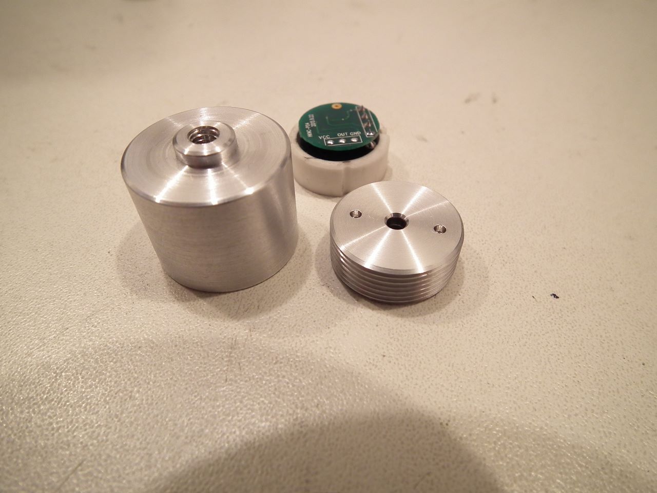

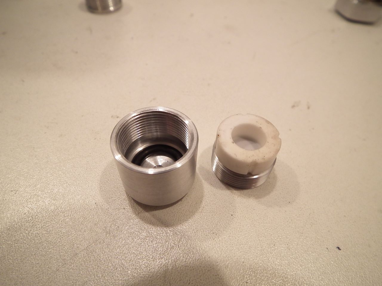

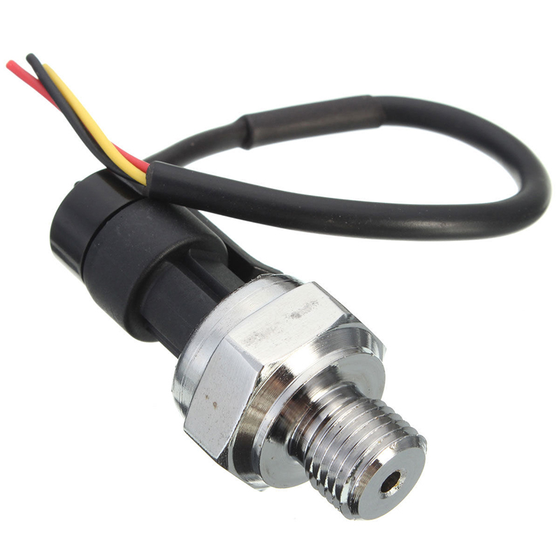

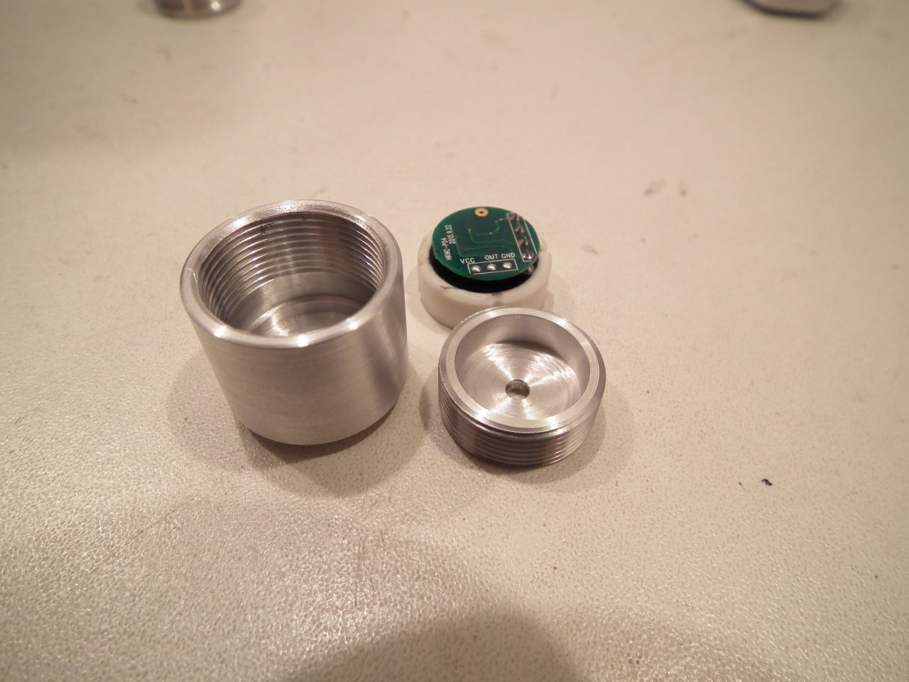

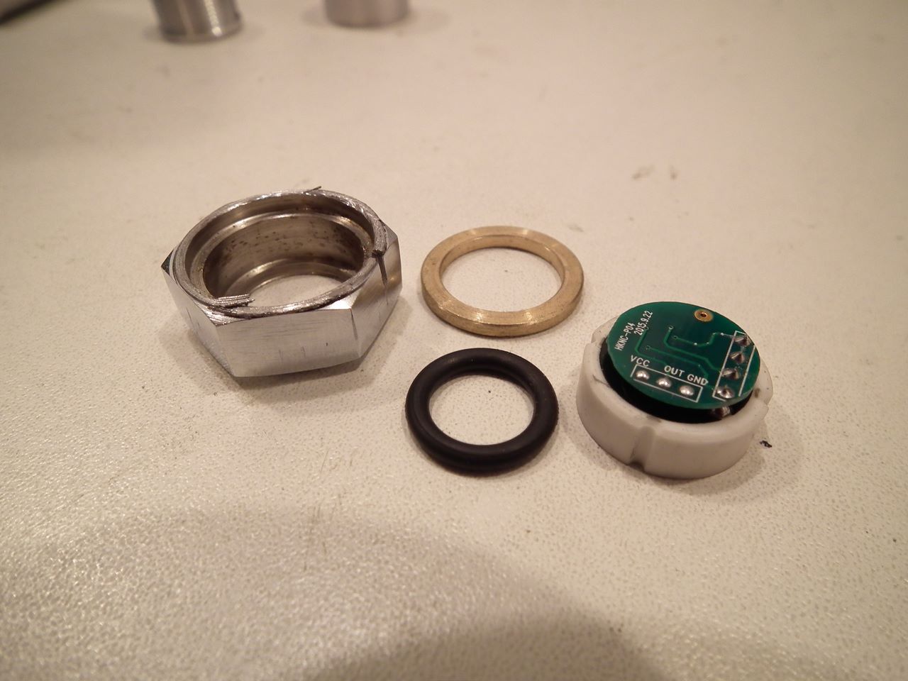

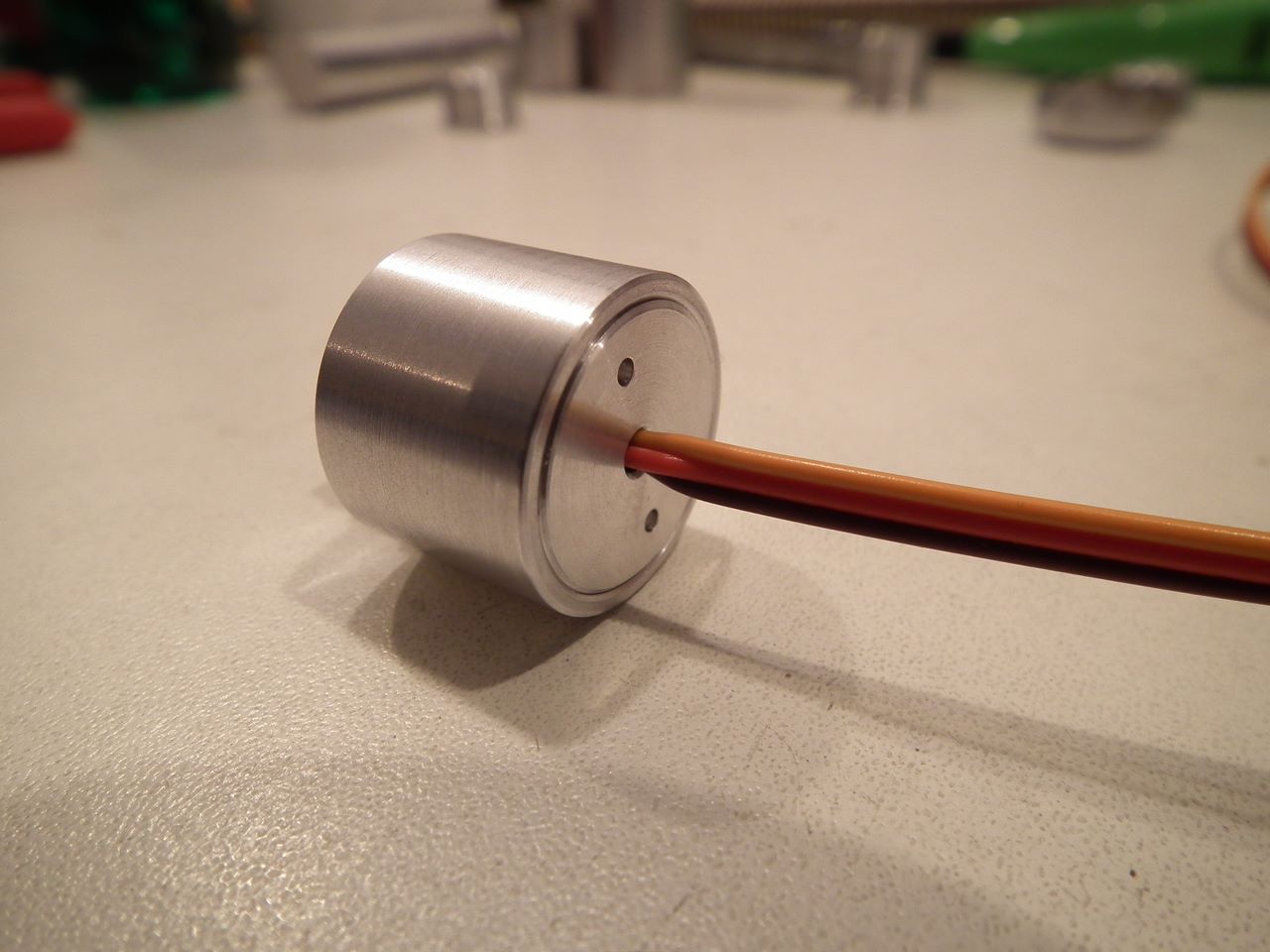

Another thing I have been tinkering with, is a propane pressure sensor. The sound cannon is sensitive to a change in propane pressure which means that I need the full pressure of 9bar/130psi every time I shoot it, otherwise the sound will suffer due to the fast shooting. Since I'm using a very small propane canister, it's temperature (and pressure) will drop significantly when consuming propane. So I have wrapped the propane canister with kapton tape, which is electrical insulating but transfers heat pretty well, and then wrapped some 0.5mm untreated black iron wire around it, acting as a heating device. Power for heating will come from a small 1000mAh 4 cell LiPo battery.
The sensor will then monitor the propane canister pressure, and when pressure drops due to consumption or cold weather, it will turn on the heater until pressure is restored. I will also add a temperature sensor to limit the max temperature on the propane canister.
I'm also thinking of remote readout of the propane pressure, this way I can monitor max pressure on hot summer days and also see if the pressure drops rapidly indicating an empty canister. Maybe I will even make a two-way WiFi communication between sound cannon and smartphone, this way I could adjust rate of fire remotely and change settings on the propane heater e.g. on winter days I might settle for a lower rate of fire which decreases the demand on propane pressure and lowers heater battery load by allowing a lower pressure and temperature on the propane canister.
Anyway, the only affordable sensor I could find that can measure at least 10bar/145psi, is a G1/4" inch 5V 0-1.2 MPa Pressure Transducer from ebay. This is a very big and heavy sensor with steel housing, so I took apart the sensor housing and made a new small and lightweight aluminium housing for the sensor element. I also added a hose input nipple of the correct size. The internal/external threads were the big challenges as they are a custom size, and this was my first attempt at making internal threads on my lathe without a thread tap. It turned out perfectly at 22mm diameter, 19mm length without nipple, weighing only 17g! 8)

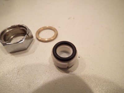

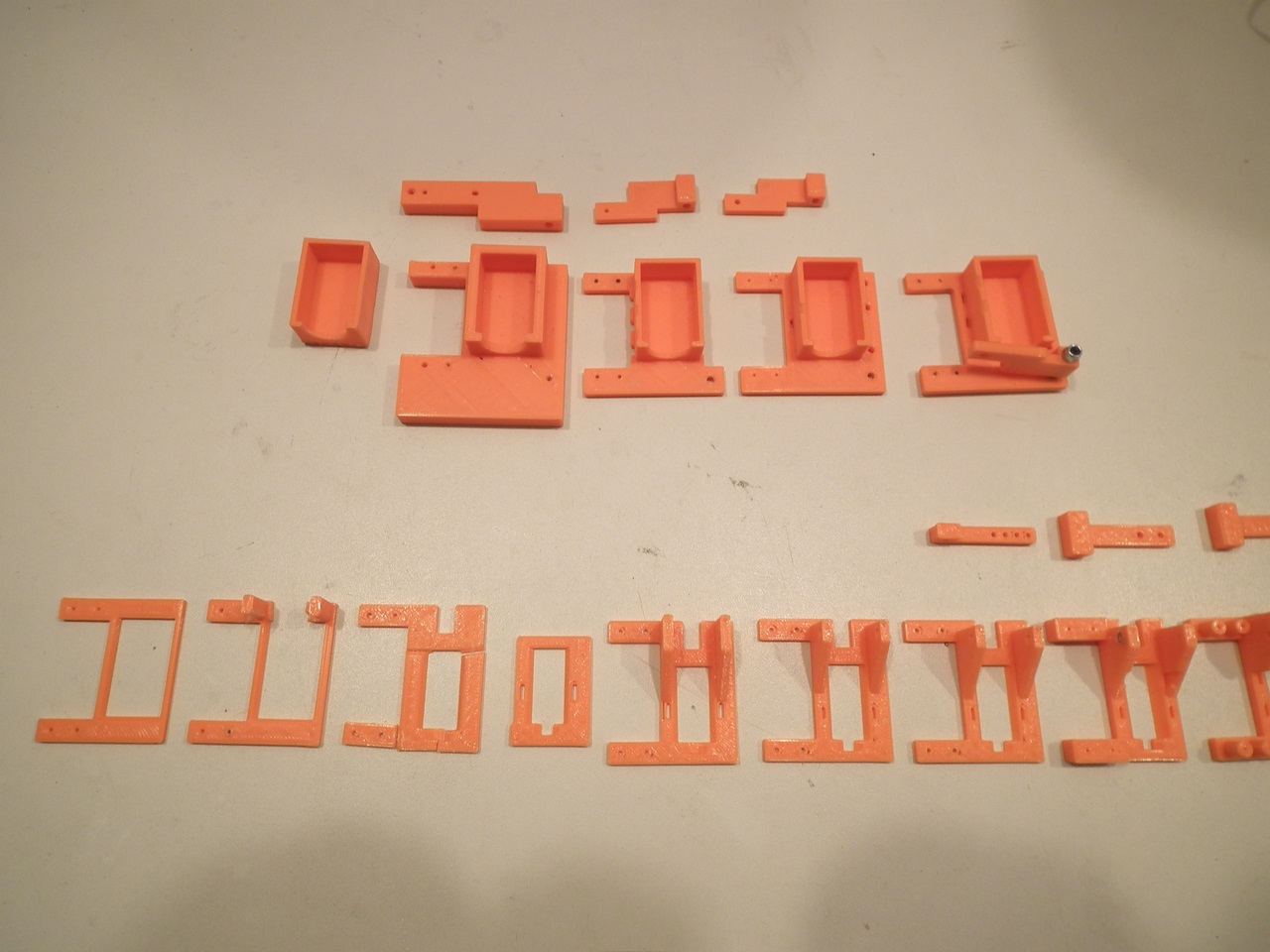

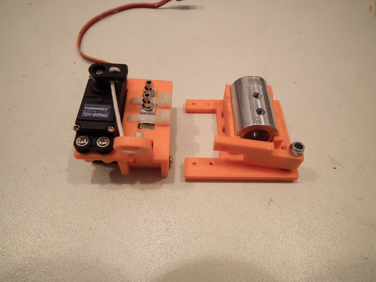

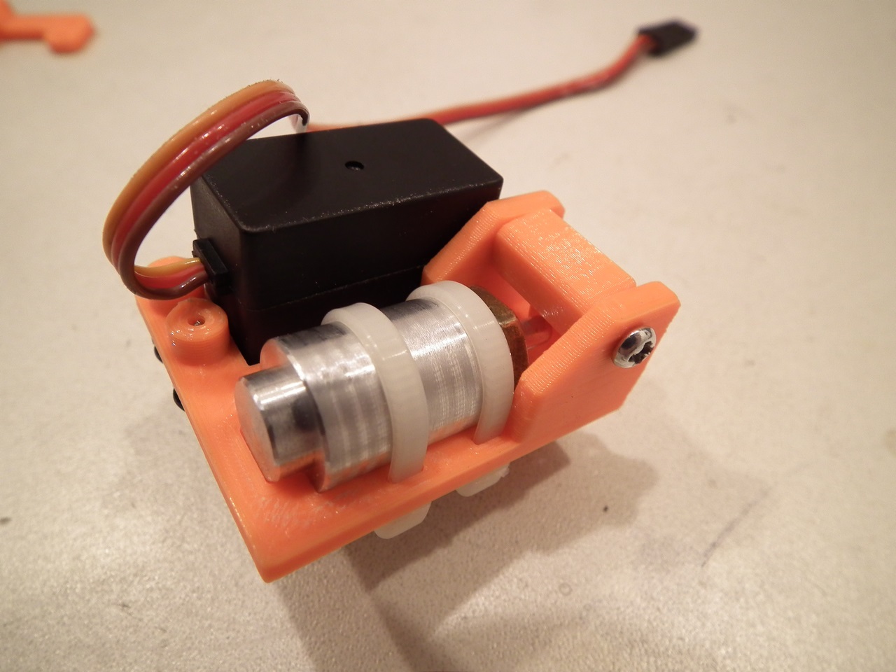

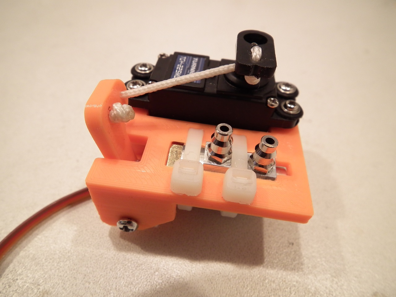

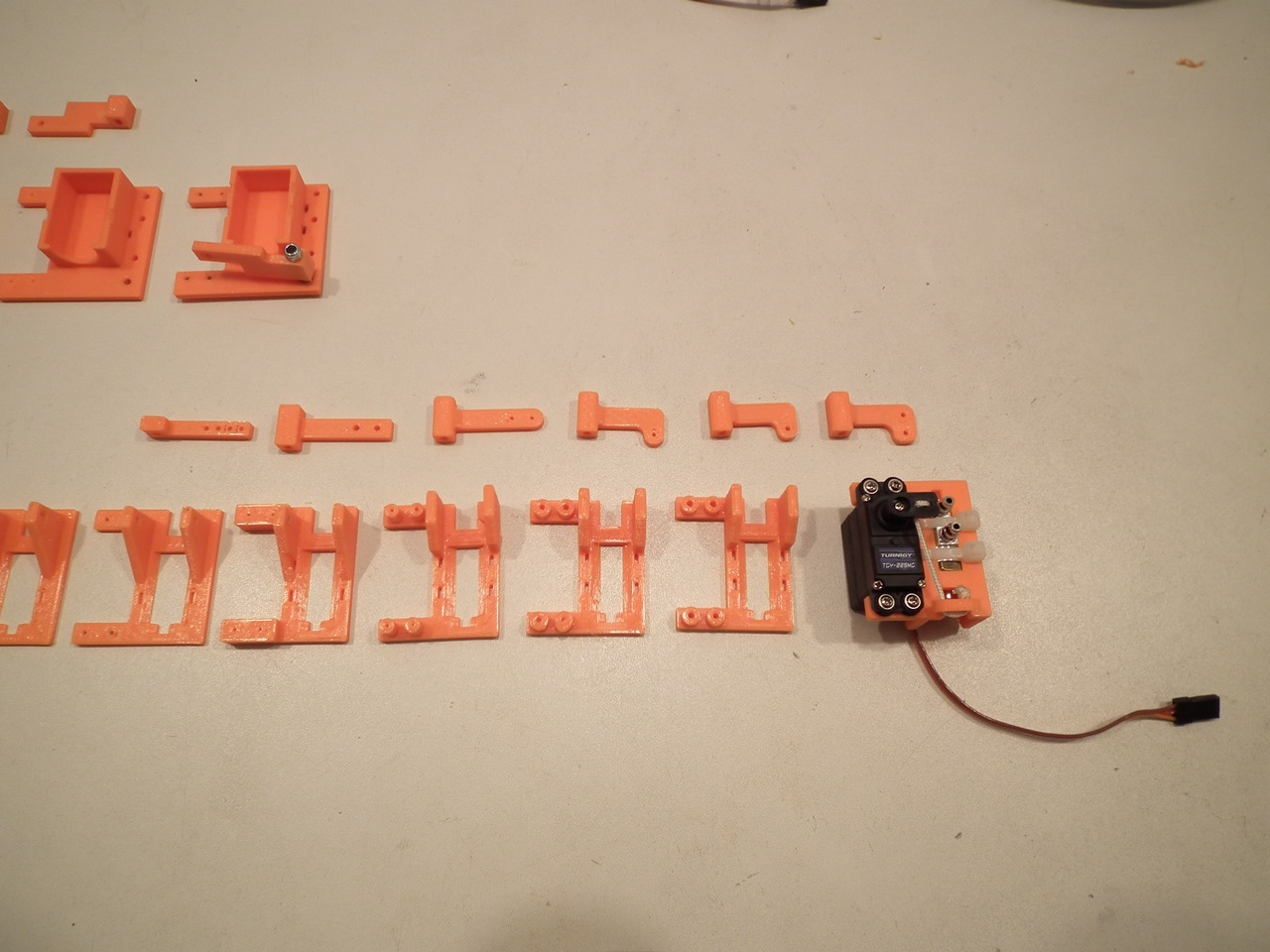

I couldn't help myself, so I built a new open/close valve based on the same principle as the last one, but this time stripped for un-necessary weight from the aluminium, and with a shorter home-wound return spring. A new attachment for the RC servo is also underway.
During development of the valve, I made a mistake on one of the housings, so I cut it open to show the inner workings, and I got a short video out of it 8)

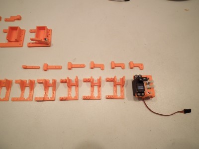

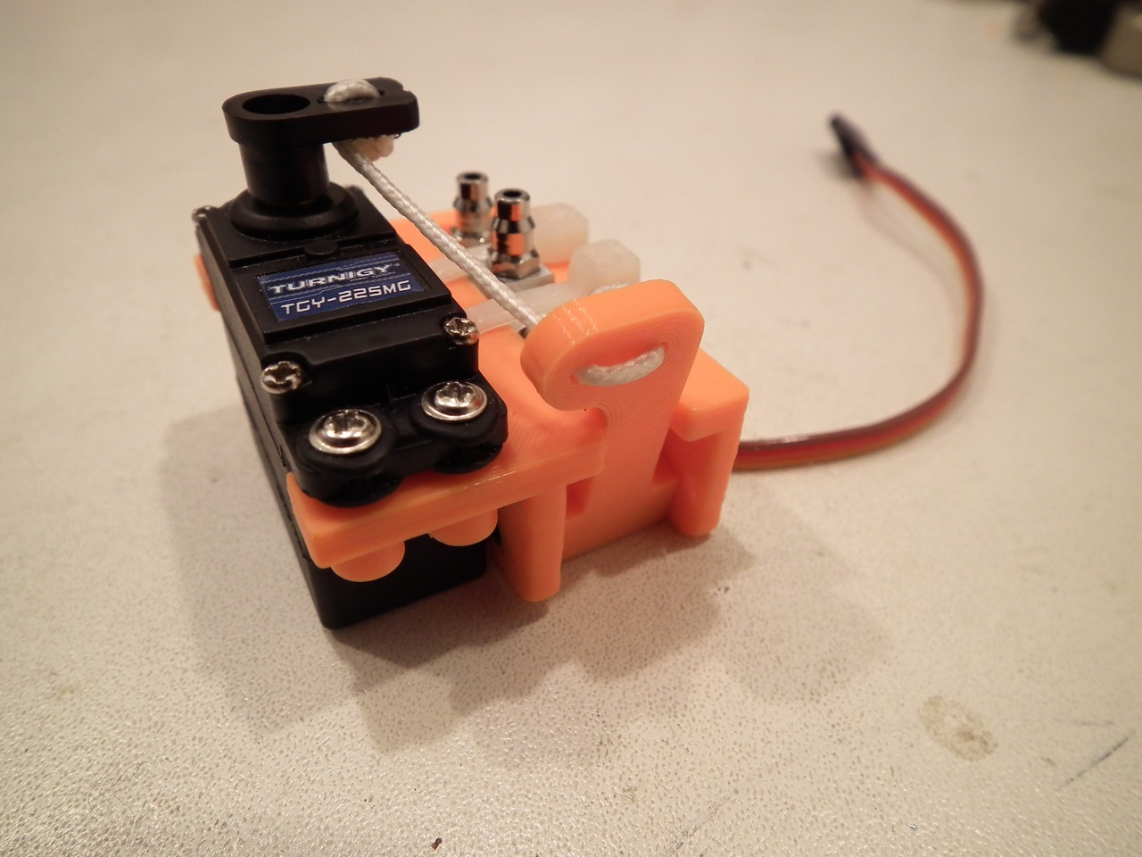

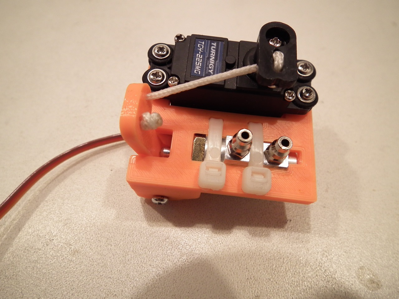

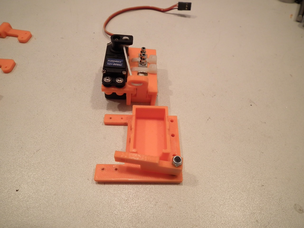

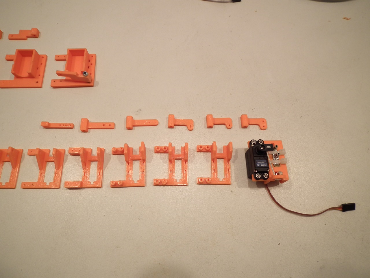

Propane open/close valve V2 is now done!
I shaved 47% off the weight (not counting the servo) and also got it more compact for easy installation in the RC plane. It's now down to 52g where the RC servo is half of the weight. The valve itself was 30g, now 15g. The servo seems reliable and strong, so I don't want to replace that for saving additional weight.
New nitrile O-rings were used for a tighter seal all around in the valve. New design 3D printed mounting arrangement was developed - it didn't take THAT many revisions
The valve is mounted lower compared to the servo. The overkill steel wire was replaced with nylon cord. Servo mounting screws got a tube for hiding the sharp point of the screw (could rub on servo wires).
I'm not sure how I want to mount it in the plane yet. I'm thinking double sided tape on the side of the servo and a wire strap around for safety. There is no clearance for the wire strap now, but I can print a new holder if that is the method of attachment I choose.
