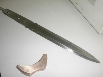

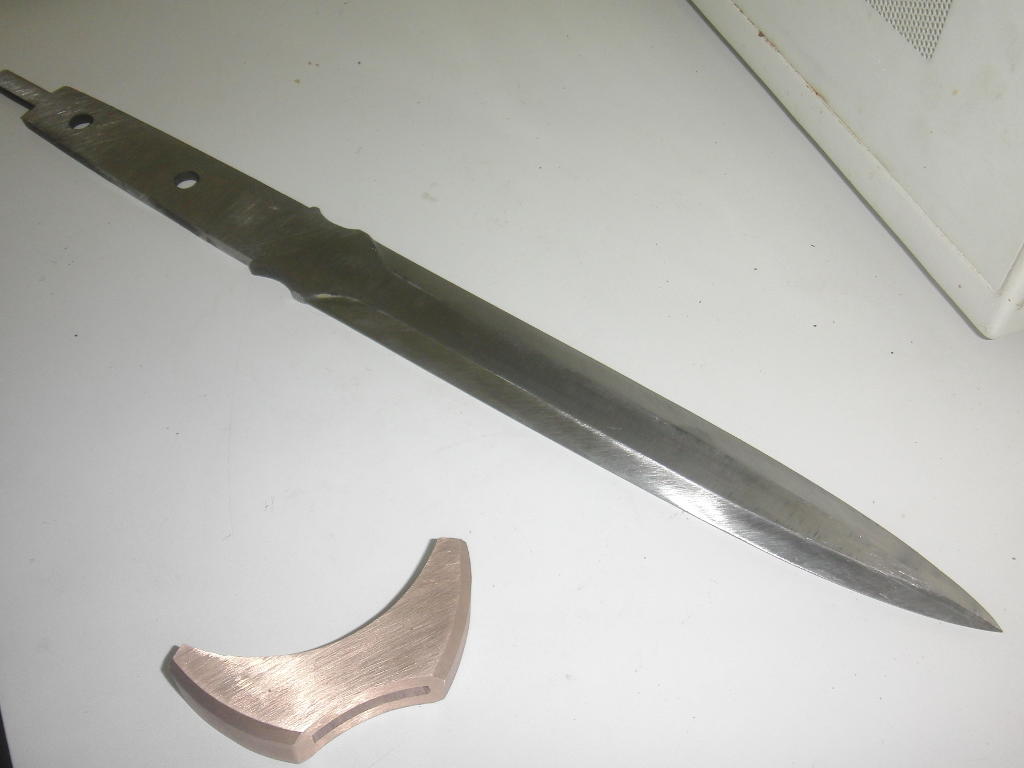

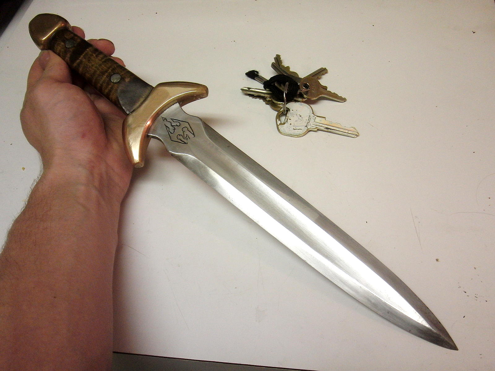

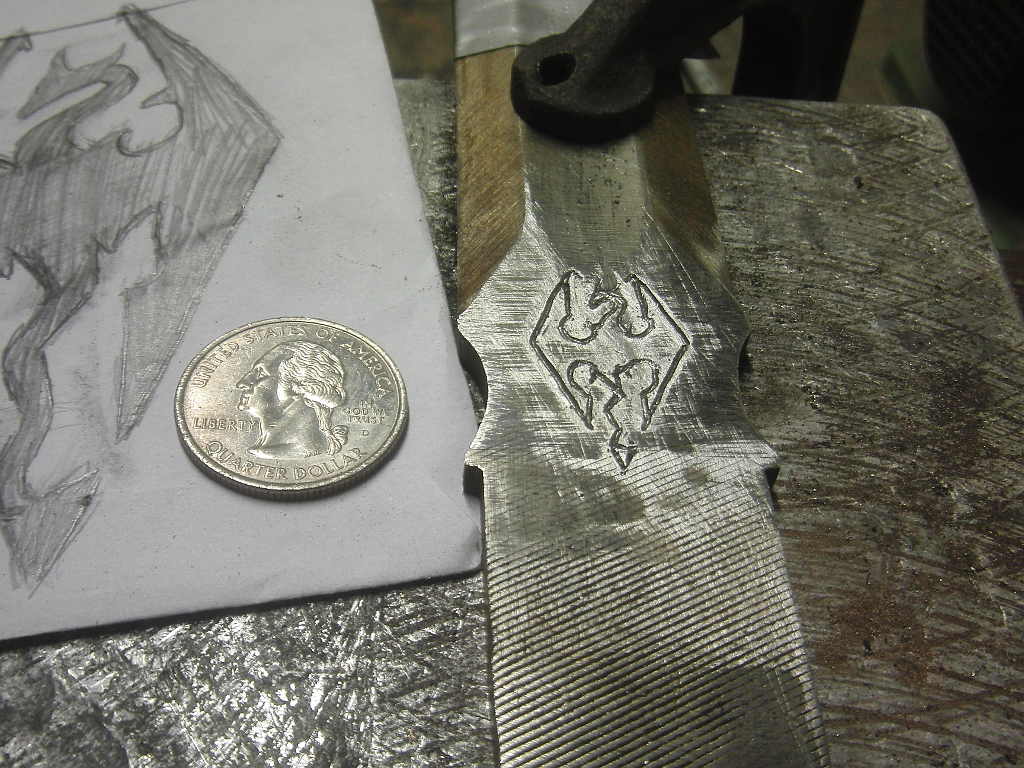

Edit; to make this post more useful, here's something relevant I made a while back.
(what, you didn't think I'd been doing nothing at all while I was away, did you?)

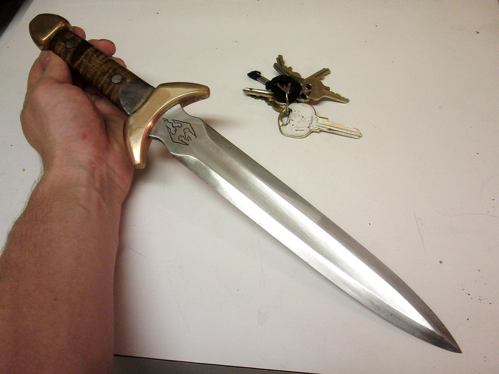

Total length ~ 16 inches
Rough edges were done with an angle grinder

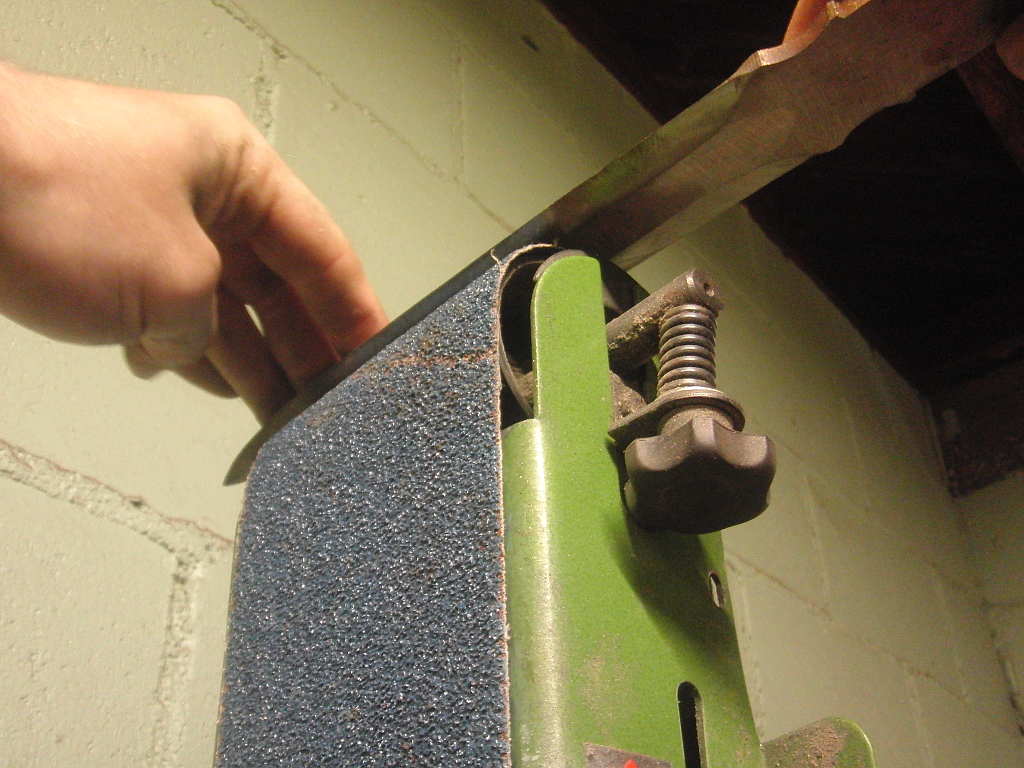

Grooves were made with the end of a belt sander (Obviously the sander wasn't running during this shot but you get the idea).
I stamped the imperial legion emblem on here because I am a giant dork.

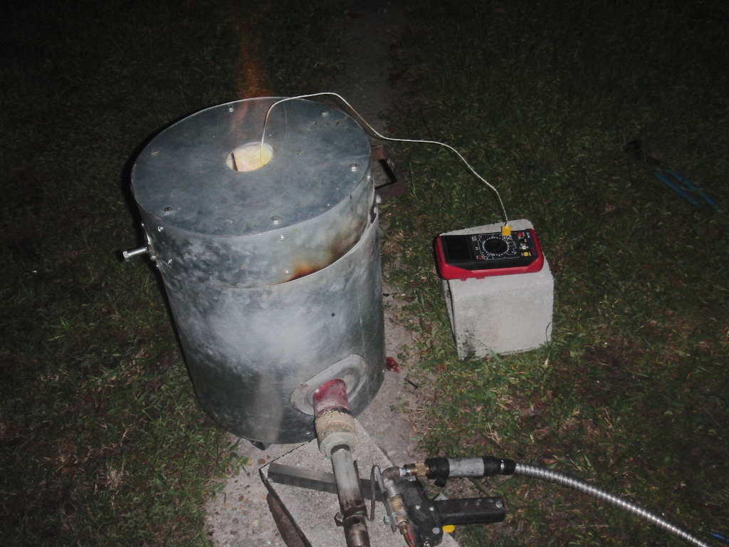

Used the new foundry to heat treat this one. Also tesed out those thermocouple multimeters that harbor freight sells.

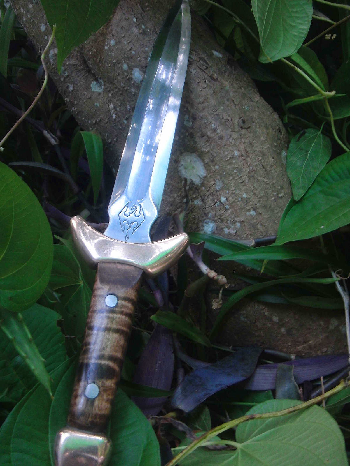

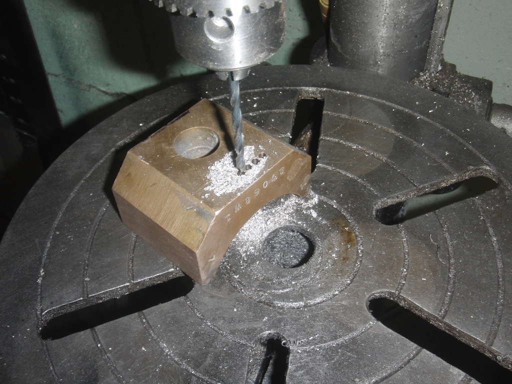

Made a crossgaurd out of a big crane bearing. This was the same one my hunting knoif was made from
Shineh
Shineh

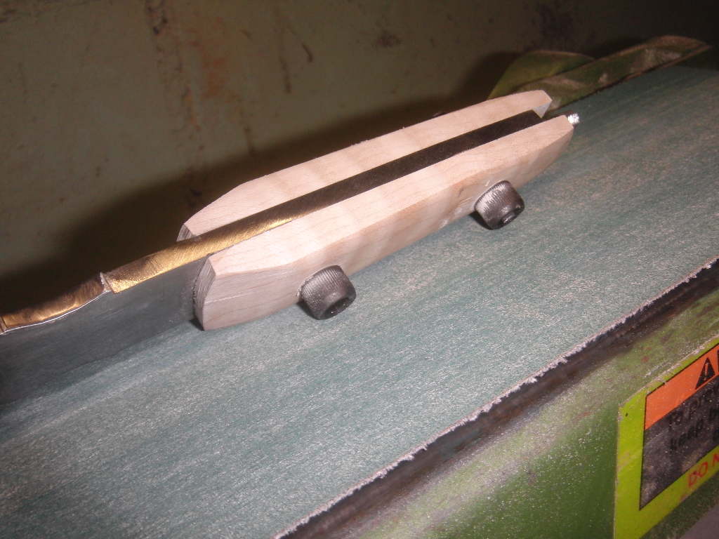

I just threaded some tiger maple blocks and bolted them onto the tang when sanding it into shape. The pins that were put through them later were also threaded.
I smeared some red high-temp silicone on one side of the joint before soldering. This was to keep the solder from dripping out when it was clamped upright.
The rest was easy.<br />The pommel was fitted by blackening the underside and pressing it against the grip. Wood was removed where it left a 'print', until flush.
The rest was easy.
Final product. Still needs a sheath.

The stamping, did you actually make a stamp with the emblem or hammer it in following a pattern with something slightly more sophisticated that a screwdriver?
Fnord
Posts: 2239
Location: Pripyat
I just hammered it in. Broken allen wrenches make great punches for detailing work.
Not sure how to make stamps that are intended for steel; I'd think you'd either need a mill or a *very* steady hand.
Posts: 26220
Been thanked: 352 times
Fnord wrote:Not sure how to make stamps that are intended for steel; I'd think you'd either need a mill or a *very* steady hand.
Acid etching would be a relatively painless way of doing it, following by heat treatment to harden the punch itself.

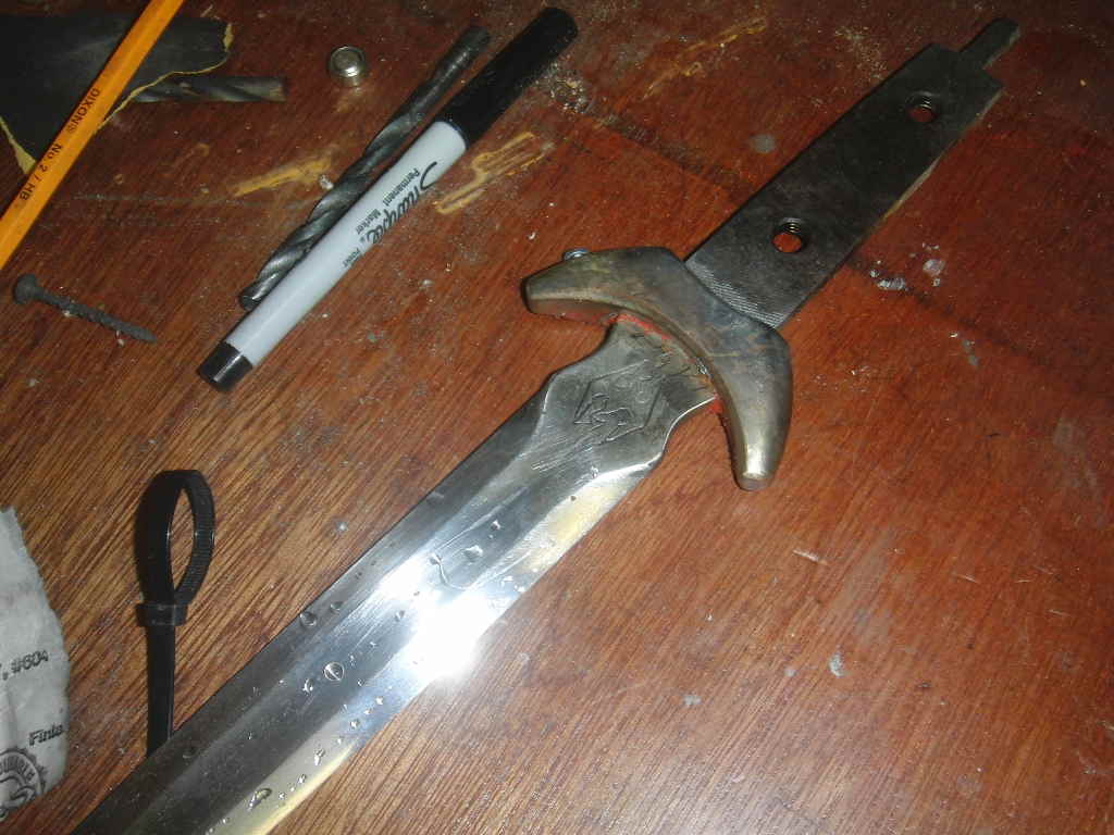

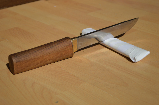

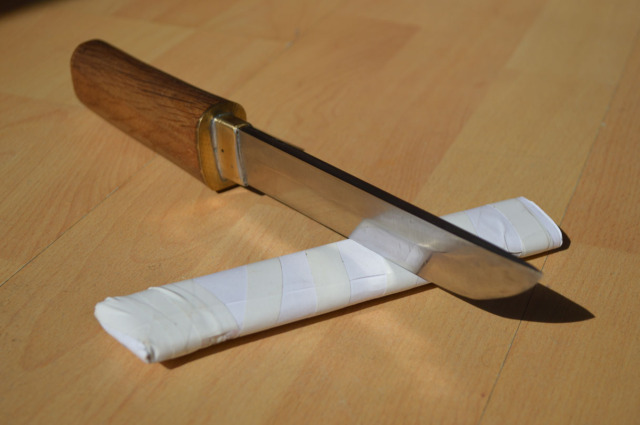

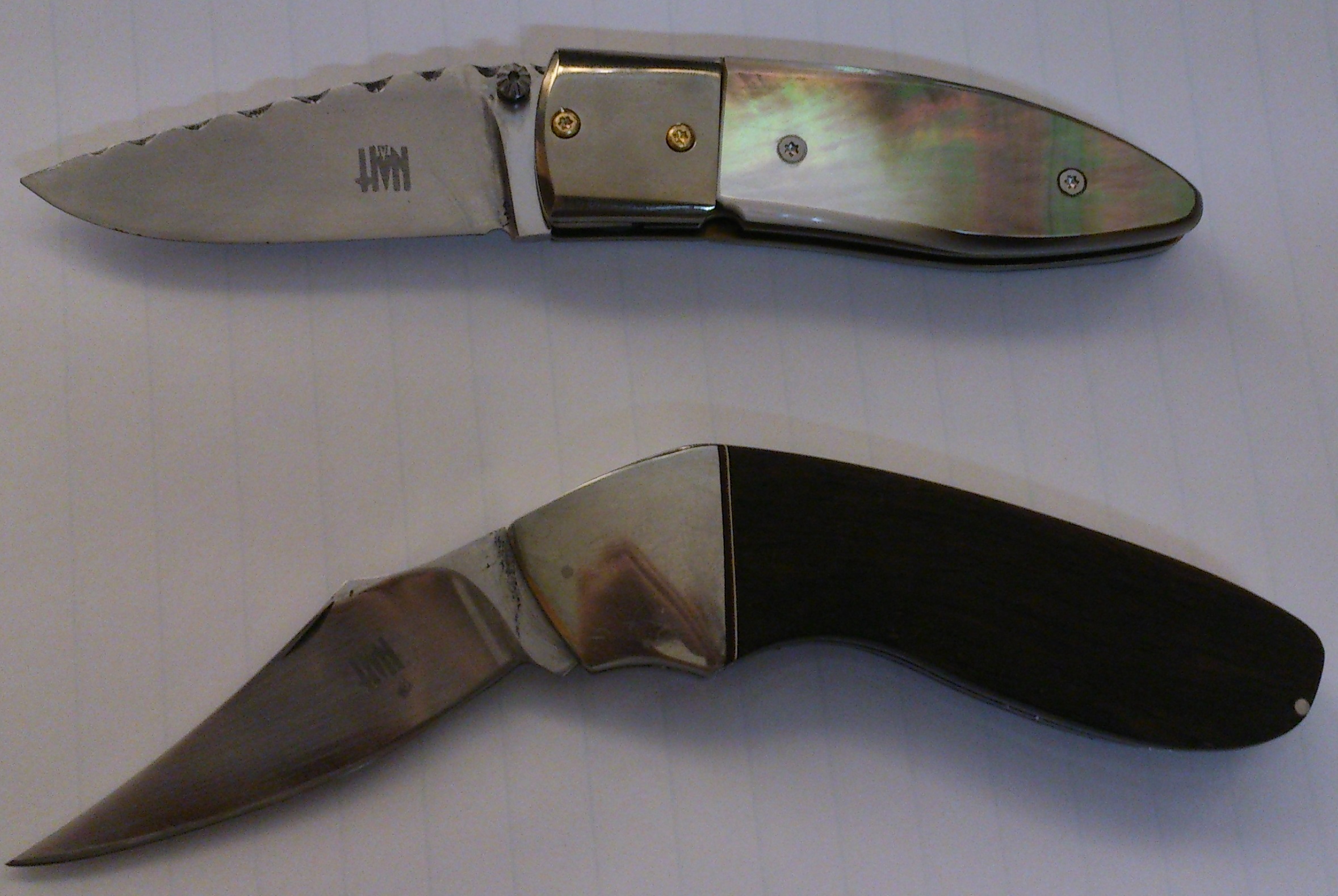

Here are 2 small pocket knives my dad is busy making that is not completely done yet....

That's a pretty awesome Dad you got there :)
Those screws look like they were taken from a Nokia 3310...
Heimo
South Africa
Posts: 243
Joined: Sun Oct 25, 2009 3:02 pm
jackssmirkingrevenge wrote:That's a pretty awesome Dad you got there :)
hehe those silver coloured screws were recycled from old hard drives, one place to find that size screw, the other golden coloured screws are actually bought screws that is gold plated...
Edit:
another WIP pic:

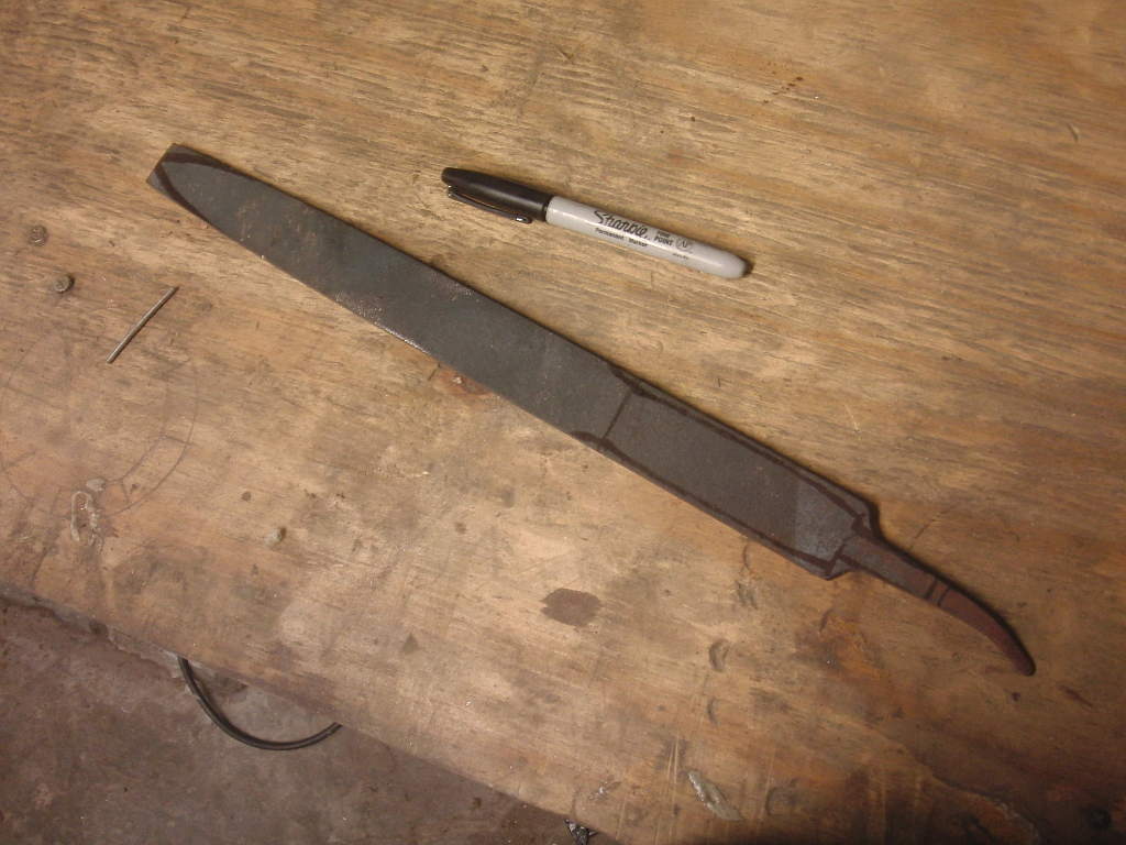

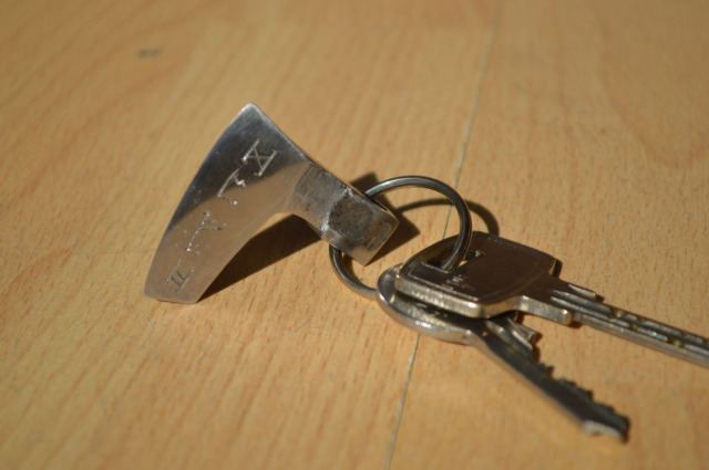

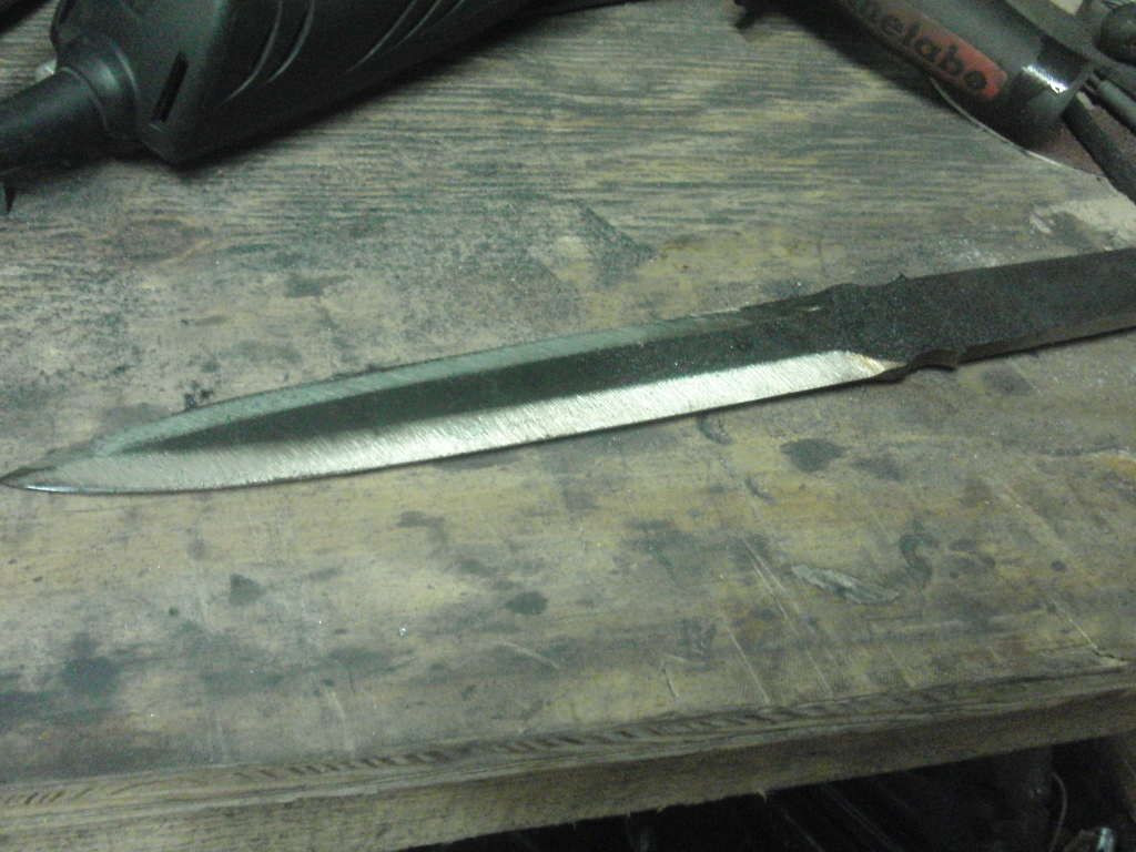

Here's my first try on knives. Its made out of an old file. Blade - 180 ,handle - 130 ,thickness - 7 mm . For now im too lazy to make saya :( . And a keyholder just for the lulz
