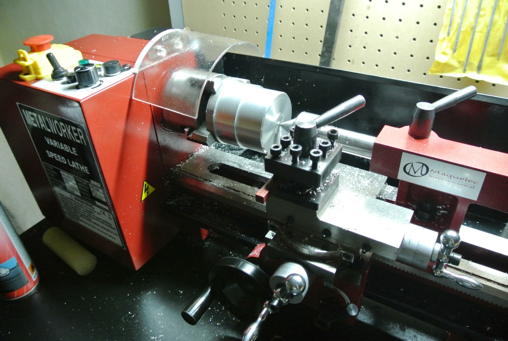

One thing I like about Sherline is they have a relatively long bed, the power isn't plenty through, I have a 500w brush-less motor on my SC2
Looks like I'll have to pay that 90 euro dial if I don't want to wait
OH MY GOD THE LITTLE WHEELS ARE MOVING OF THEIR OWN VOLITION!
... must be because he is listening to Queen.
You can see the rpm visibly slow down as he starts drilling the steel...the power isn't plenty through

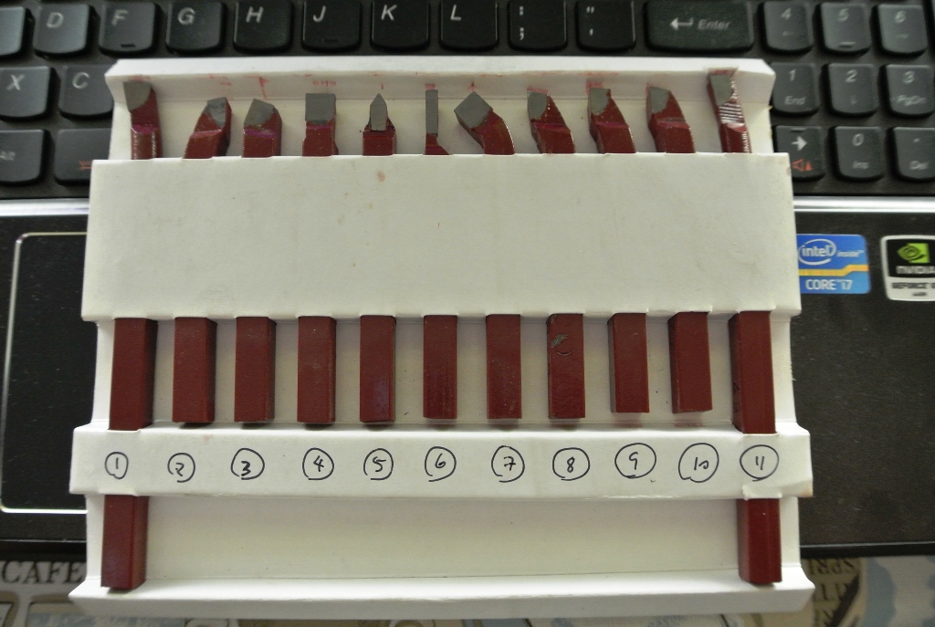

Can anybody tell me the name of each of these blades? And witch should be used for witch cutting? I googled lathe cutting tool types but didn't found much, only the name and function of 2 or 3.
Here's my amateur perspective:
1 is a boring bar - not because it's not exciting, but because you use it to bore holes (parallell to the lathe axis)
8, 9, and 10 are the ones you're most commonly use for normal cutting from right to left.
2 you're use if you're cutting from left to right.
5 is for cutting threads.

Well Thanks jack
Found a page with some tools with diagram and description, 4 and 6 are for cutting grooves, 3 and 7 are for edges.
11 should be some short of boring bar too
it has a round body as 1
I just swing the regular tool aroundwyz2285 wrote:3 and 7 are for edges.
These days this is the tool I use the most, with replacable carbide inserts:

First time turning
used a 70mm long 75mm dia aluminium to do some experiments with the tools and to see what's the best cutting speed and stuff
it looks so much better than what the drill press did (witch it should, considering the it's 10 times more expensive
