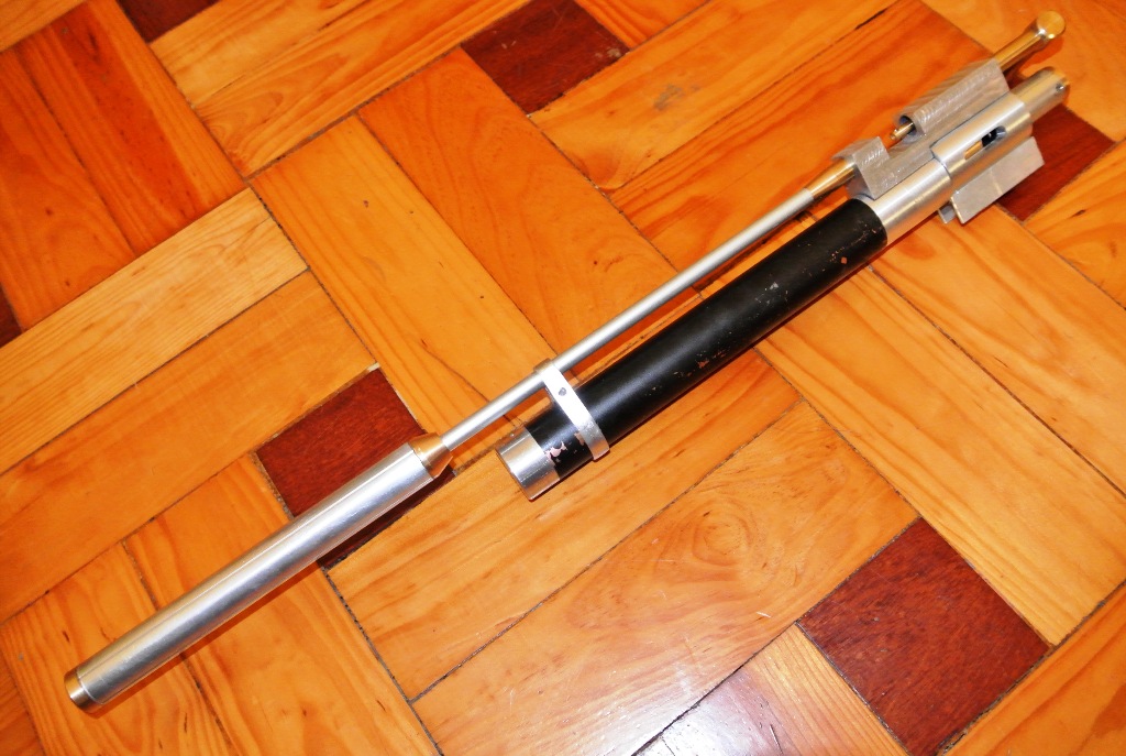

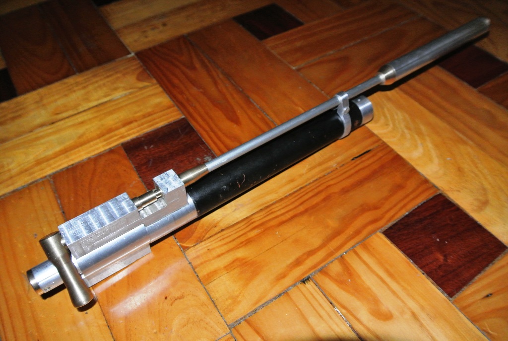

Almost done :D will finish the trigger tomorrow.
Also will make a proper thread when finished. Please be nice it's the first time I make a PCP :wink:

Looking great, you are puttig that machinery to some good use :)

Not really :lol: lack of planing now clearly give me headaches...
However, I learnt some precious experience with this so the next one I'm going to make will be much better :)
Can't wait for the rotating table to arrive :D
