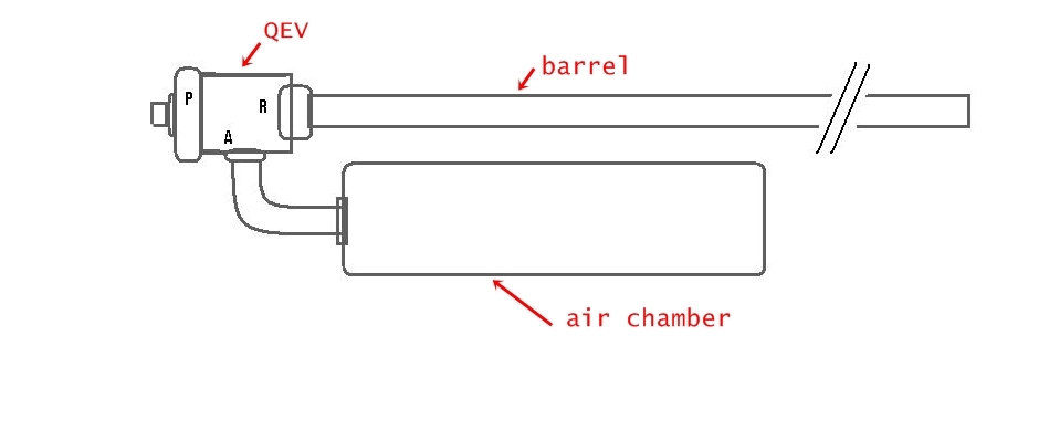

if I have set up like this(for single shot), do I fill air chamber from P or A(schrader in air chamber)?
wyz2285
Austria
Posts: 2388
Location: Porto, Portugal
If the QEV is store bought unmodded, fill from P.
Netherlands
Posts: 3497
If you modify it, you can fill from A.
You will need to poke a tiny hole in the piston...NOT in the center part!
When I say tiny ...I mean..poke a hot paperclip through the outer rim, or drill a 1mm hole...that small.
stay clear of the center ( seals the out port) but also from the outside as it might cause a tear under stress.
A weak spring behind the piston will help it close.
Do not attempt unless you fully understand.
Piercing the center will make it useless.
