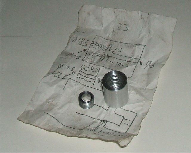

Ah nice!
Brand new machined parts
So beautiful!
So beautiful!

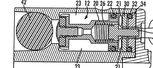

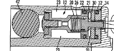

Interesting, pretty much the same idea I was working on here.
However, note that this is intended for a revolver mechanism from what the patent indicates, in my case I want it to generate enough force to operate a blowback mechanism.
Ah k, I couldnt find your other post so I posted it here. Yeah I dont think a blowback cartridge would be possilbe due to limited air in it. Once the pressure and the volume go up, the weight also increases. So there is a tradeoff> in other words its ganna be difficult to get it right.jackssmirkingrevenge wrote: However, note that this is intended for a revolver mechanism from what the patent indicates, in my case I want it to generate enough force to operate a blowback mechanism.
