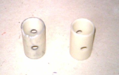

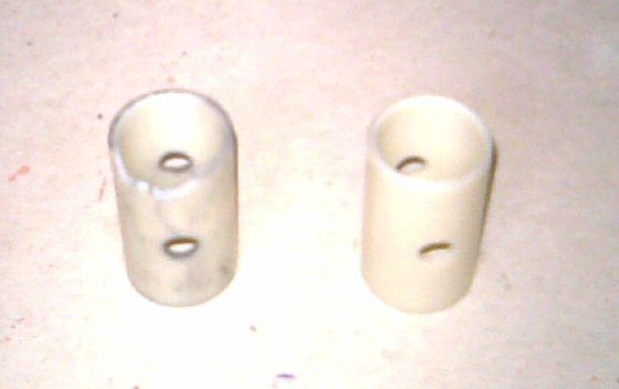

I took the beast apart today, putting bad quality ammunition through it (I thought I'd use cheap stuff as I was going through so much ammo - bad idea) resulted in a few misfires that double loaded pellets into the barrel, which damaged one of the baffle spacers within the shroud.
While waiting to hear from my dealer if he has a replacement part available, I took the opportunity to examine the relaoding mechanism:
From what I can tell, it does work like most assault rifles as I had imagined. The white section of piping around the barrel is part of a coaxial piston, when air exits the muzzle it pushes on the black part at the front of the white tube, pushing the whole assembly back and recocking the trigger/cycling the mag via the rod attached to the brass end of the piston.

Here's the broken baffle next to the replacement, the rifle was still cycling in spite of the damage but the clatter of pellet and baffle fragments in the shroud was beinging to annoy me, plus I finally had an excuse to take it apart
I had been hesitant to do so for no reason, the reloading mechanism is extremely finely balanced and it doesn't take much to upset it, either not cycling at all or going full auto
