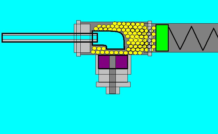

Some damage and inner workings:
Basically how the bbmg works..

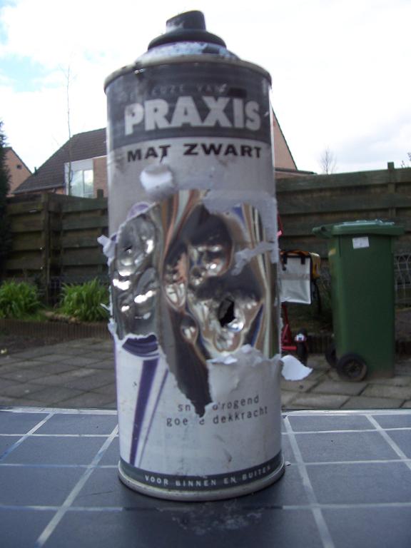

Damage to spraycan at just under 30 bar..As I said, plastic leightweight bb's have their limitations.Lead bb's would have opened op that can like a...nasty sl*t watching porn...

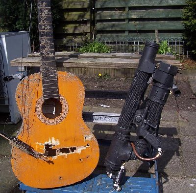

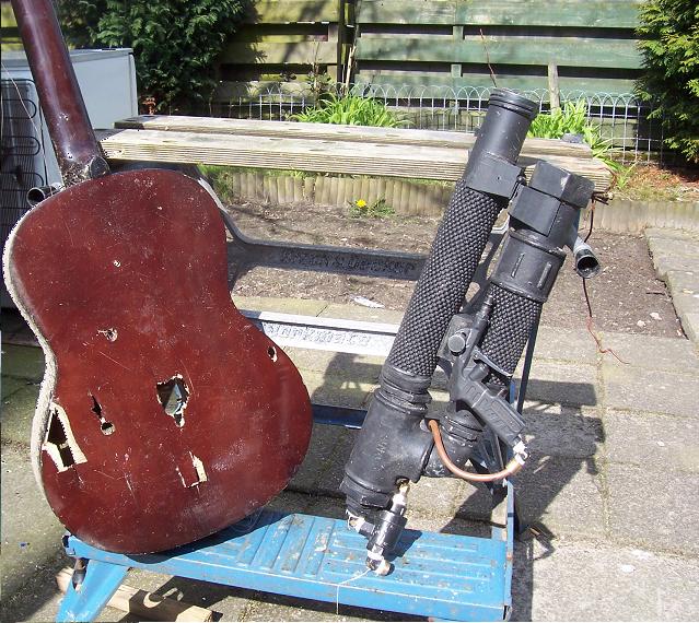

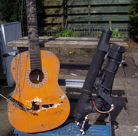

Now that is damage.Shot clean through an old quitar at 10 bar with my ubercompact 47 mm breakbarrel cannon Overkill<br />It can take 30 bar..I have a love for compact overpowered guns..in case you haven't noticed..
And exit.Blowing the whole string section off..

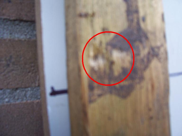

Not too impressive.No real penetration.Just over 30 bar.Just dents.The bb's just don't have enough mass...

Does that can mean 'flat black' in English? - If it's even a spraypaint can and not silicon spray or somethign like that...
Yep, that's flat black spraypaint allrighty..Don't leave home without it :D

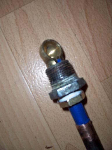

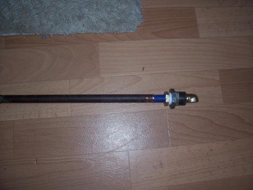

Now for the serious bit:

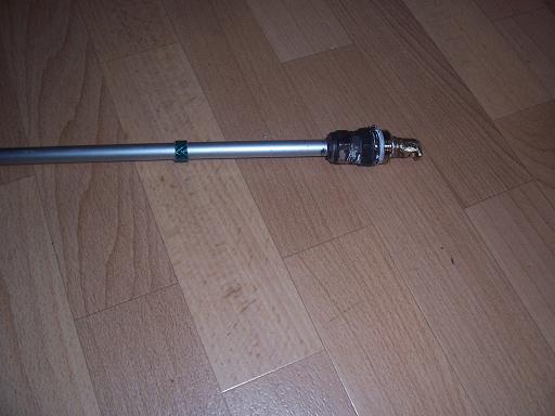

Byebye to the 6mm barrel.<br />Airsoft really ain't for me..

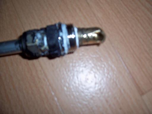

6mm modded elbow..worked fine, but now that I was gonna change the barrel, I went for a larger elbow.
Smoothbore .177 or 4.5 mm barrel.<br />No blowby.It was part of some strange hinge, so it wasn't even a pipe.It had a flap running on the top of it and it was asymmetrical.<br />Had to file like crazy, but it's worth it now..
New modified elbow.I imagine it scoops up bb's a lot better.<br />I'll know tomorrow as I'll be getting some lead .177 bb's.....and open up that can like a bee-itch!
