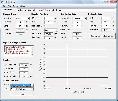

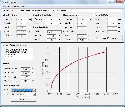

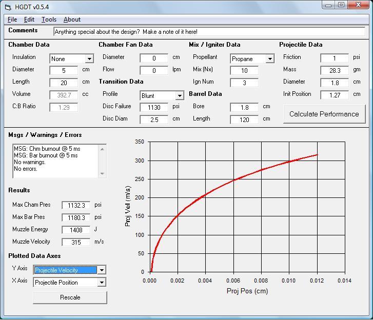

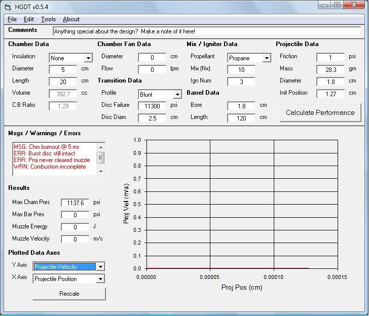

Zeus
Posts: 1505
Location: 'Straya, C*nt
If the pressure triggered valve is set close to the peak combustion pressure the difference should be minimal.
Sorry for the white space, Vista paint doesn't seem to have a resize. I'm spoilt by 7.
Download HGDT, you'll learn a lot just by playing with variables.
I'll even give you a link http://thehalls-in-bfe.com/HGDT/
If you're using Vista or 7, run it as an administrator (right click)
[Edit: Curse you MrC with your quick typing]
With the burst disc set 2 PSI under the maximum pressure of combustion
With the burst disc set 8 PSI above the maximum pressure of combustion.
