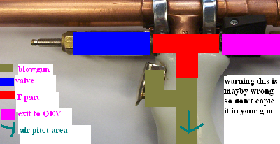

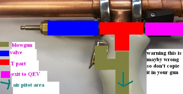

In the below picture the blowgun can be seen coming down but there is the filling valve after it. Thats because there is a T fitting in there.

Hotwired wrote:In the below picture the blowgun can be seen coming down but there is the filling valve after it. Thats because there is a T fitting in there.
Yes you can fiddle around with gas laws and energy equations but to be honest it's all a waste of time when what you're doing is just fitting together standard parts to lob potatos about.
If you want to know roughly how well a cannon will perform then shove the stats in the GGDT. Thats all I did before making mine.
like this???
spanerman
Posts: 437
yup thats it :wink:
