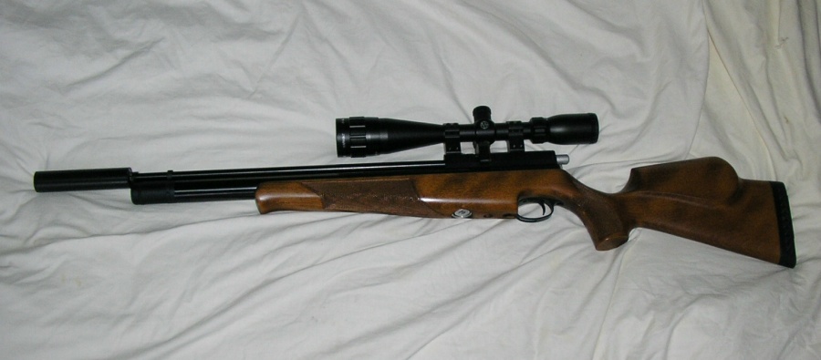

Alright People.... just an update here, as you can see on the first page, more pics have been added.
Updates include
*Bi-Pod
*S/S Braided Hose
The gun looks ace now, hope you all enjoy

I think your gun is really amazing. Good construction ,clean design. The only thing that detracks from the profesional look is the blow gun...I would do a little research and come up with a cleaner look for the trigger system..Maybe use a safety pressure release valve ,the small brass kind??

that out of the way i'd just like to inform the members of this forum that i made an entirely new piston for this gun, cut back on the pilot volume and whala! its gotten better again.
the piston is a piece of 20mm Polycarbonate Rod with o-rings and all.
the pilot volume now is a mere 2.5cm3 behind the piston (plus the hose),
i would also like to add i bought a shock pump that has a 0-30BAR (bit over 400psi!) gauge on it, but dont want to risk my blowgun breaking and shrapnelising my hand to nothing
im working on a new trigger but it will probably be something for next year.
peace guys
