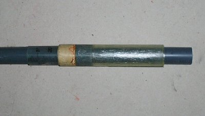

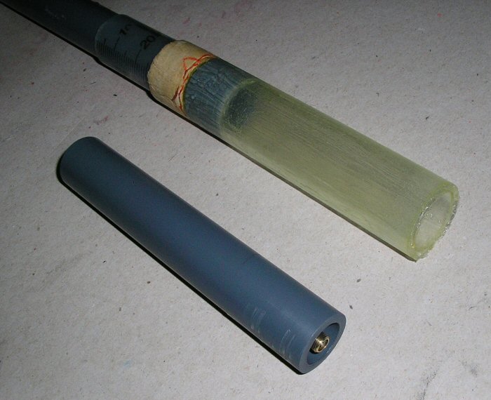

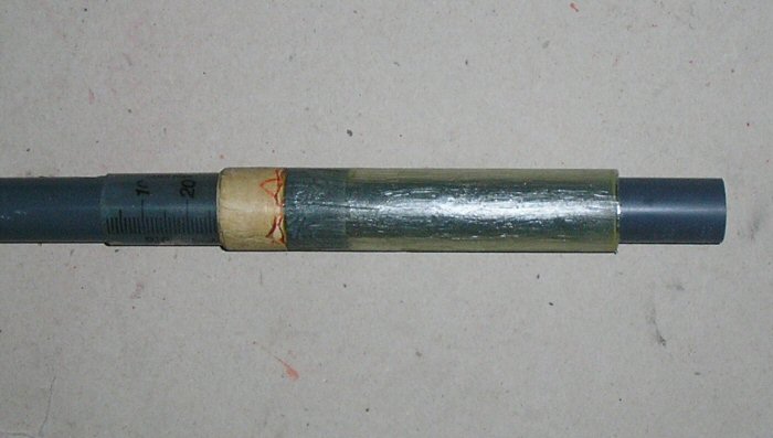

Well, here's the cast epoxy breech attached to the barrel - pretty, isn't it?
The "grooves" that appear on the surface are from the grease I used to lube the mould. That section of syringe tube wrapped in masking tape is part of the mould and should have come off but I'm not holding my breath.
The cartridge slides in and out quite smoothly, to be tested later today.
Edit: I made a slight miscalculation, the breech was cast with the cartridge unpressurised and it slides pretty smoothly, but once I take it up to pressure it actually expands slightly and jammed in place, so I had to do some sanding.
Fired a few test shots, a little disappointing. The cart attempts to eject but with nowhere near the force that my combustion cartridge had, it doesn't look like a semi-auto launcher is worth pursuing.
I do however have a working cartridge, and that leaves a number of manual/spring ejection possiblities, and I'm beginning to be inclined towards this one:
