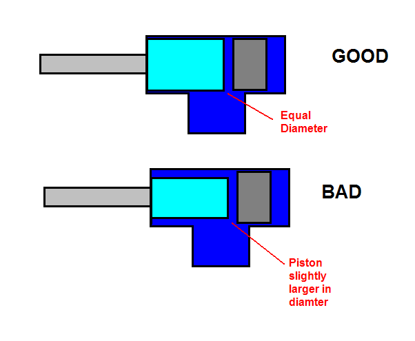

So in other words...
Edit: F*ck I switched the labeling. Top diagram is BAD, bottom is GOOD.
Edit 2: Rmich said:
rmich732 wrote: EDIT: One question... why not step up the valve porting to 1.5" instead of 1"? Not only would this have greater flow (increasing performance), but because barrel sealers actuate faster when the barrel port diameter is closer to the piston diameter, that would further improve performance.

I just built a piston valve in a 3" tee, and my piston fits so close that I have to oil it so that it slides, and I have no equalization holes...it seems to work fine (no o-rings just a rubber front disk)
As close to the outside diameter as possible is good, id say that even having the outer diameter of the barrel seal the same size as the piston is fine, because that way you still have about 3/16ths to an 1/4 inch of sealing surface, and all of the force works to push the piston against that surface...
In my valve I couldn't put the barrel seal in the middle because the inside of the tee isn't the same diameter as the inside of the 3 inch pipe(the piston fit in the 3 inch pipe), so if the inside of the tee is the same diameter as your pipe, then you can but if its not then I wouldn't bother because the piston will have trouble sliding back into a smaller hole if its a such a tight fit...instead just recess the barrel seal about 1/8th inch into the pipe

So a 1.5" piston sealing against a 1.5" pipe is fine? Or should I step down the pipe to 1.25"?
- Modderxtrordanare
- Corporal 2
- Posts: 686
- Joined: Mon Nov 20, 2006 1:22 pm
- Location: Texas
A 1.5" piston will work sealing against 1.5" pipe. (My piston was a 1.5" cap, so it's a little bigger and thats why it works.)PVC Arsenal 17 wrote:So a 1.5" piston sealing against a 1.5" pipe is fine? Or should I step down the pipe to 1.25"?
-Wiki
-Wiki
PVC Arsenal 17
- Staff Sergeant 3
- Posts: 1762
- Location: United States
my piston was going to be a plug, so the diameters are exactly the same.Modderxtrordanare wrote:A 1.5" piston will work sealing against 1.5" pipe. (My piston was a 1.5" cap, so it's a little bigger and thats why it works.)PVC Arsenal 17 wrote:So a 1.5" piston sealing against a 1.5" pipe is fine? Or should I step down the pipe to 1.25"?
