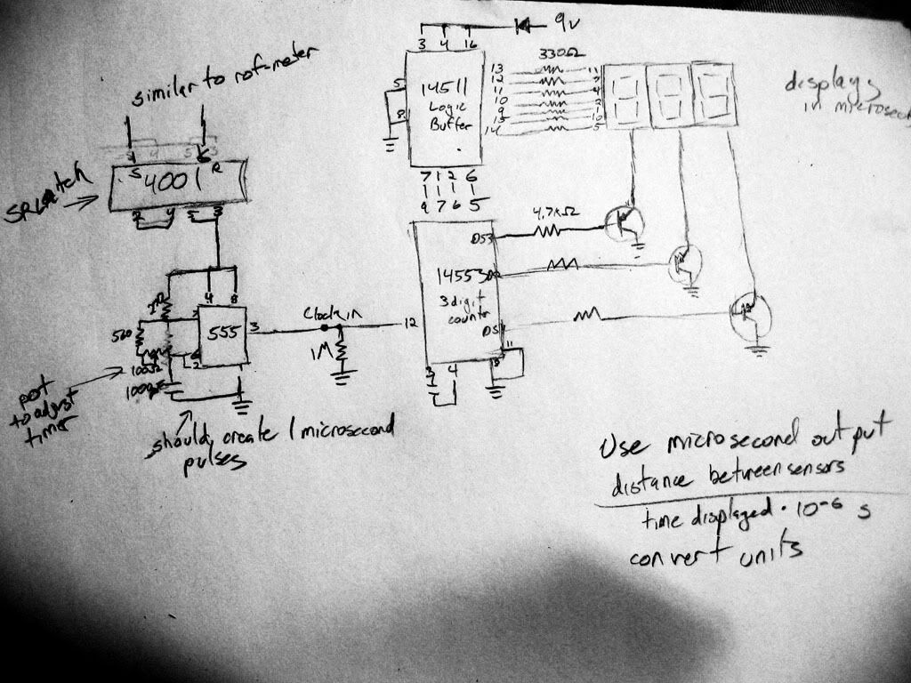

Here's a circuit that works relatively well. It uses a potentiometer so you can adjust the sensitivity of the interrupt circuit. Then it goes through a schmitt trigger to clean up the signal
Was a circuit I setup a little while back (using part of the one above), I messed up the 555 circuit so you'd have to fix that. Anyhow that worked by itself but it only works at certain FPS.
Edit: What type of AK mag..
