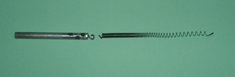

Here's the parts before assembly, with the bolt and spring removed:

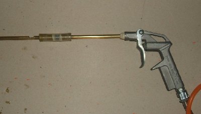

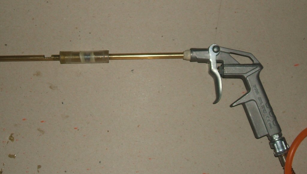

The actual firing setup is attached below:
breech attached to blowgun

I've done some further testing (until I broke the bolt hook again hehe, it never fails to amuse me flying out of the barrel) and it's clear that even with a stiffer spring, the rate of fire is much too high, not only for feeding purposes but also to allow the projctile to leave the barrel in time. I could shorten the barrel but I would rather not. As it is, single shots with an airsoft BB didn't have enough energy to make a hole in a sheet of corrugated card.

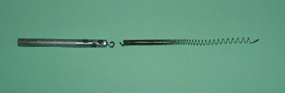

There's also considerable stress on the spring, see the attached image of what the original looked like after a few burts of firing (especially compared to its unused state above). I tried a stiffer spring, the stiffest I had but pretty much the same rate of fire and same effect on the spring.
I was thinking of rubber bands as a possible alternative, there's still a lot of R&D to go
bolt and spring, before the bolt hook attachment decided to come off again.
