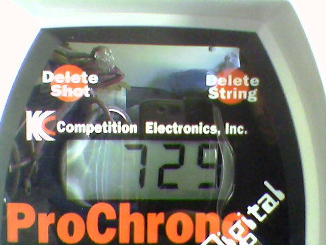

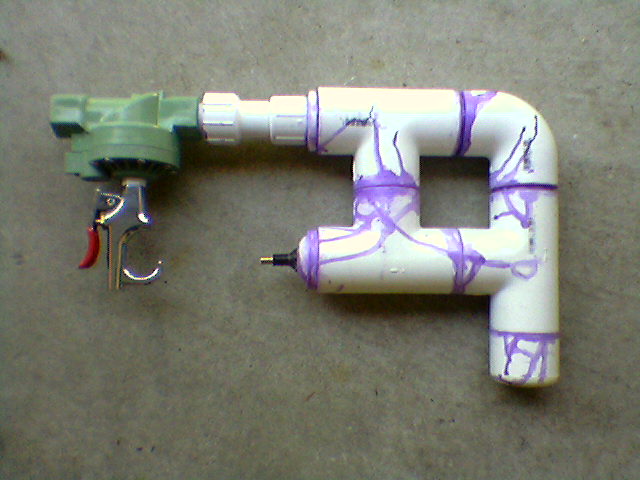

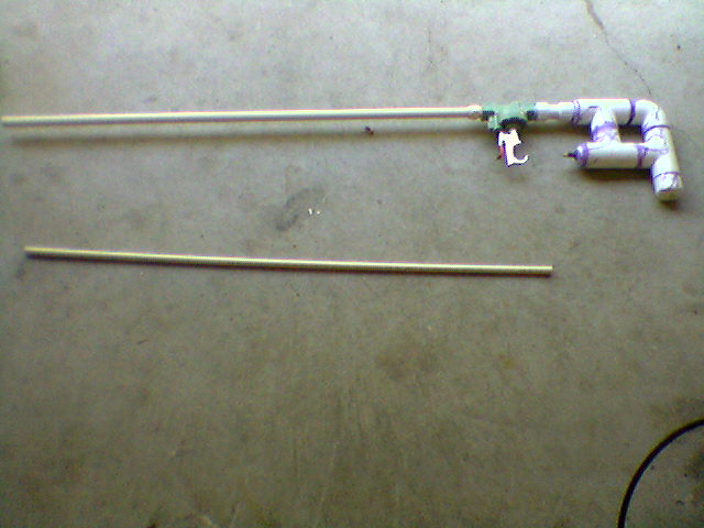

I think the reason they are only rated to 90 psi is because they have the little nozzle on the end. You probably removed it, so you should be fine, even at high pressures. NICE gun, too! 729 fps... AWESOME!

yea i did have it off i was shooting air soft pellets so i used a different fitting. but at the 400 psi i could not get it off on the quick connect. i had to drain the pressure to get the quick connect to disconnect?

Thanks.Pilgrimman wrote:NICE gun, too! 729 fps... AWESOME!
Damn, 400 psi, i want to see your gun.trae08 wrote:yea i did have it off i was shooting air soft pellets so i used a different fitting. but at the 400 psi i could not get it off on the quick connect. i had to drain the pressure to get the quick connect to disconnect?
