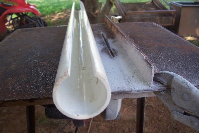

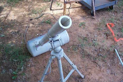

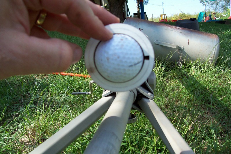

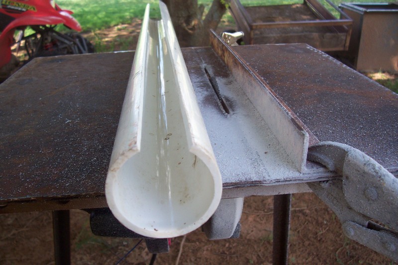

I have searched long and hard for sdr21 pipe so i could make a golfball barrel but i could not find it anywhere i called. I pretty much gave up until the other day when i read a post from one of the spudfiles members about sleeving a 2" pipe into another 2" pipe. well this was the answer i was looking for and i was very happy!
it is not perfect because of the small gap down the barrel but it works for those thats not having any luck finding sdr21 or if your not able to order a gb barrel.
i also tried a 3" slip and it fit a tennis ball perfect.

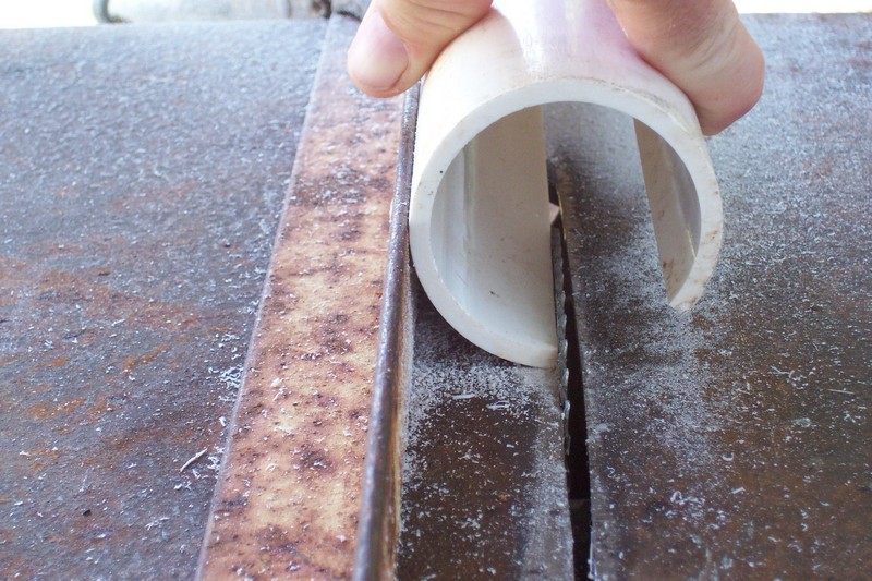

cut out just a little less than 1 inch

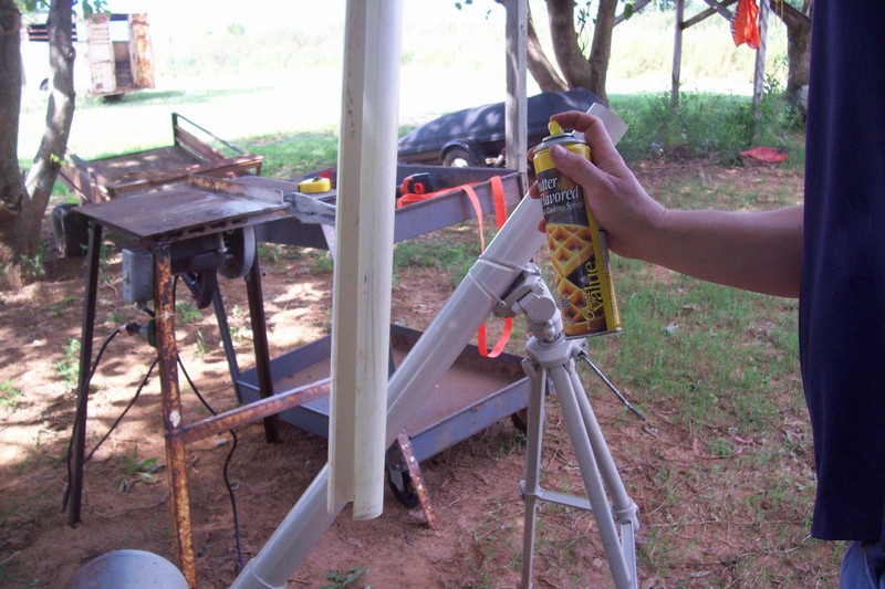

lightly oil half the barrel

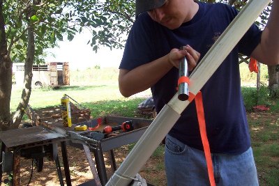

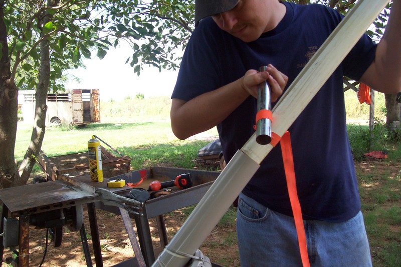

i had to use a terniquet? to squeeze the barrel in.

I wonder if you could fill the small gap with a piece of pvc sliced from another length of pipe? You sliced the pipe with a table saw right? Can you just run another length of pipe through the saw twice to get the narrow piece?
Another possiblilty would be to find some heavy cord or light rope that fits in the gap. If sized properly, it might even act sort of like a hop-up.

that is a good idea jimmy. it would have to be cemented in and that would call for something the exact size of the inside pipe such as a wood dowel so it would press up against the small piece the full length until it dried. or you could cut it to spudblaster15's measurments to reduce the gap. that might take a couple tries.
btw sleeving this 3ft piece was a challenge and took about 15-20 minutes by myself, 2 ppl would be easier.

Looks good! However, I'm not fortuanate enough to have acces to a table saw. Got any suggestions? :P
Marco321
Posts: 540
Joined: Tue May 15, 2007 2:56 am
Location: Sydney, Australia
noob of noobs wrote:Looks good! However, I'm not fortuanate enough to have acces to a table saw. Got any suggestions? :P
Use a dremmel, jigsaw, if you don't have them, you can always use a regular saw, but it would take alot of time

ive use the dremel alot on pvc and i can tell u that cutting something very long is a nightmare but it can be done. be sure to have extra wheels. u could use a skill saw and set the blade depth very shallow and take your time. mark a straight line to follow. or u could do like i did and make a ghetto table saw and bolt a skill saw under it.
