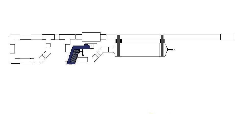

Hi All, just wanted your suggestions ideas and opinions on this cannon I'm starting to make.
It is basically a sprinkler valve cannon, with an under over construction, and a stock with shell holding thingy and barrel. No air goes into the stock, so don't tell me that, because the pipe goes right the way there the T that connects the stock. The sprinkler valve will be modded, it is from memory a garden mate, 25mm solenoid i think. don't think it has guide rod, which i have been told is good.
I have made a few designs, and all up it is going to cost me around $80 bucks, but thats why I'm running it threw here first, i'd rather take my time and make a really good cannon, then waste 80 bucks and it turns out to be a piece of crap :P and ends up in the trash.

Here is the pics of my gun so far, it shows the newest design, the stock which i've made to suit me and alsop the shell holding thingy, the shell loading breech and the layout of the gun, just needa fill in the blank sections :P:D enough talk heres the pics:

Gun layed out on my floor in the shape it should look like
Shell loadin system
Stock with shell holders (also the air does not go into the stock)

Wow pic is messed up still :( Ive uploaded it on Photobucket and it turns out like this, ill just give the direct link, hopefully your all kind enough to click the link. (ill post in the main topic aswell)
here it is:
http://i215.photobucket.com/albums/cc38 ... CANNON.jpg
EDIT: Allright figured it out, all you have to do is click the image to enlarge it, and its crystal clear :D

whats your barrel going to be?
anyway, i see no problem with that. i would use a QEV, but thats just me and my sadistic love for overpowered cannons..........

It looks like it would be fun to shoot. I would suggest breech loading. Also, a thread was posted not too long ago about adding backspin to marbles. It should increase range.
Other than that, It looks like a very neat design. Will the handle interfere with the piping like it does in the diagram? If so, that problem could be easily solved.
Good work :)

hubb017 wrote:It looks like it would be fun to shoot. I would suggest breech loading. Also, a thread was posted not too long ago about adding backspin to marbles. It should increase range.
Good work :)
Yeah cheers, um yeah i needa figure a way to make a good breech load, was thinking of having a bolt action loading system, and make it so the marbles are in shells, so put the shell in fire, open it, but is there a way to make it spring out? if not wont matter much :P
And no the handle will not interfere, this diagram isnt to scale really, but if it does interfere, ill use 2 90 degree brass elbows to make it stick out to the side.
thanks fr the comments and suggestions so far keep them coming!
Cheers thursto
EDIT: Which design do you think is better?

I like the first one better. For some reason, it appeals to me more (I like the look of a 45 degree elbow).
Newb had a pretty neat breech loader. Maybe you could make that work for you.

Id go for the first design (top)......
You should use 20mm poly pipe as your barrel, it fits marbles pretty well (with a little wadding)....

I made a little design alteration.......
The 1st design is only like $3 more then the 2nd...
3/4" is 20mm, aussies go by mm).....1/2" is 15mm......1" is 25mm etc etc.........
I think you might just be better off having all you fittings 25mm instead of 20mm..its just a bit less hassel with getting the male adapters to attach the sprinkler valve....
design alteration
design alteration

Mmmm you have a point, cept i might keep the stock 20mm (3/4") but buy an adaptor, ive only spent like 6 bucks so far :P (4 corners, and 2 t peices) so changing to 1 inch wont make much of a diff, but it will cst more.... :( so im going to work it out when im next at bunnings, which is cheaper: Going 1" or going 3/4" and buying the adaptors for the vlave. Then ill make my decision. and also ill probs be going with the bottem design, One reason. I was laying out the parts i have atm, and 2" will be close to the sprinkler valve by going by the bottem design, if i go with the top design, it will hit the sprinkler valve.
EDIT: Sorry the pic you attached didnt come up before yeah i like that design, except i dont want the pressure going into the stock so, how would i block of the T?
