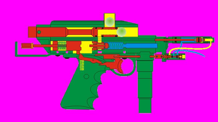

Its kind of early to be posting this since I get my parts on the 18th but I have made a prototype of a bolt actuated paint ball gun similar to an auto cocker and as of now my controller is a Lego RSX :oops: . It controls two relays which in turn operate a solenoid to fire and a solenoid to work the bolt. I am not to educated at the making of a circuit to replace this and I was wondering if anyone can point me in the right direction? It needs to have this loop;
1. trigger pressed
2. main solenoid fired
3. 2 second wait, bolt solenoid operated
4. main solenoid fired
steps 2 3 and 4 will be in a loop as long as the trigger is held
Any ideas?

Both the solenoids operate at around 12 volts so the relay or transistor needs to handle that. The timing I will figure out when I get my parts in and hook it all up with the RSX as a processor. I will try and get it working that way and then figure something out using transistors and some timer circuits. I choose relays now because they were cheap and easy to use. No soldering needed and I can detach and reatach leads..
