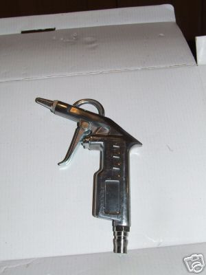

G'day guys, 1st post in a while! I'd love to attatch one of the gun style blowguns up to my bb rifle. I'd have it attatched via the nozzle. Would this work? I remember very clearly that Meklor used one in that fashion for his marble gun. It seemed to work fine for him.
Cheers!
Thats the one I'm looking to get.
Above a certain pressure it will start to leak, what the pressure will be depends on the individual make of blowgun. You can find this out easily by hooking it up to a pump or compressor and making a note of when the hissing starts ;)
