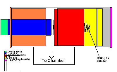

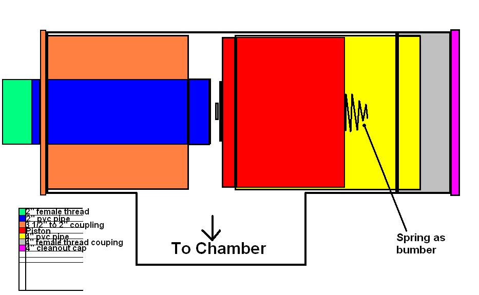

Do I have this right?
Looks good so far, dont forget the pilot valve! Also, I think the "coupler" you are looking for is called a reducing bushing, But I have never seen 3 1/2" pipe, i assume you mean 4" because that is your tee size.
Your barrel port is bigger than shown in the picture right? because the way you have it will restrict flow.
Good luck with 4" fittings on price, cant wait to see this valve!
Part number 4880K614 on http://www.mcmaster.com
The pilot will be where the Pink thing is. And what could I do to get it down to 2", thats how big my barrel is.. how would i do that if I can't get a 3 1/2" to 2". Because I cant' use a 4" to 2" reducer because it would make the tee even longer... would that be a problem though? Now that I think about it, I don't think it would be.

I agree that the blue part that is being sealed should be 3 inches. If you have the money to buy a 4 inch tee you can afford the parts to make this as good as it can be. Port it 3 inches. You can always put a smaller barrel on it via the threaded barrel adapter you talk about (green part).
A 4 inch to anything bushing will fit in the tee as shown. GO THREE!!!
I am not sure you want to use a cleanout cap. If we are talking the threaded cleanout caps like you use on a combustion they won't hold pressure. I don't think they even make pressure rated cleanout parts. Depending on what you are piloting with I would use another reducing bushing back there, probably a 4 inch to 2 inch or 1 inch and then a big ball valve or big sprinkler if you got the cashes. A blow gun won't work, not big enough for this size of valve.
Port it three inches, you know you want to....

I have a 1" sprinkler valve that i was going to use. Thanks for clearing up all of that about the barrel part. I'll port to 3". I've seen a few people that have used cleanout caps, but those were for 2 inch piston valves.. I just need someway to get in there and get the piston out if I have too.

you really need to understand pvc fittings cause this shows you don't know very well
brushings = adapter fittings with a larger male side and a smaller female side,
couplers= fittings with 2 female sides can have 2 same sizes or 2 diffrent sizes however most of these 2 size adapters are non rated DWV
this is your first so go with a simple threaded port no bolts and orings
on the barrel side of the tee have
2 inch pipe--cleaned out 4" pipe to 2" brushing-- opening in tee
and on the actuator side
opening in tee--4" inch pipe--4"to 4" threaded female NPT coupler-- (4" threaded NPT to 1" female socket) or if no avalible (4" male threaded NPT to 4" female socket--any rated brushing(s) to convert 4" to 1")--1" pipe--1" male threaded adapter
by the way with the single spring in the center may just go into the hole of the actuation valve and not press against the wall to cushion anything
plus the sealing face must be larger than the barrel
