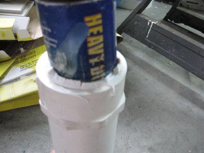

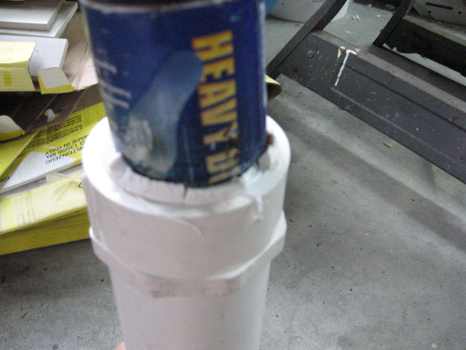

Well I was in the garage trying to rig up a new pilot setup for my SGA golfball cannon, which was leaking a bit.
So I finally found a good setup and just tinkered around trying to get it to work, I would worry about the huge pilot volume and uncomfortable triggering setup later, I just wanted it to work, leak and JB weld free.

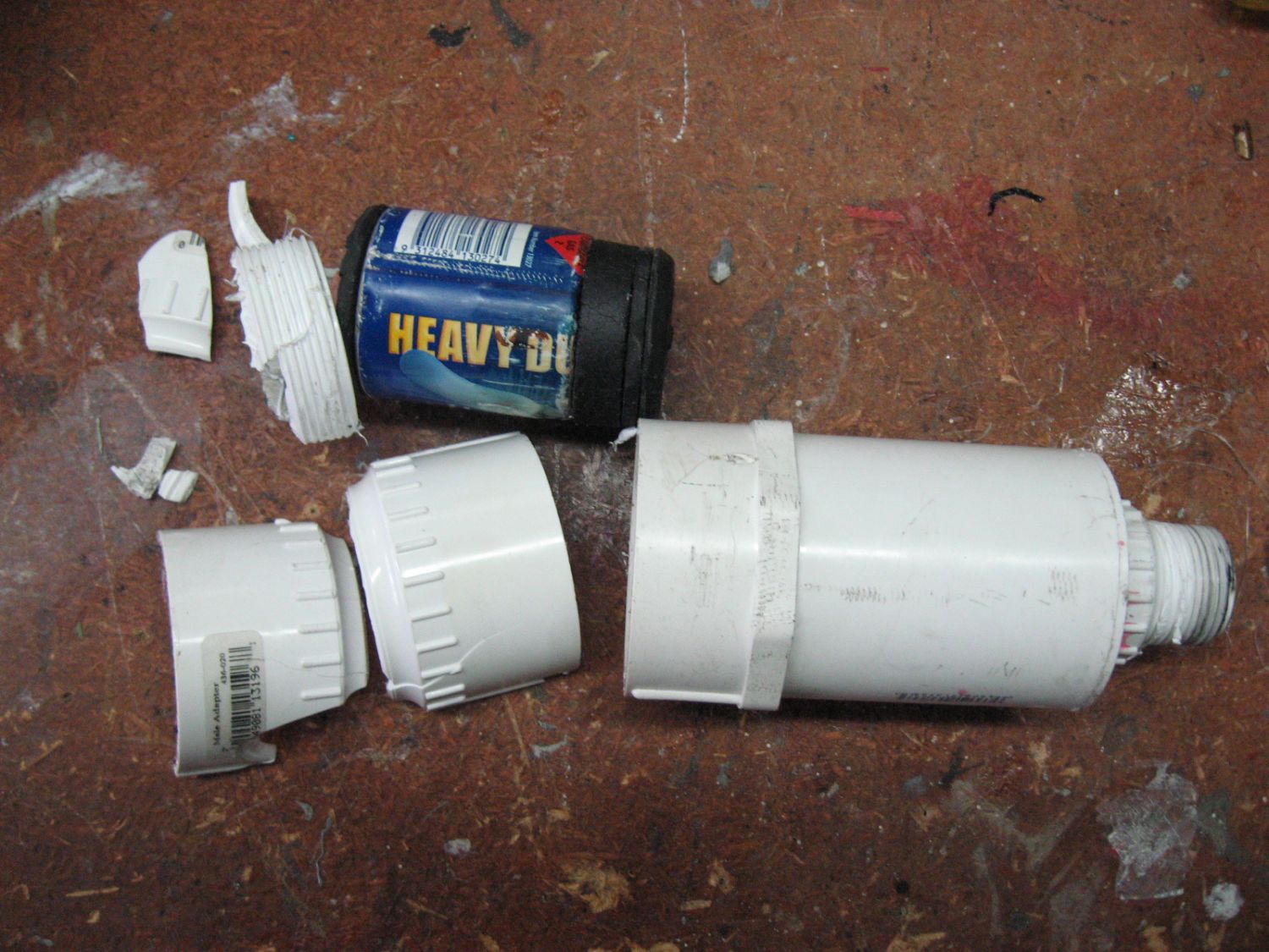

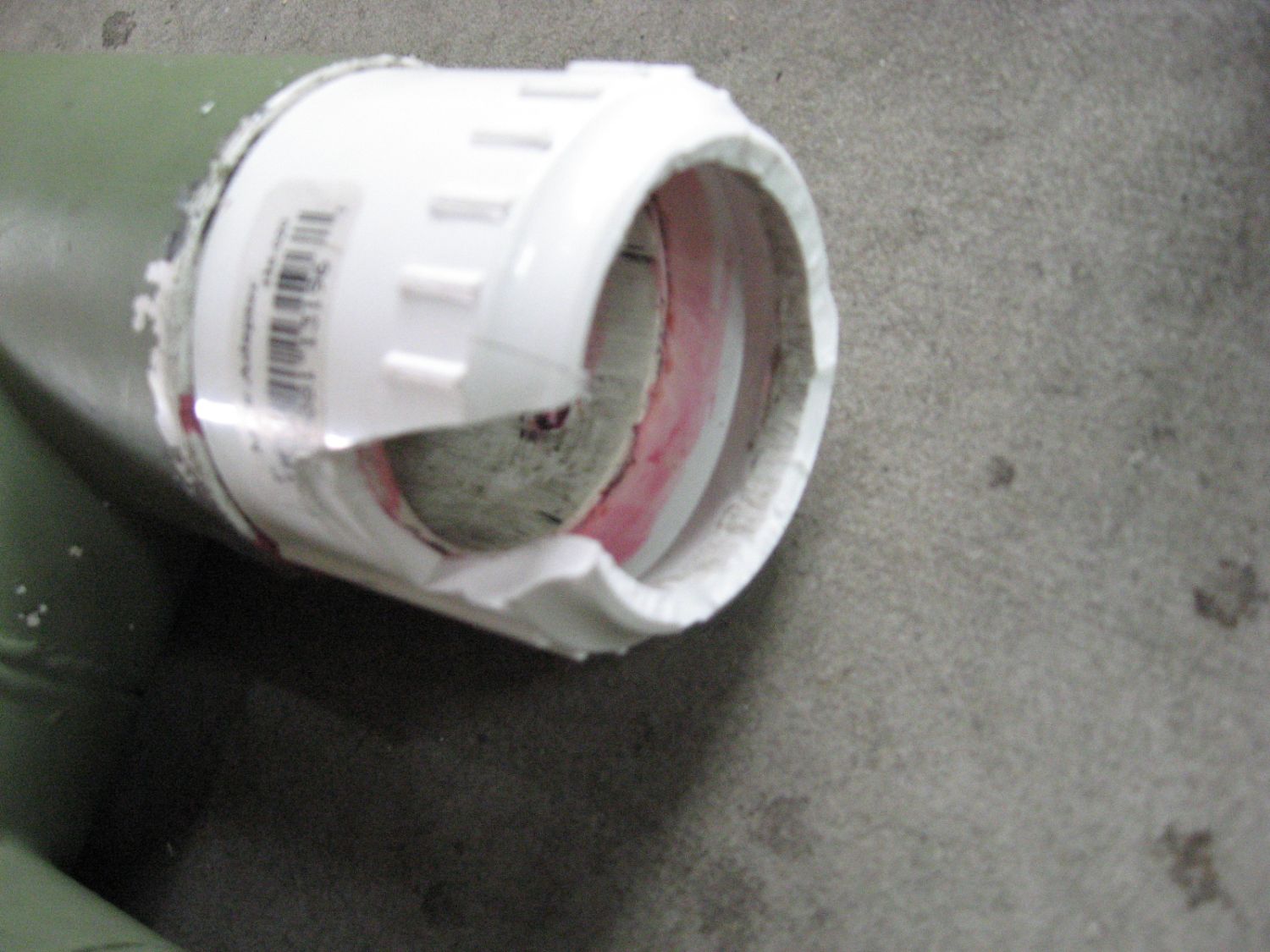

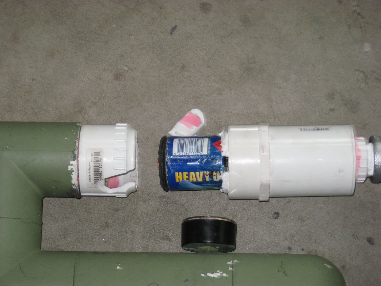

I know what went wrong, the bumper on my piston wasn't enough to stop the piston flying into the back of the fitting, which tapers down on the inside to the threaded part of the fitting(threads on outside).
This happened at about 95psi by the way, blew my bloody ear drums out and a piece of PVC hit my check.
I was going to put some bolts in the fitting to stop this, but
a) didn't want to weaken the fitting(ironically)
b) didn't want to risk having any leaks
c) the piston could've cracked the whole tee if it had enough force on the bolts.
d) I just wanted to test it out, make sure it worked...
Boy did it work...

As a matter of interest, is your bumper that section on the rear of the piston? And how much travel did it have to accelerate enough to do that kind of damage? A bit more that 0.375" methinks ;p

I've had part of this guns chamber blow up before, ever since then I hate using PVC at over 100psi, I wont be scared of pistons because I know exactly what went wrong and how to fix it.
With this setup it slams into a the tapered fitting, which I forgot all about, the piston travel would be about 2.5"
I know, I know, but like I said in my OP, I just wanted to get it to work, then I would start minimizing my massive pilot volume.
You don't want to even see what I have after that PVC threaded fitting, there is a 1" tee and a sprinkler valve with a 4" long nipple on it, It's all I had for the time being.
The paint, is just your everyday camo green spray paint, we don't get kyrlon fusion here.
Yeah, that black part is the bumper, it's softer then it looks. And when I put this new pilot setup in I forgot that this bumper was probably only good for my old setup, where the piston(with bumper) slammed into four bolts.jackssmirkingrevenge wrote:ouch, glad you weren't seriously hurt.
