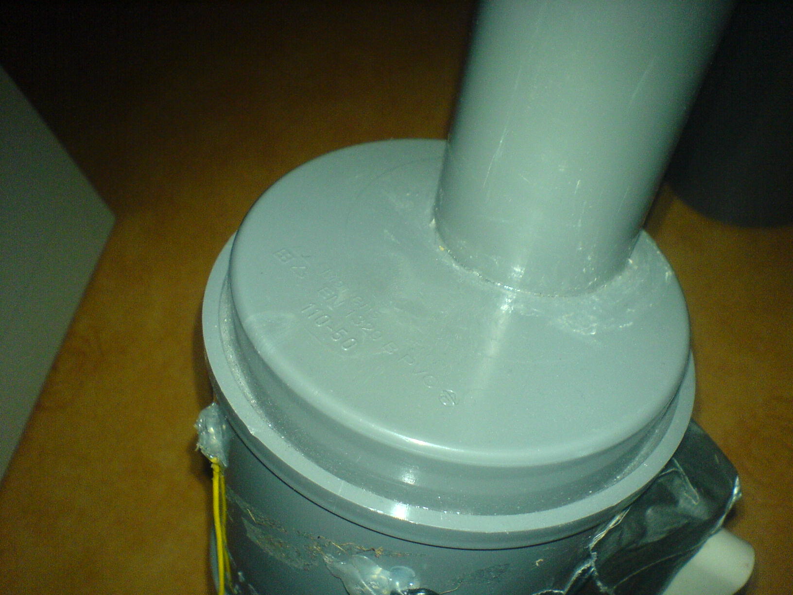

Ive put on a picture of the 110mm->50mm reducer on my combustion.
Hope this clears things up.
At my country, almost all reducers are like that.
It has a 50mm female hole and is 110mm male itself

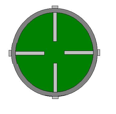

Can some epoxy seal off a 80mm tube?
psycix wrote:Can some epoxy seal off a 80mm tube?
If you apply it thick enough (about 10mm) and use pour it over reinforcement like wire mesh or metal sheet, it will do so easily. A good example is the launcher I just linked you to:
edit: Another method I've used is to cut a disk out of plywood and fix it in place making sure the edges are sealed, then pour a layer of epoxy over it. The thicker the wood, the less epoxy you will have to use. Yet another way of reinforcing it would be to drill holes in the end of the pipe and insert bolts or nails, I've included a diagram showing an end view. I showed 4 bolts as a minimum but the more you add, the stronger it will be.
If using epoxy, be sure to check out my posts in the how-to section to ensure maximum strength.

Up to how many psi can such a thing hold?
I've use it up to 150 psi with no problems at all.
