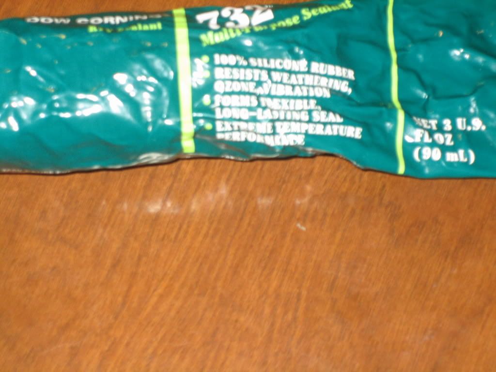

well i have been searching around the house and i noticed this. It is a Silicon rubber sealant and i have heard that silicon rubber is not a bad sealant for a piston, actually i heard it was really good but it there was a downfall but i dont remember it. So anyway, my question was will this work as a sealant? or can i make a silicon rubber face out of this and use that to seal the barrel? or would i just put it on the front of my piston, let it dry, and then i would have a sealing face? Well you guys tell me. Here be some pics. (I know that i said that incorrectly but i like to say it like that).
This is the tube of the silicon rubber sealant

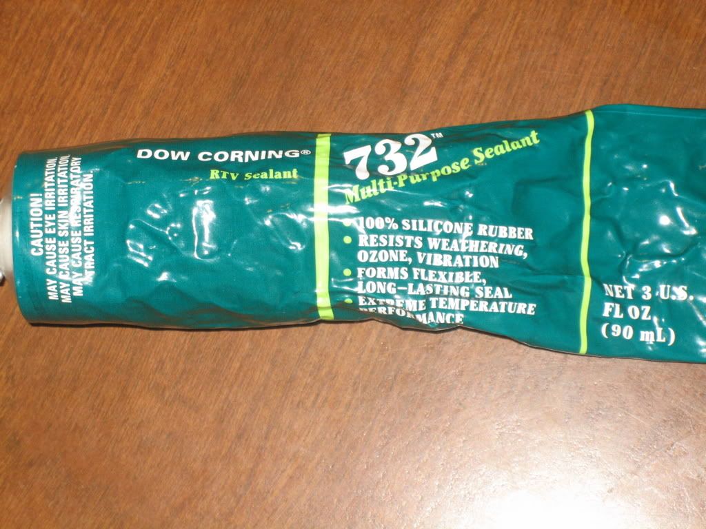

This is just a closer look. If you can read the small print, it says:
100% Silicon Rubber
Resists Weathering, Ozone, Vibration
Forms Flexible, Long-Lasting Seal
Extreme Termperature Performance
