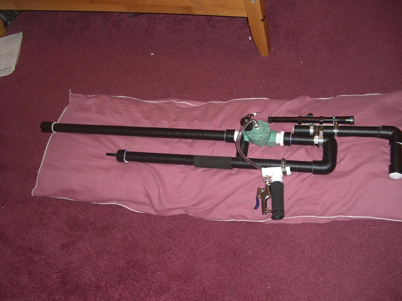

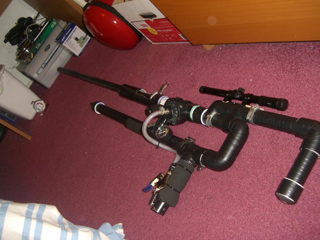

this is my second sniper i made i just finished now and am waiting for it to cure . update* ok i got some damage pics now and some more pics of the gun hope you guys like it* new update Update**:D i got a shiny new gauge on it :D and fixed the stock from the previous position cause it was moving .

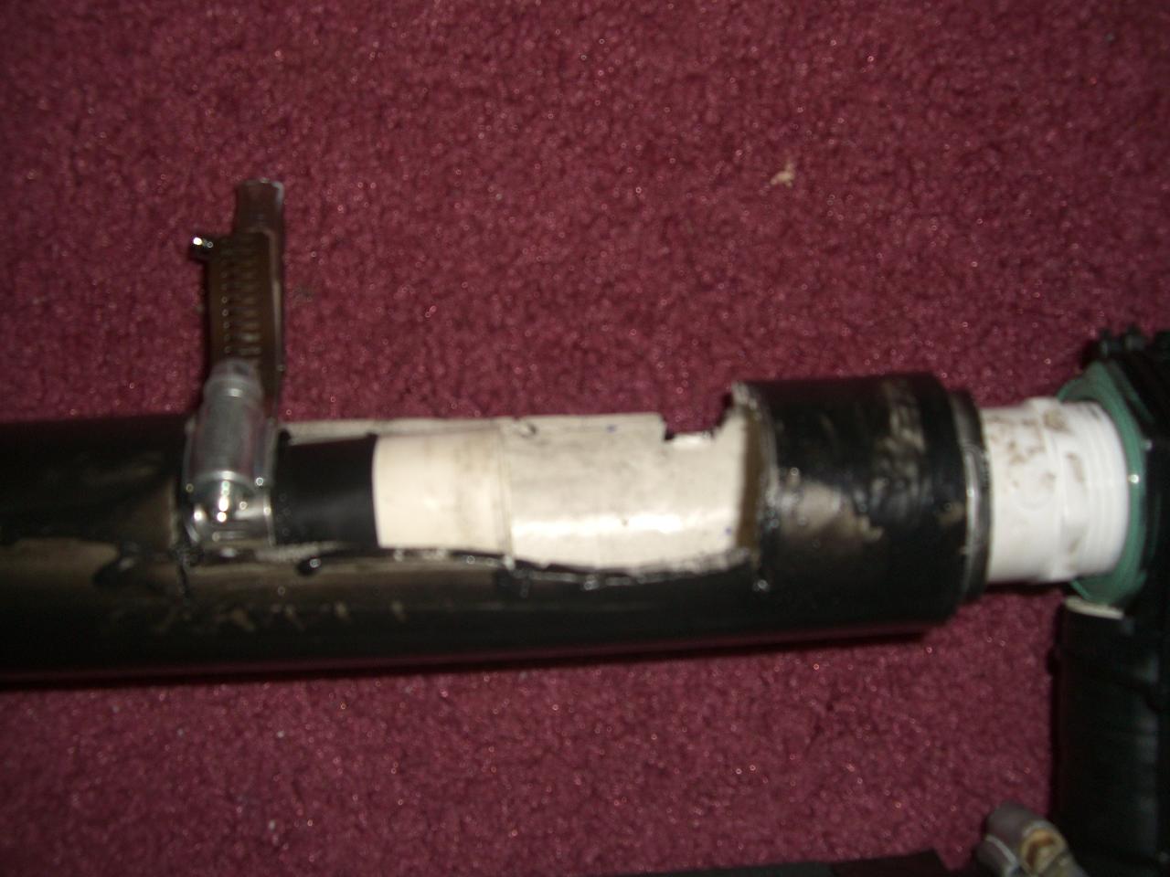

breech.

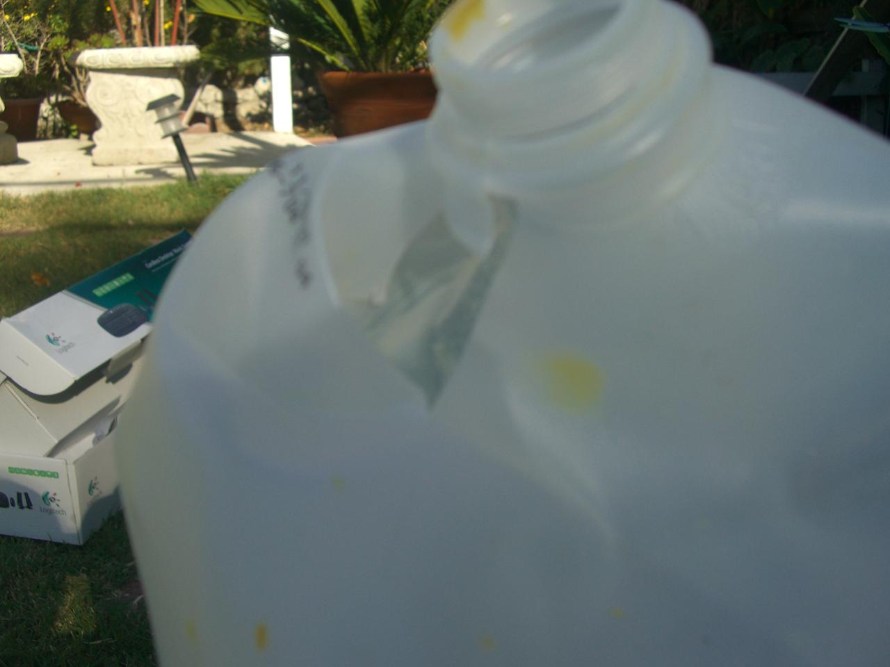

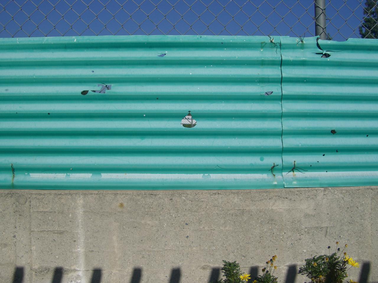

More DAMAGE PICS:D
damge video at low pressure

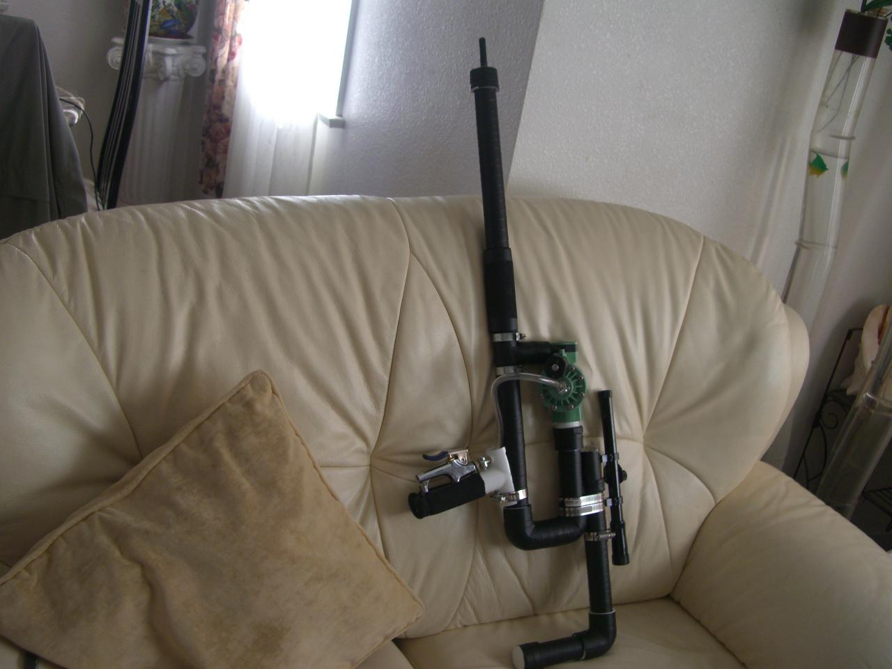

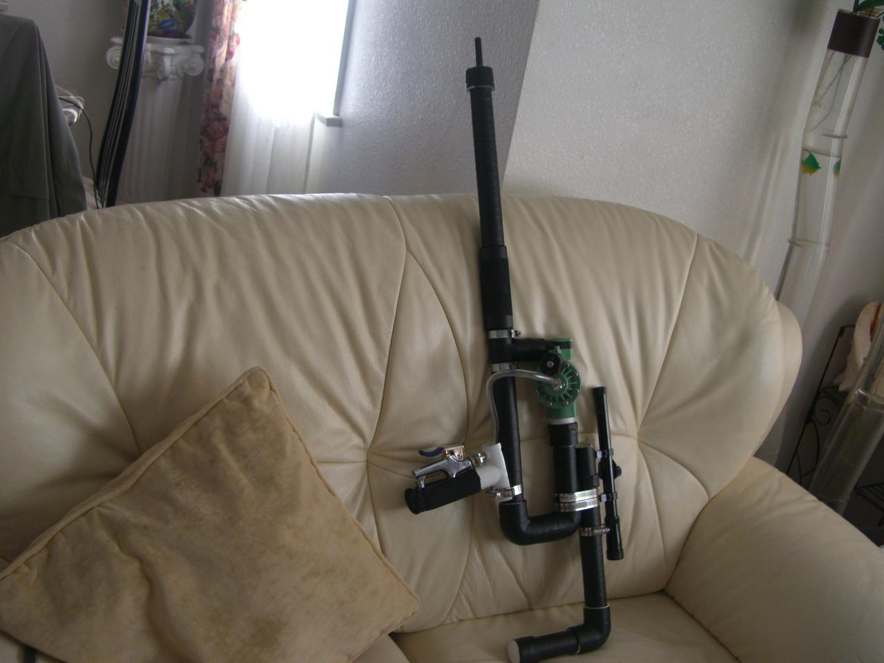

the gun
the gun

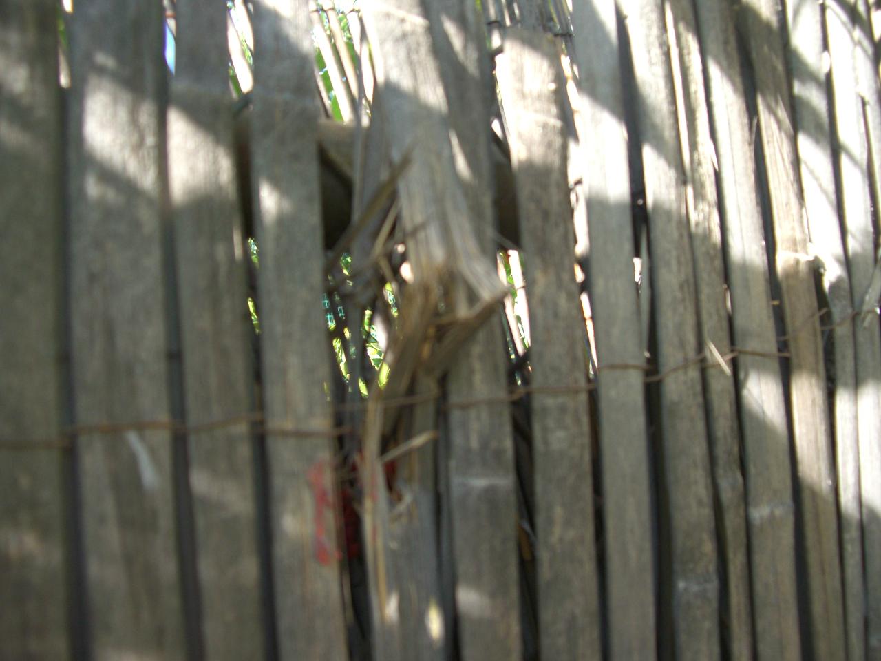

shot at 35 psi through my neigbors wall

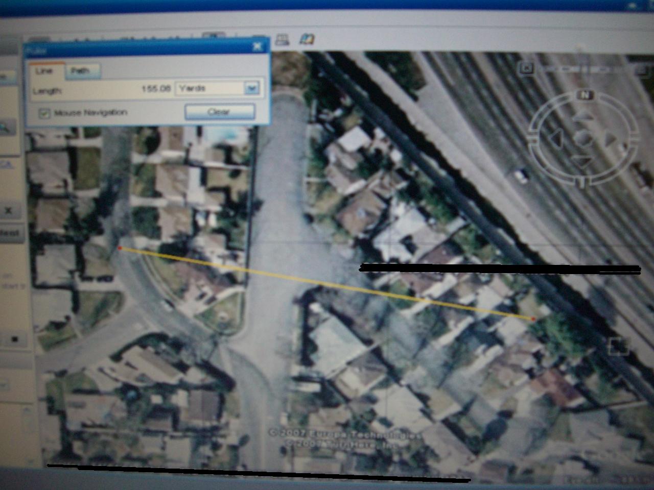

range at 65 psi with a rubber balls cant really see it well but its 150 yards

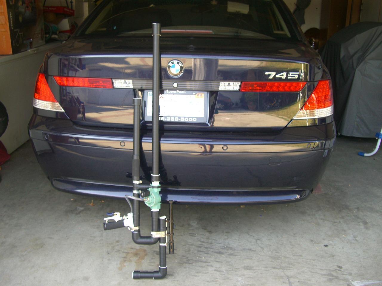

gun compared to my dads car

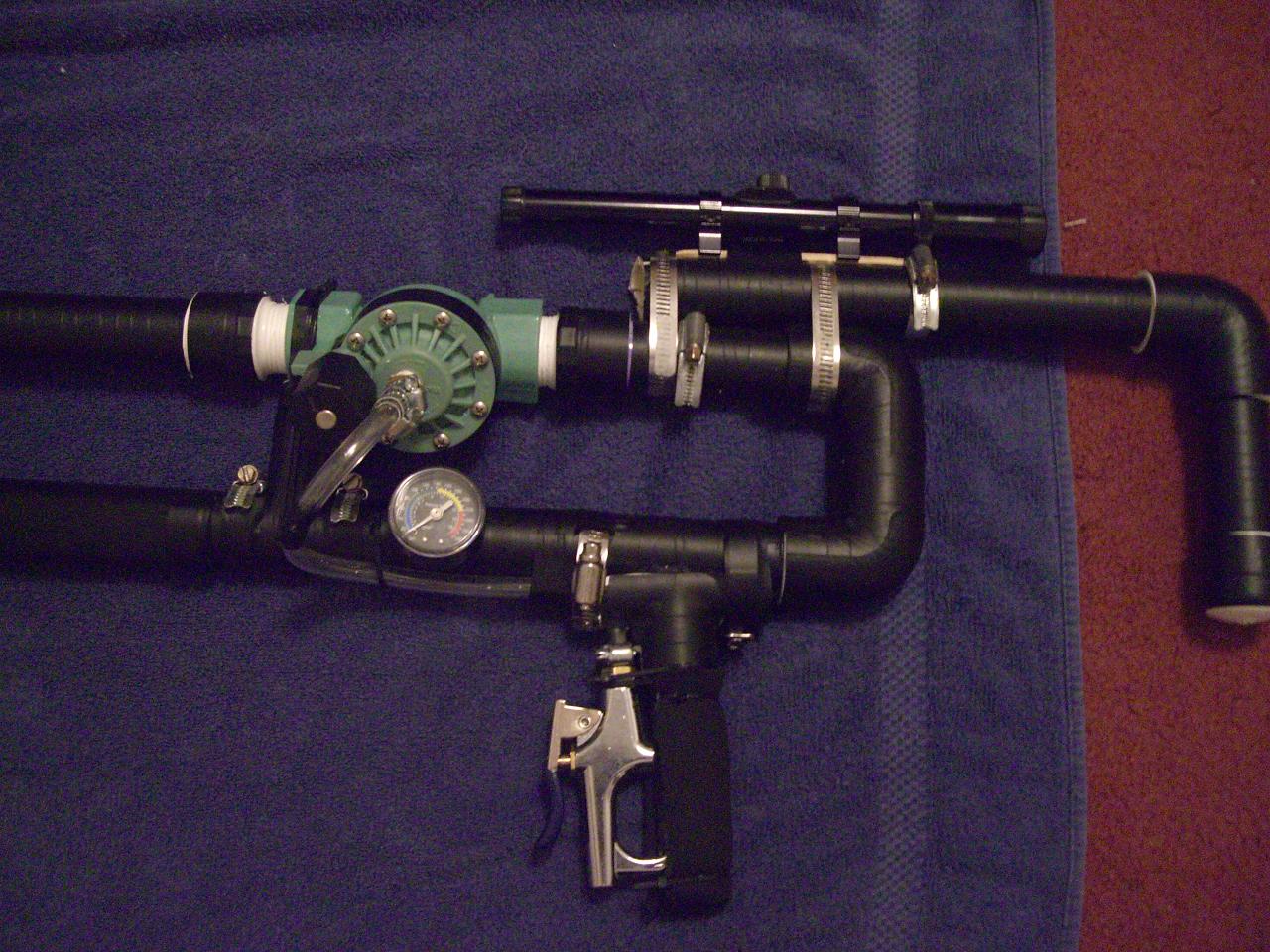

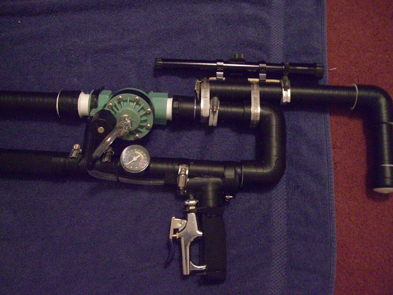

new gauge
new gauge

looks alright but i would have put a tee in instead of the 90degree elbow and fixed the stock into that, the stock would then give you more chamber volume aswell oh and i would also have mounted the blowgun inside the two elbows.... and make sure you get those damage pics up :twisted:

thats definetly a nice gun. that hose connecting the blow gun to the sprinkler valve is it pressure rated ? im only asking that as it looks a quite thick and doesn't appear to have those strand of metal or plastic in it to strengthen it. the last thing you want is your gun piloting when you don't want to.

wat isnt that bad to have ur stock as a tank it give dead space or sumthing das why i didnt do the tee thing
ALIHISGREAT
Posts: 1778
Location: UK
elitesniper wrote:wat isnt that bad to have ur stock as a tank it give dead space or sumthing das why i didnt do the tee thing
its only dead space if its not part of the tank... or if its not part of the tank and its not blocked off.
elitesniper
Posts: 1090
i mean like if the stock is the tank too it slows down the air flow?
elitesniper
Posts: 1090
can somebody tell the C:B ratio of my gun has cuase iono how to
the beast
Posts: 22
Joined: Wed Sep 12, 2007 9:00 pm
its really hard to tell the C:B ratio just by looking at it but the way i tell my C:B ratio is just pour water into the chamber until it is full and measure it then do the same to the barrel. then just simplify or divide or such till it is in simple forms. Example:Chamber=10.9 cups, Barell=9.8 Cups or 10.9:9.8 then just simplify to get your ratio. Hope this helps. :)

elitesniper wrote:i mean like if the stock is the tank too it slows down the air flow?
I haven't really tested it, but the ones I've built...well, I think this statement is just a little over-rated.
As far as the C:B, it is definitely less than a 1:1 but it is hard to tell as of now. What is the size / length of the chamber and the size / length of the barrel?
there both 1inch but the chamber is like 1 inch longer
elitesniper
Posts: 1090
wait less then 1:1 is bad? and btw the recoil of this thing is MASSIVE
Hubb
Posts: 2390
Location: South Georgia
1:1 on a pneumatic is not bad. It was just my prediction (seeing as how the chamber was shorter than the barrel).
As far as the power of a pneumatic, that all depends on the kind of pressure, type of air flow, etc. It is less effected by C:B.
As far as your launcher, it looks good and that was a pretty nifty way of adding the stock.
Oh, how long is the chamber and barrel?

barrel is 30 inches, the chamber is 39 inchs if u add the bends and everthing else behind the valve not the stock tho
